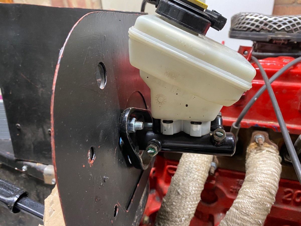

We have purchased Ka master cylinder with out servo
Please see photo I presume pipes nearest the steering wheel go to the rear wheels and the ones nearest the radiator go to the front wheels.   Also do the front wheel brake pipes need to both be the same length.
Yes 2 front for front brakes, length does not matter as whilst braking there is little fluid flow so presures the same at all ports.
The singleton goes to rear brakes. This way a fault leaves you with either both front brakes or (worse) with both rear brakes.
There is actually 2 pipes for the rear as well on this Ka block.
Come to think of it the Ka did a diagonal split. One front and the opposite rear on each circuit which would explain 4 ports on the master cylinder.
It is up to you if you do this rather than the more traditional front / rear split.
