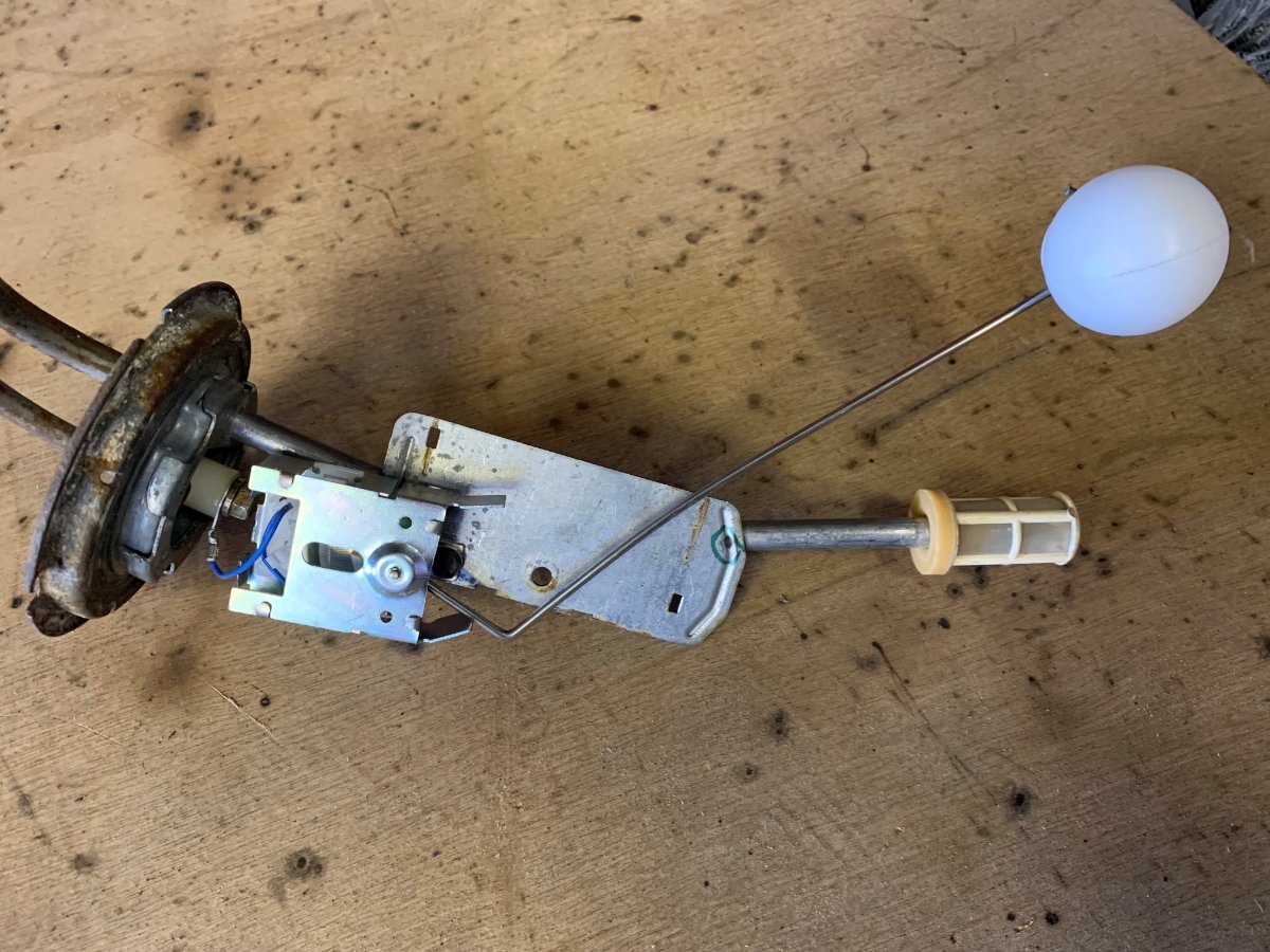

  11. I've finally found a solution to the Capri fuel level without spending the £200 that people want on eBay for an Escort estate sender. I've grafted an early Beetle sender onto the Sierra unit & it seems to work ok, so for just over £20 I'm happy

  14. Been reading through loads of posts on here & it seems the only way to get it right is to use a mk2 escort estate sender - found a nos one in Australia for about £230 on ebay so that's not an option. I guess it works within reason as it is so will worry about it at a later date.

    I’m sure this must have been covered at some point. I’m fitting Capri clocks & I’m struggling with the fuel gauge (Sierra sender) as in it only goes half way when it should show full has anyone done the same or know how to address the issue?
