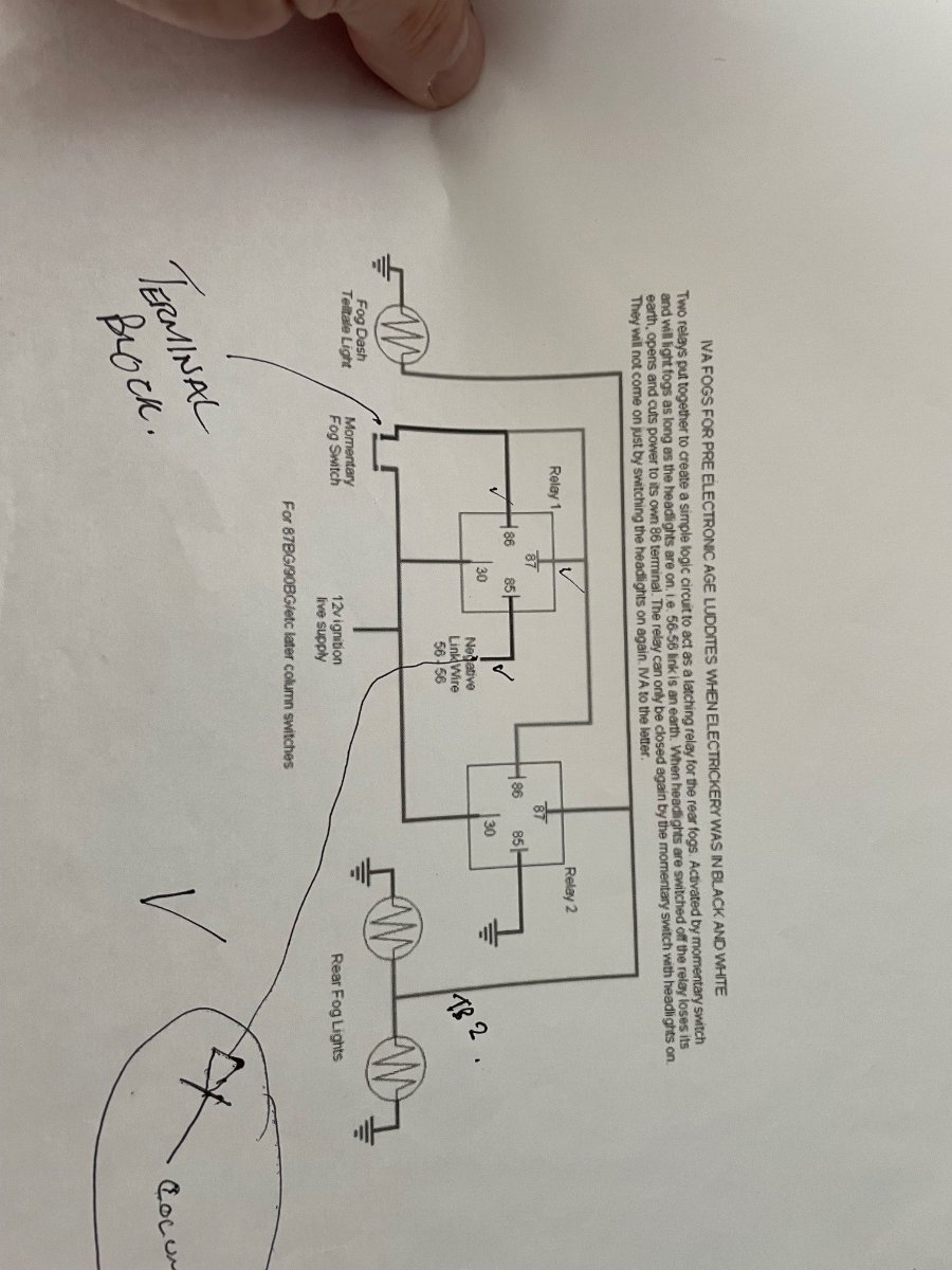

I did a iva in Sept 22 and the tester checked that they stayed off after ignition is switched back on an fogs only come on after reset car builder solutions do a relay to facilitate this for about 30 quid
  • 5 months later...
iv been trying to find out how the car builder solutions fog light control unit is operated ,ie is the fog light then switched on by a momentary switch or an on/off switch .if controlled by a momentary switch is it one press for on and one press for off ? if this doesn't happen how do you switch fogs off without switching headlights off and back on again .?or if its controlled by an on/off switch and you turn your lights on  then fogs on  ,then turn lights off when you put lights back on the fog light switch will still be in the on position so surely the fogs will come back on .
Its all automatic fog lights won't come back on after lights are turned off or ignition without operating fog light switch car builder solutions have a video on you tube
