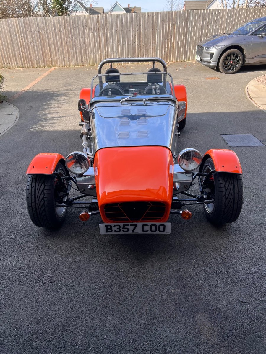

So after many months and a fair few quid my car is done ! Well nearly went for a drive today was absolutely awesome ! Pulled up at home turned ignition off it chugged a bit then like a 12 bore shot gun out the exhaust,
it has always done this since I bought it, I have replaced carb and set up on gas analyser timing is spot on thanks to RichyB all fuel lines and filters changed new k&N air filter new plugs leads cap and arms in fact it would be easier to list what hasn’t been changed
but still this running on issue !!! Any clues or advice greatly received

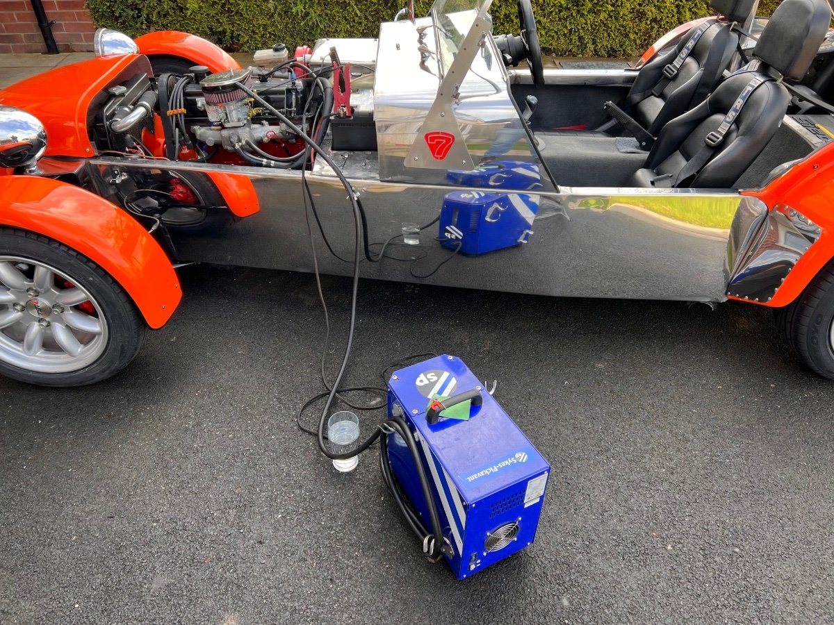

After some thought carbon build up and hot spot was most likely easily caused from previous running everything was out when I bought it and it has not had a decent long run for quite a while, decided to borrow a carbon clean machine from work ran  it on this for 30 minutes today once round the block ignition off and …….. no run on at all ! It seems to have solved it fingers crossed, going to fill up with decent fuel and take it for a proper drive in a couple of weeks.
