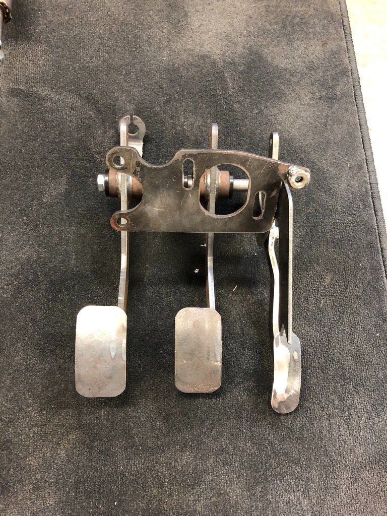

Good luck with the project. I can’t offer you any experience on the ST170 engine conversion but I guess you are already aware that it is a zetec derivative rather than a duratec, so the inlet/exhaust are on the opposite side to the pinto that was in your 2B originally.
Depending on the throttle body arrangement you may find that the inlet manifold area interferes with the existing Sierra pedal box / master cylinder arrangement. A number of people have gone down the route of a reversed top hung pedal box (available from GBS) or a floor mounted pedal box. I’ve done the latter for an MX5 engine conversion on my 2B due to inlet clearance.

Apologies - kitspares don’t seem to be advertising the pedal box kit on the website at the moment, but it might be worth giving them a ring. The kit was pretty basic and definitely required some imagination from the builder, but allowed hydraulic clutch and single brake master cylinders to face rearward behind top hung pedals. I mocked up this setup in my build but couldn’t get it to work comfortably with my steering column arrangement (Mazda).

I used a floor mounted pedal box but stuck with the cable operated clutch. 'If it aint broke dont fix it' Works fine!

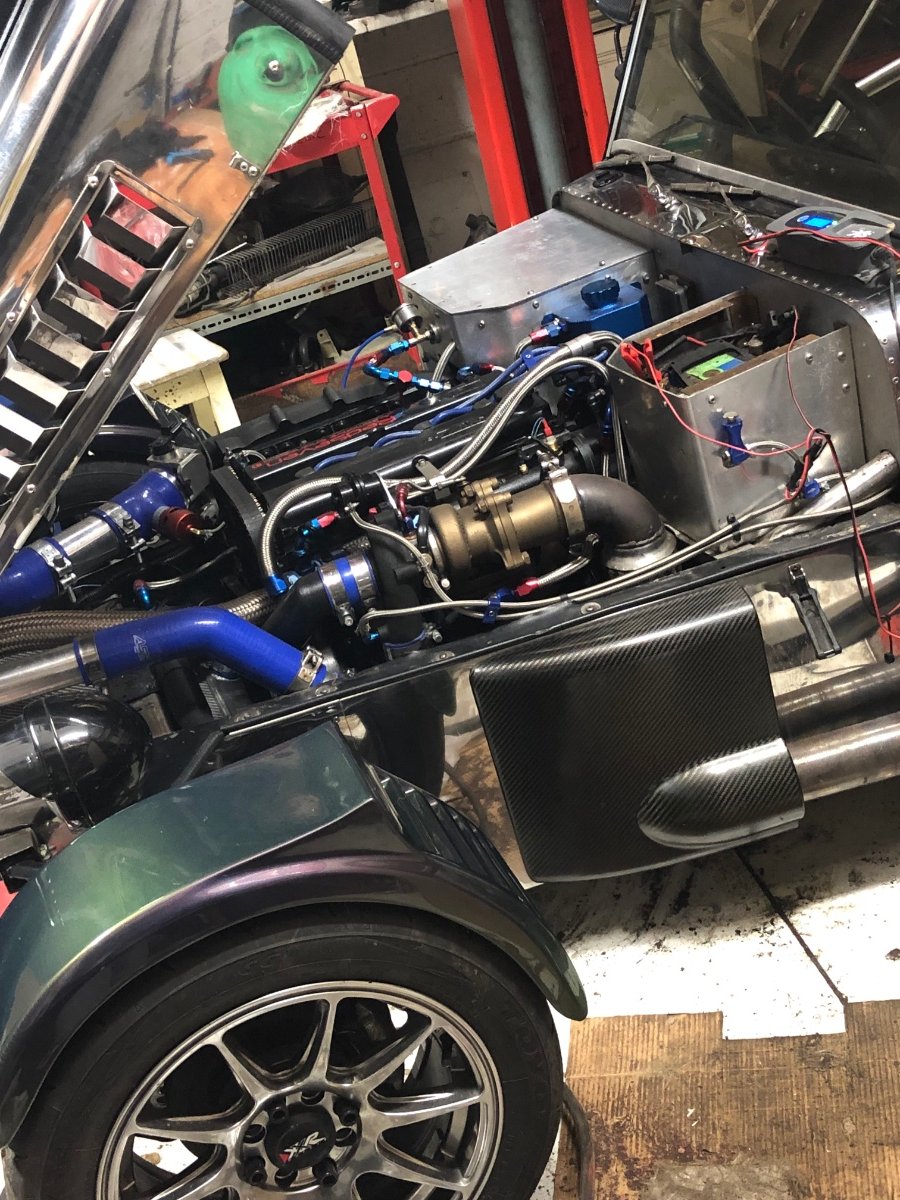

I did a budget turbo build to start with and got 240 bhp so it’s really easy and achievable and a hell of a lot cheaper than duratec
