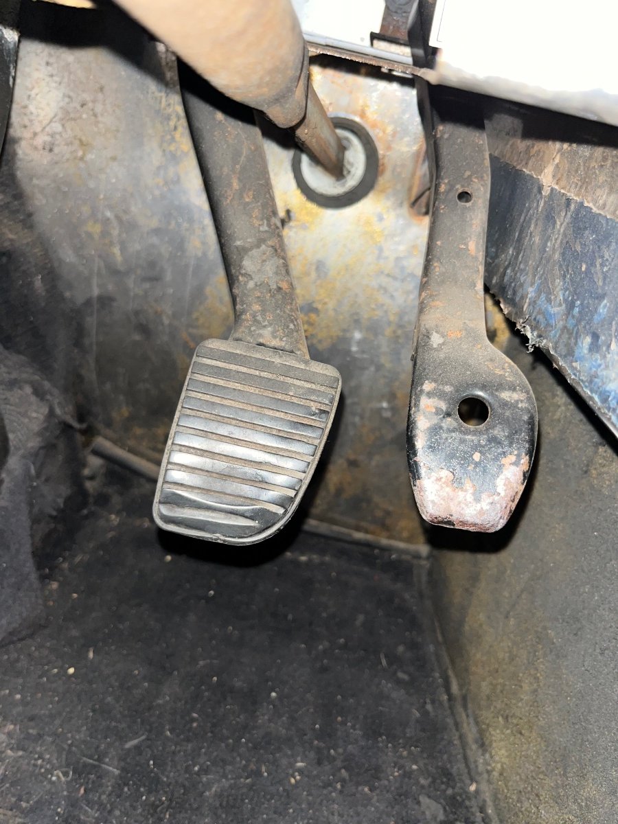

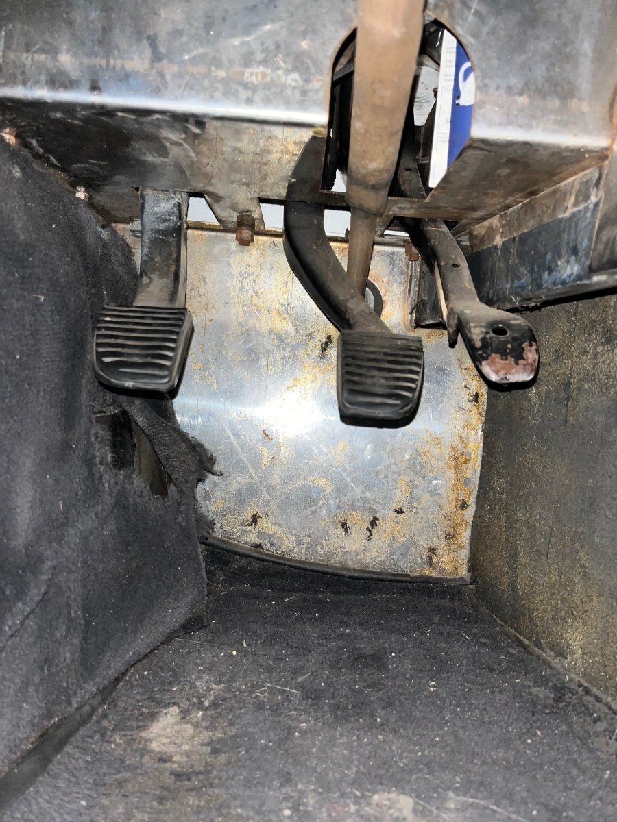

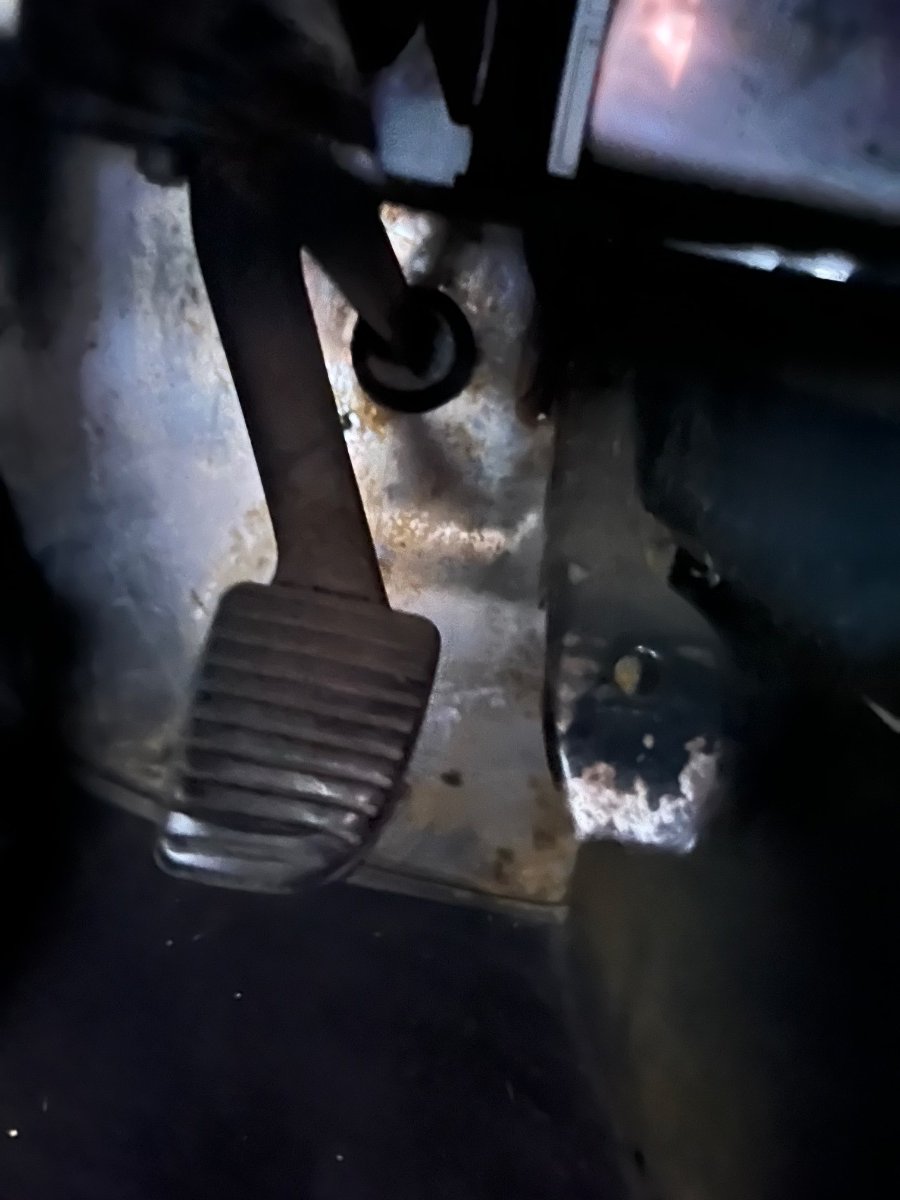

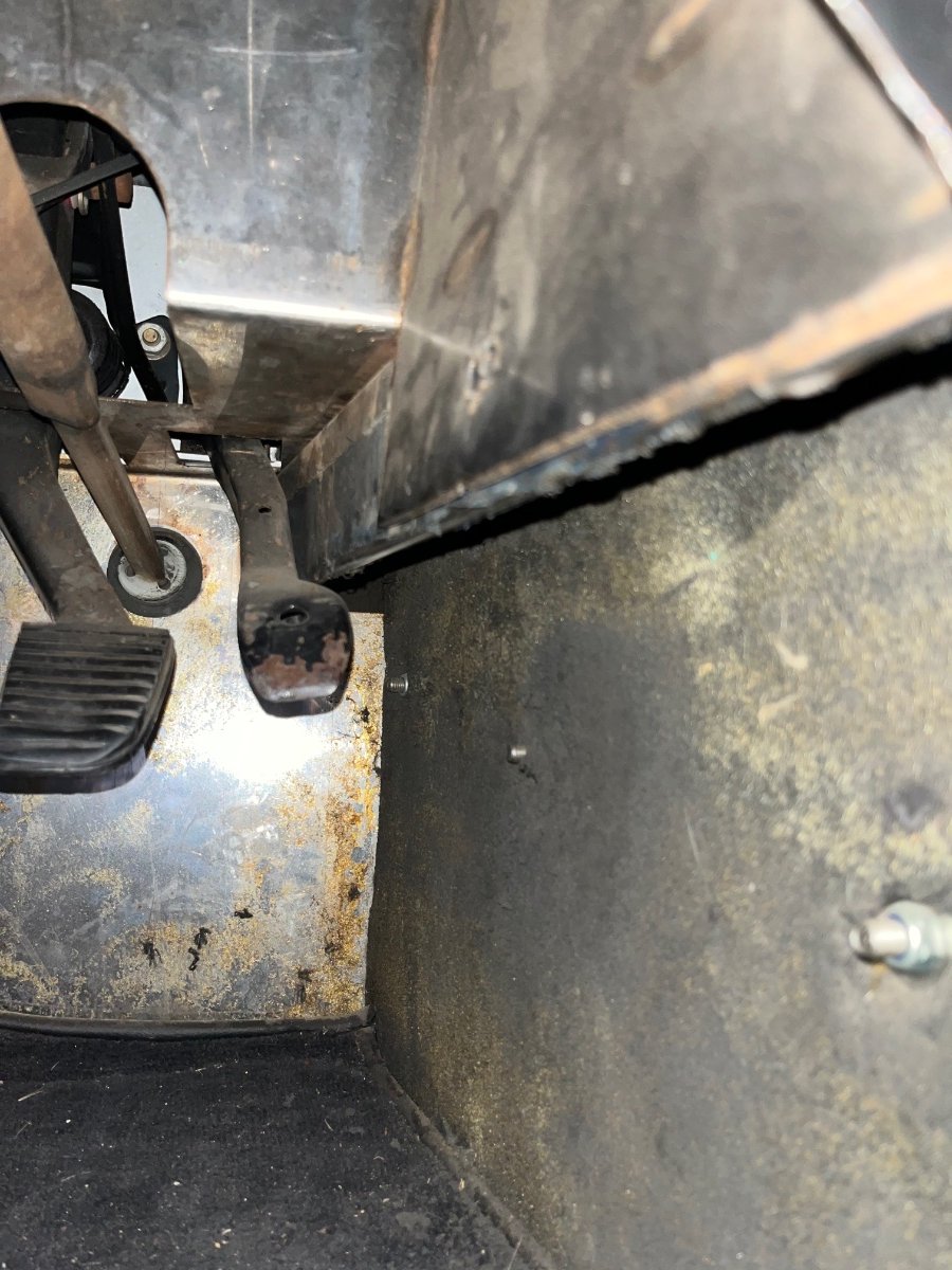

Another question popped up after picking up the car. Along with possibly raising the steering wheel / column height, I think there is potential for more legroom with a rework of the pedals. I think the builder hat quite narrow feet to be able to operate between the brake and throttle quickly and easily (see pictures)
i can certainly imagine that removing the dogleg in the brake pedal would help and also maybe shifting the throttle a few cms to the left (more evenly spaced)

Make sure theres nothing under the carpet. I had to fit 3/4 ply under mine to suit my dainty size 7s otherwise I was braking with my toes.
It may also be feasible to fit a lowered floor section where your heels rest.?
You can raise the steering column....but...it may interfere with the exhaust. Also the bearing in the footwell firewall can be replaced with a far better actual bearing that makes moving  the column easier. Try a search at the top of the page. I cant find the link. The column needs to be braced vertically and left to right. Do not brace it forward/backwards, its designed to collapse in an accident.
Moving the throttle pedal is pretty easy, but the brake pedal is more difficult. It may be possible to cut it and reweld it, but make sure its well reinforced.
I'm assuming it's a Sierra pedal box so the throttle pedal is separate and you should be able to remove the brake & clutch pedals as one lump.  You can the remove the pedals from the box and reshape them.  I modified mine by making V cuts in the side of the pedals, bending them to where I wanted them and then welding them back up.  I would recommend you buy another pedal box to modify, just in case it goes horribly wrong !  Also, as Bob says, the welding needs to be good and the cuts may need bracing - you need to make sure the brake pedal is at least as strong as it was.  The throttle pedal should be fairly easy to re-position.

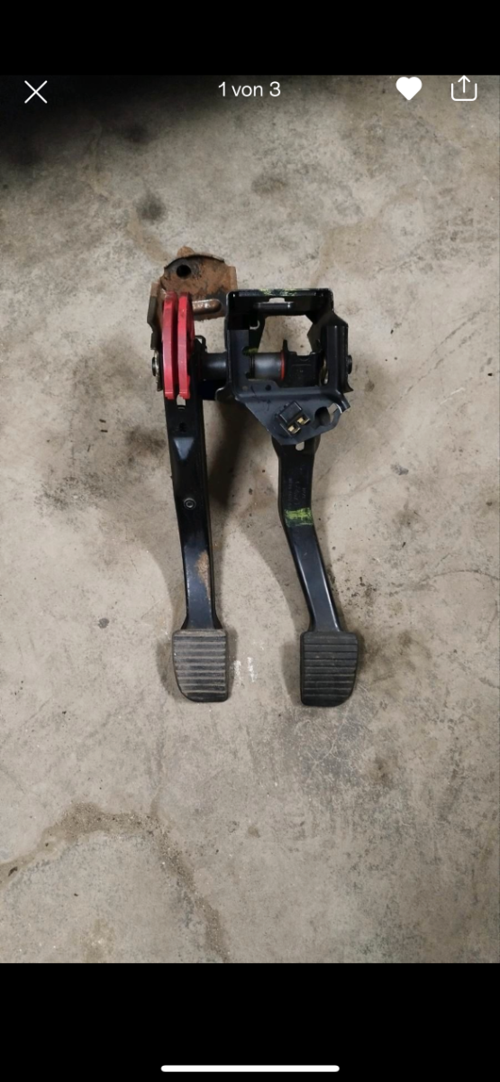

In case I go the welding route, I found a pedal box for a series 2 sierra on our German version of free ads (see pic) . The seller wants 60€ which seems a bit extortionate but it’s the only one on offer. The brake pedal looks a lot straighter than mine. Any idea if they are compatible at the pivot bar end and can just be swapped out?

Looking at this picture it looks like a standard pedal box to me and, as far as I'm aware, I think you'd be able to interchange pedals.  Your brake & clutch pedals do actually look further apart from one another than I think they should be as standard.  It may be my eyesight & memory that's questionable though !!!
Unfortunately I don't have a standard, unmodified one to measure for reference, but somebody might be able to help with some measurements.

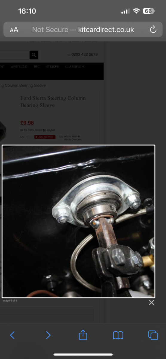

Hi Bob. Apologies for the late reply. I checked the link and the bush appears to have a normal circular cross section but looking at my pics, the steering column appears to have a triangular cross section. Or am I missing something?

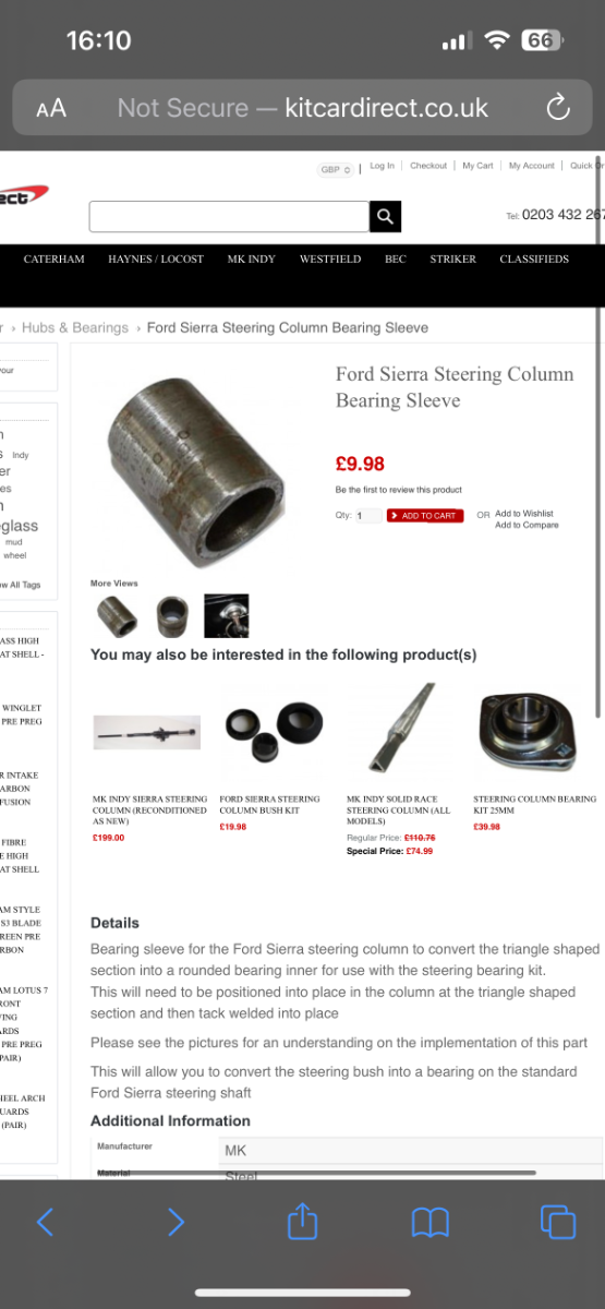

Just had a look at the Kitcar spares website again and there’s an adapter that I need as well which converts the triangle cross section to the circular cross section (pictures below). Just needs to be tack welded on apparently.

You should be able to take the plastic centre of the original column bush and use it in the new bearing - effectively converting the triangular shaft to round.   Have a look at this -
https://nw.rhocar.org/buildtips/steeringshaft.htm
Now that is an awesome idea. Cheers mate. And the bearing is quite a common part. I searched for the part number from the link you sent and got a stack of suggestions here in Germany. Exactly the same bearing for 10€. Will be getting that asap. Cheers for the heads up 👍
Bit late to this topic.... I attach a couple of snaps from my car. The second is the standard pedals, to see the standard spacing, yours look to have an offset brake pedal, but that could be perspective. The first is from above with the pedals installed. You see that the throttle is seperate, not installed, so could be moved easily in all directions. What is not easy is changing the height or spacing of the clutch/brake pedals. The clutch quadrant position is fixed by the release mechanism in the cable guide, and the brake pedal top by the alignment of the master cylinder rod. Moving the whole assembly up is theoretically possible, with spacers, but the whole top cover (not shown) would need to be raised, all the brake pipes extended, and then not so high as for the servo or fluid reservoir to hit the bonnet. Lowering the floor and/or altering the pedals is going to be easier, although shortening pedals will of course alter the leverage and range of motion somewhat, e.g. shorter clutch pedal would be harder to release smoothly.

Thanks for the pics and explanation. Like you said, my brake pedal appears to have a massive dogleg in it. I’ve got a second unit where the brake pedal looks a lot straighter. Might just try and swap it out to begin with to see how much that helps. I think the builder did it to heel and toe a bit easier. Let’s see. There also seems to be a board that’s been inserted which raised the floor somewhat. That’s coming out as well 😅 if all that fails then I’ll see if I can gain a few centimeters with the position of the pedal box. Final fix will be to chop the footpads of the pedals, open them up slightly and re-weld them a few cms higher up. All the fixes in combination should sort the issue. Also getting rid of the manky carpet as that appears to be about a Meter think 😅 I’ll update when done. Cheers again
Just a bit of advice from experience, the two bolts that connect with the servo are not the intended load bearing points. If you only use these the metal will flex and will crack, mine did on my old S7. The hole on top that's elongated is the load bearing attachment in the Sierra, you can see there is more metal here. In my 2B I created a triangle bracket bolted on the top and to the front mounting plate and also braced it back to the chassis.
I would also advise not to cut and well the pedal, it's made from very hard steel and designed to take a lot of force. Any weld would create a weak point.
