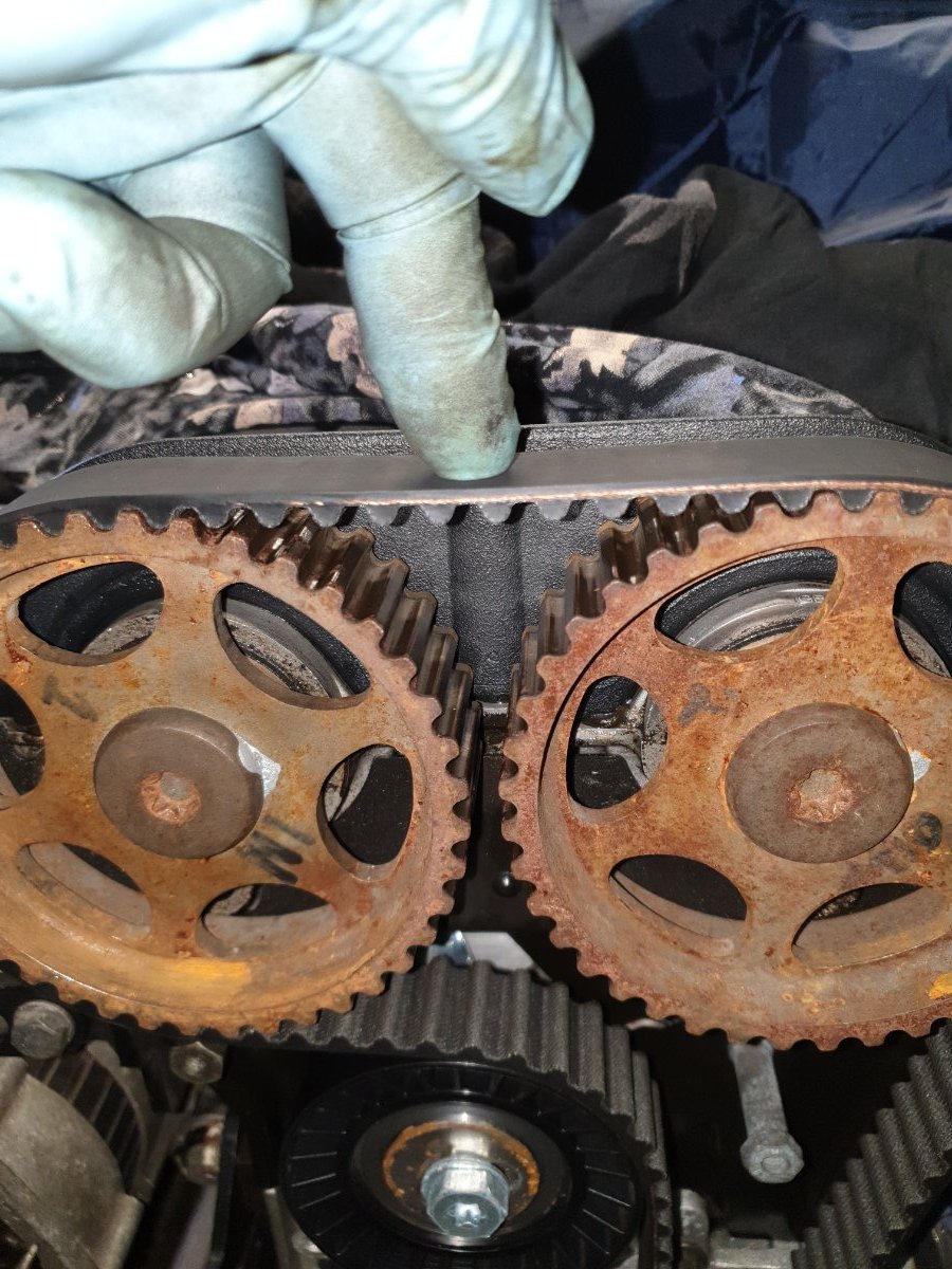

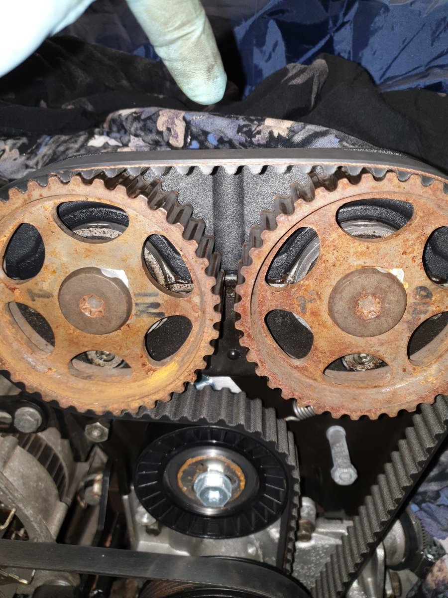

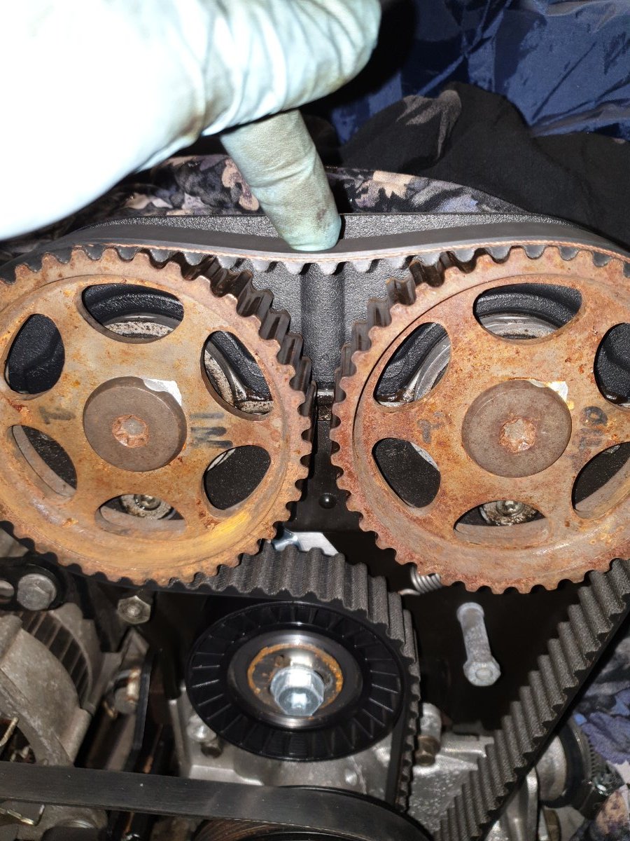

Right this is really confusing me did the timing belt on my tiger Avon about 6 months ago ran the car a few times no problem what is confusing me is the slack on the timing belt. When I turn the engine over by hand there is a difference in the slack between to cam gears. When it feels like a compression stroke the belt is nice and tight as soon as it gets past that the slack between the cam gears is about 15mm just doesn't look right?

Should be correct then. The real test would be whether you can get the locking tool back in but personally I wouldn't worry about a bit of slack between the cams when it's not running. Any slack soon disappears once the belt is moving.
