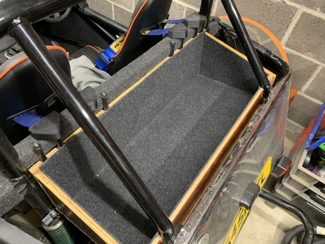

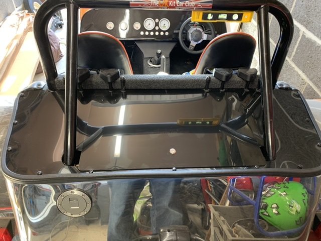

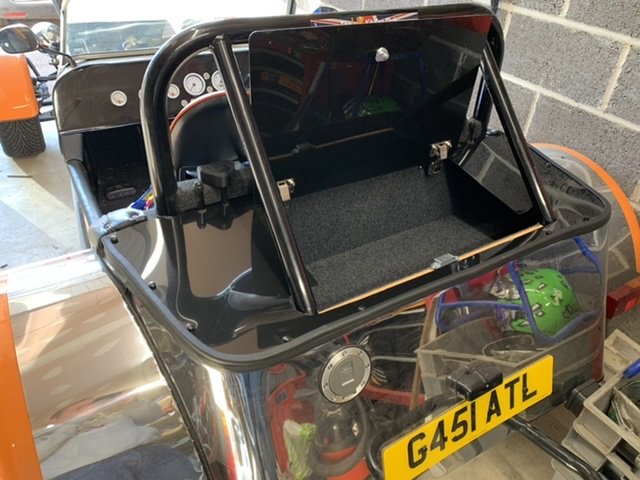

With the current situation I’ve finally had some time in the garage and managing to get some little jobs done on the kit.
For a while now I’ve been meaning to make a boot to store the odd little thing in when out and about and meaning I could use the car for the essential shopping ( I wish ).
Almost there now just some trim to finish around the roll bar. Also knocked up a coolant recovery tank today and fitted that.
what jobs have everyone else finally got around to doing?
