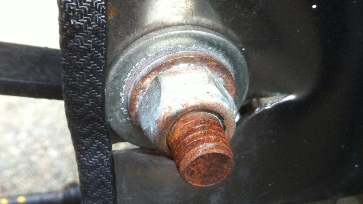

Guys I know this has been spoken about lots of times and I have the usual chassis stress/cracking places on the front that seem so widely known about but what concerns me if it's cracking where I CAN see it where is it cracking where I CANT !!!!
Has anyone come across any other places where the mono splits??
I can easily weld some plates /strengthen the chassis if I know where to look ?

Hi I also have a mk3 mono and I've not had this problem ????? But it seems this is deff something I need to look into .
Maybe I've just been lucky and it's not happened yet. So do I just fit a flat bar across front to prevent this starting ???

Anyone else had this (see pic).
I'm running 80lb front springs and tie bars.
That happened the weekend. And me and the other half were only cruising as the weather really was not the best. Noticed it while parking it back in garage !!!!
