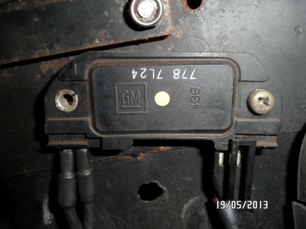

no not replaced rotor arm, completely forgot about it, just been to get one, had to order it, pick it up tommorrow, battery is on charge will put in new rotor arm and give that a try, if that doesn't work then i'll try dizzy or module, will try and put a pic of the module on here, ivan
