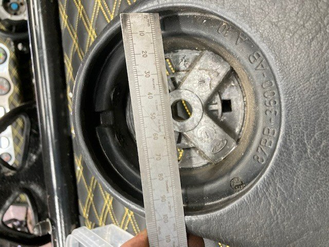

  24. Does anyone have a Sierra horn pad for sale to fit the steering wheel in the photo? Thanks
