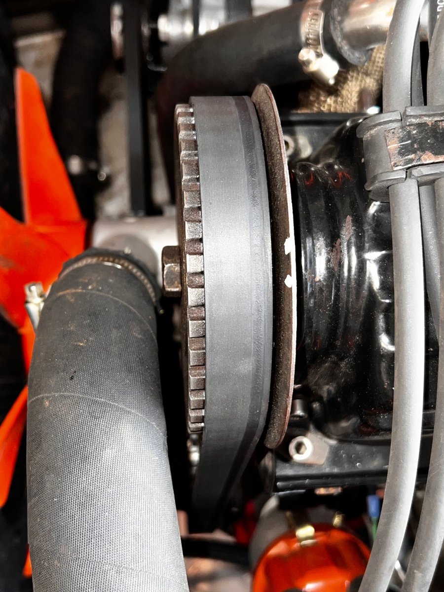

  1. Rattle only when revved, I understand its not the belt making the noise but wondered if I have play in a pully that could be the reason the belt is not sitting right. However IanS has put my mind at rest that this is normal I just need to find what is making the rattle. Ps I have noticed the fuel hose close to belt and put on my ever increasing list of jobs to do this weekend ! WELL SPOTTED IAN !
  2. After lots more fettling we are getting close to sorting issues mentioned previously, however tonight I had it running and heard a rattle (metallic) from the front of engine unable to locate although I did find some play in water pump that I will replace I noticed cam belt on top pulley sat back but on the pulley bottom left sits forward ? Is this a major concern or some what normal ? Belt was replaced 2 weeks ago ! Is this a sign of play in one of the pulleys that could be the noise I can hear ?
