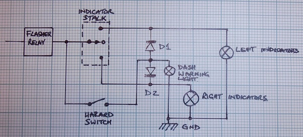

Here you go here is how to do it. The two diodes back to back will not allow current to pass when using left and right indicators. However, one the Hazard switch is closed both diodes will conduct driving both left and right and the warning lamp at the same time. Hope that helps Nige
Hi Plugy, You will need a couple of diodes to do this. I will draw diagram tonight when I get home, as I have no way to get it posted up wher I am at the moment. Nige

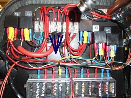

Here is another one showing more detail around the fuse boxes and the cable splitting into four Nige

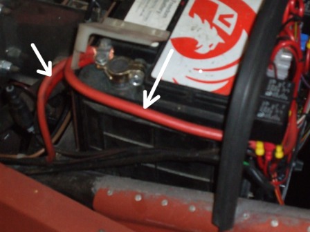

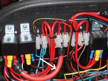

Pictures as promised... The first picture shows two arrows. The left one shows the original starter and charge wire and the right arrow shows the big fat jump lead I used. Nige
The way I did it was to get a length of Jump lead, (which when all the strands are twisted together is too fat to fit into most connectors) and split it into four twisted strands at one end and these then fed into a 10 way 30A choc block. I could then take the other side of the choc block to the fuse box and also extend the number of connections. I will try and post a picture tonight.. Nige
