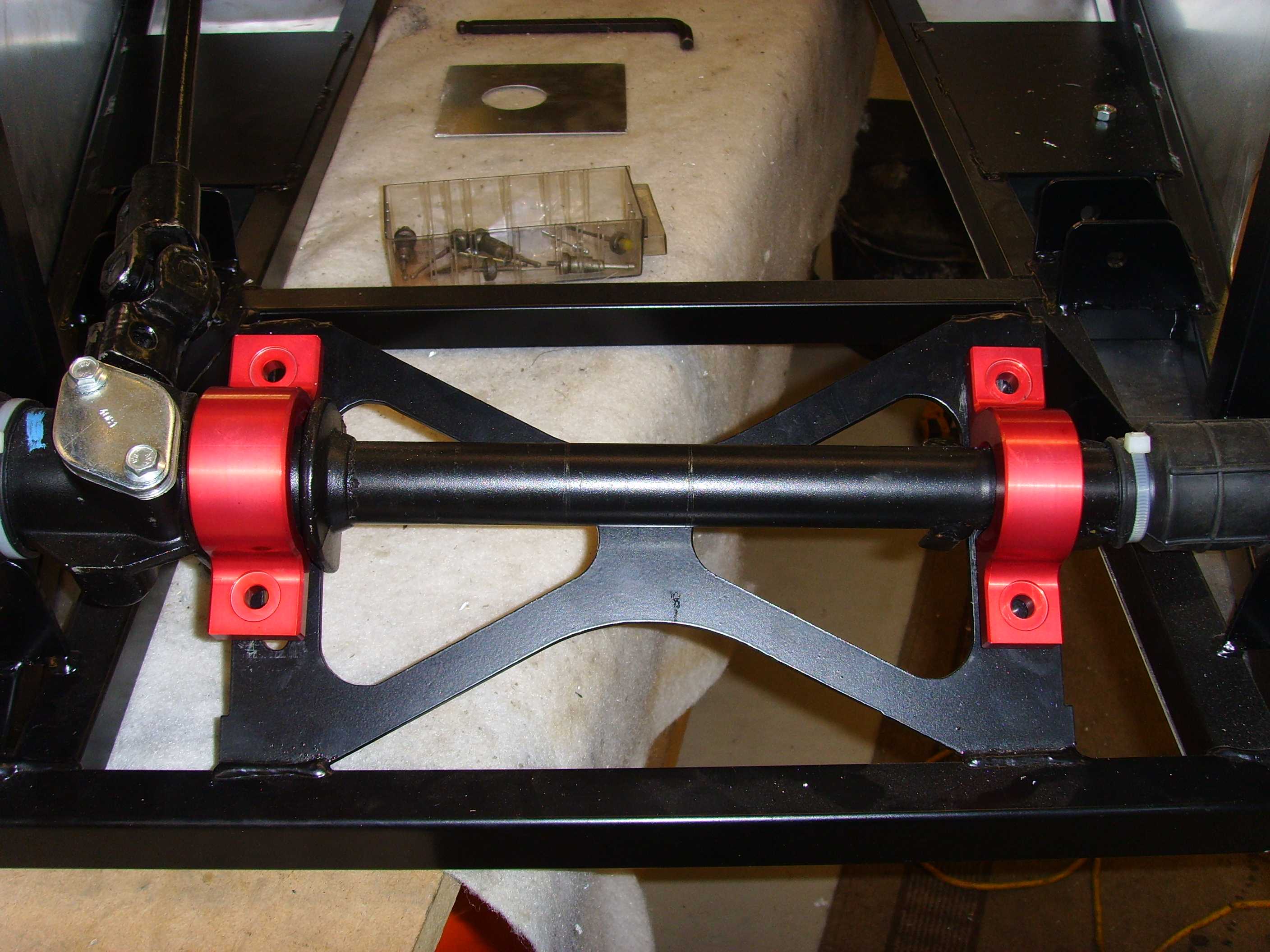

  24. Hi Larry, Many thanks for your very prompt service, as you say, they certainly look the Mutt's Nutt's. Pic enclosed of them resting in place ready to fit. Thanks again, Nick.
