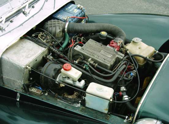

  13. Thanks for the advice. I'n nearly 100 % sure there is an old lucas volt reg fitted but I'll get the multimeter out and check. Gauge seems to work fine. It reads cold when cold and creeps up to 3 quarters then hovers a bit, then creeps a bit more. As i've said don't know yet if gauge is spot on and temp is getting too high. but seems to read just over 3 quarters at 91 degrees, which I would think is about OK as that is when temp switch kicks in. If it is just running "warm" I'll do some more investigation. Might be thermostat not opening fully, which I belive is supposed to be at about 83 degrees. If car runs fine and doesn't overheat I'll try different sender. Offer of white top sender to try appreciated Barry. I'll prob take you up on that, but away this weekend. Be in touch. Thanks for the support Lee
  14. Any advice appreciated here. I have a Dolomite temp gauge fitted mated to a sierra temp sender. This is how I bought car. Gauge was reading nearly off the scale, so I thought I would improve matters by fitting RH Coolman radiator (thought It couldn't do any harm and must be more efficient than the single core rad fitted). Temp gauge still reads off scale So I guess sender not matched to gauge. Starts to kick out water from Coolman overflow pipe just as guage goes right off scale and no fan operating. I now have 91 degree temp switch installed in top hose which is now kicking in fan automatically and I have removed viscous fan from lump. Anyone suggest lower temperature switch? I have not had too much time to test or tinker so see if it stays cool, but is there any way that voltage from sender can be reduced or Dolomite temp guage can be calibrated to show mid point or just above when fan kicks in at 91 degrees. ( Assuming that it's staying cool) Do Ford make any other temp senders or can a resistor be installed from sender to gauge? Cheers Lee
