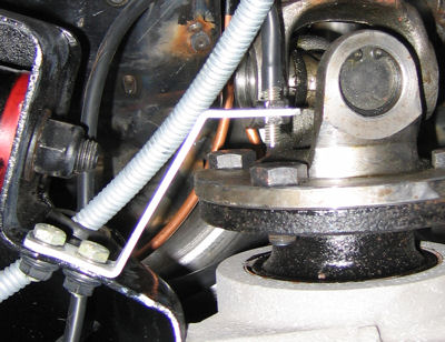

  7. Hi I aryldited mags to the top of two propshaft bolts (not in the picture) and made an Ali bracket for the sensor. I did end up doubling the thickness of the bracket to stop it wobbling slightly. e
