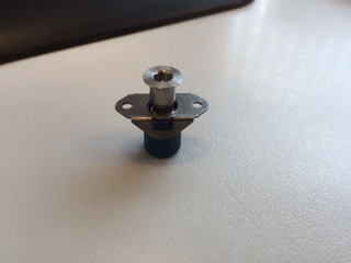

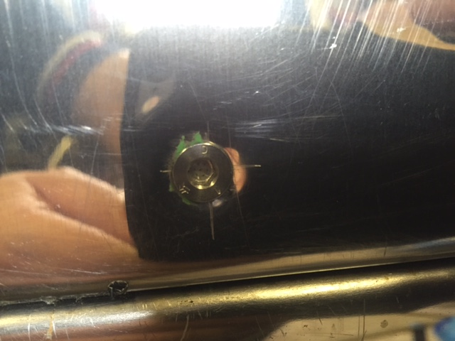

Dzus fasteners fitted, much neater than ugly iva rubber straps
They look great - will they be IVA compliant though?
Reading the iva manual I cant see anything other than the 100mm ball test & as these are flush it shouldn't be an issue.
Somebody please correct me if I'm wrong?
What do they coonect to on the inside? Can you post some internal pics?
I'll try & get some photos tomorrow.
