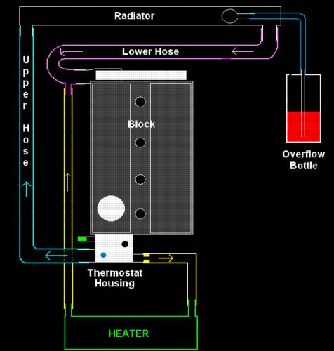

Can you draw up a schematic showing the pipes, connections, radiator, block of your system. Also roughly measure your radiator matrix dimensions and thickness?
Here's mine. Radiator size not shown but it is four row. I use the standard ford mondeo thermostat. I have a heater but without one the yellow pipes just link rather than go through the heater rad.
