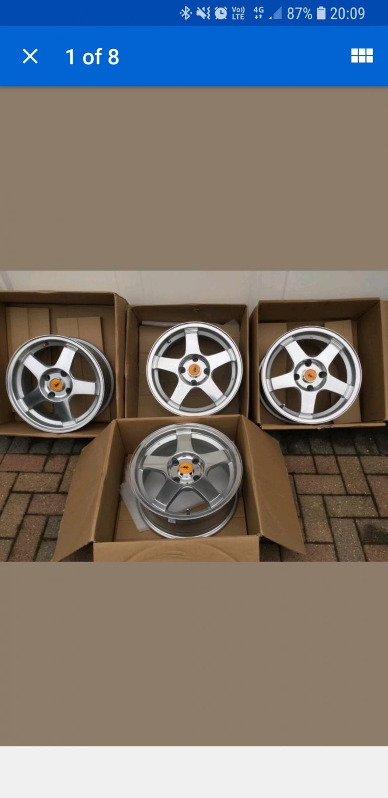

i'm picking up a set of 15x6.5jj alloys on sunday, original 5 spoke hood wheels by wolfrace.

The 6.5J might limit your choice. Are you sure they are Wolfrace not Array

not sure if they are wolfrace or array, im going off what the seller has told me. they do have yellow robin hood wheel centers though.

These are the wheels.
