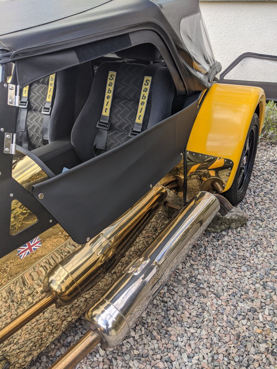

Also what's people's thoughts on using strong Neodymium magnets to hold the bottom of the half doors (thinking of just a vinyl piece of fabric with bar across top ) to the stainless panel as don't fancy putting press studs on the gold bodywork, the top of the door will be secured with the studs already there for the full doors.

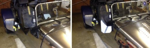

Fitting wind deflectors was the best thing I ever did.   Ever since then I have not used the doors except when I am leaving the car out overnight when rain is forecast.   When I had both doors and top fitted I found it very claustrophobic, noisy and with very limited visibility.   Without the doors the environment is transformed and no different to driving without the top.  Obviously if the rain is horizontal you will get wet, but so far that has not happened to me.
It took 2 attempts, as you can see from the picture the first ones did not go down far enough and the wind still came into the cockpit.   So I made some longer ones.  I haven't bothered to shape them to fit the car profile, but probably should have done.
I just mounted them on the same hinges as the doors, using scrap pieces of stainless steel.  In that way I can still put the doors on when required.

Thanks Alan, meant to get some photos of yours at stoneligh, I took photos of the ones Andy made but forgot yours.

My doors stretch all the way back to the rollbar and I have a couple of neodymium magnets to hold them against the rollbar and it works pretty well BUT then the natural airflow pushes them against the rollbar anyway, so they really just help with cross-winds. I think you'd need quite a few of them if you want to use them on a half-door and be aware they may mark the panel over time because they will move more than if you just used poppers.
