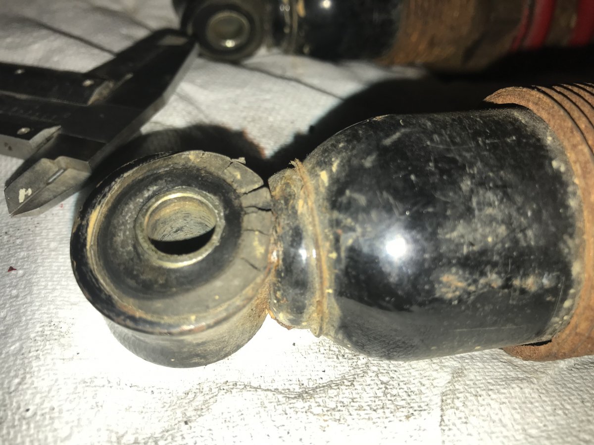

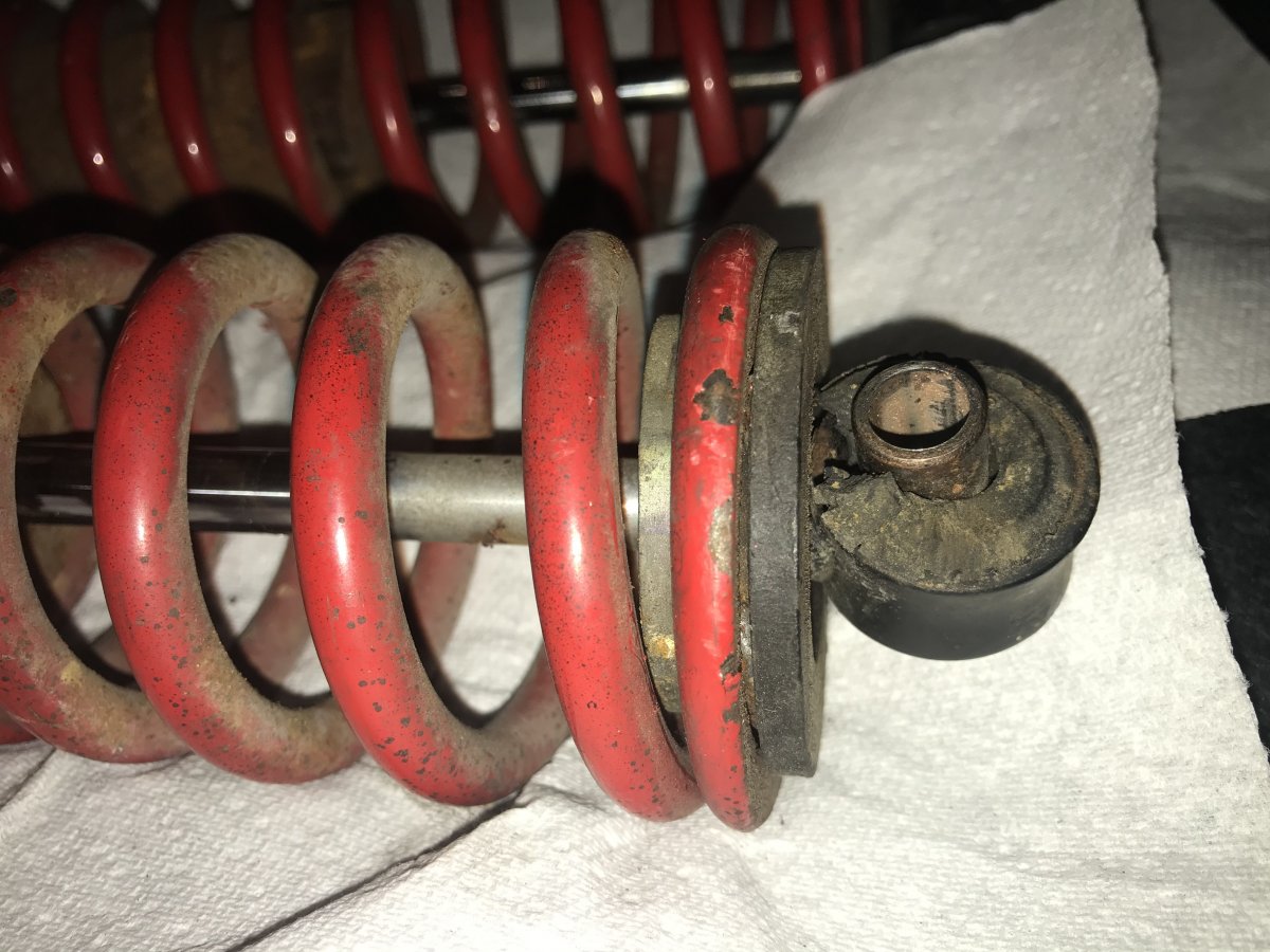

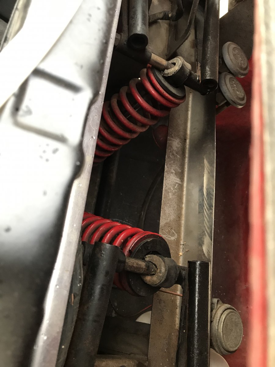

In light of the quarantine, I am taking this as an opportunity to do a few bits of overhauling on my Robin Hood SF Mk 2. I am currently working on the front suspension, which if anyone is familiar with the mark 2, the coilovers are inboard rather than external (see my attached pictures). The top eye bushings have very much seen better days and having removed the coilovers today, the bottom eye bushings aren’t far behind, and generally looking at the condition of the rest of both shocks, I’m thinking that I might splash out and treat my RH to a new set of front coilovers, particularly as the shocks that I’ve just removed have no easy damper adjustment facility like all the modern shocks seem to have.

I’m generally armed and ready with my measurements for the shocks. My one concern is the open height. Protech request that you take the open height measurement from the centre of the top eye hole to the centre of the bottom eye hole. As you will see in my photos, my bushings are absolutely clapped out and the best I could do for a measurement was to take it from where I thought centre was originally at each end and the closest measurement I could deduce that is available for ordering was 13”. However, there is a 12.5” option available which does seem too short, but I notice that the bushing tear pattern on the old shocks suggests that the shocks installed originally might be too long for the design of the mark 2. Would this make sense? And  would it be prudent therefore to go for 12.5” open length? The only time the shocks would ordinarily be in full open length would be when all four wheels are off the ground, which I endeavour to keep as only being the case when I jack the car up!! Thoughts on whether I should go for a shorter reach would be much appreciated.

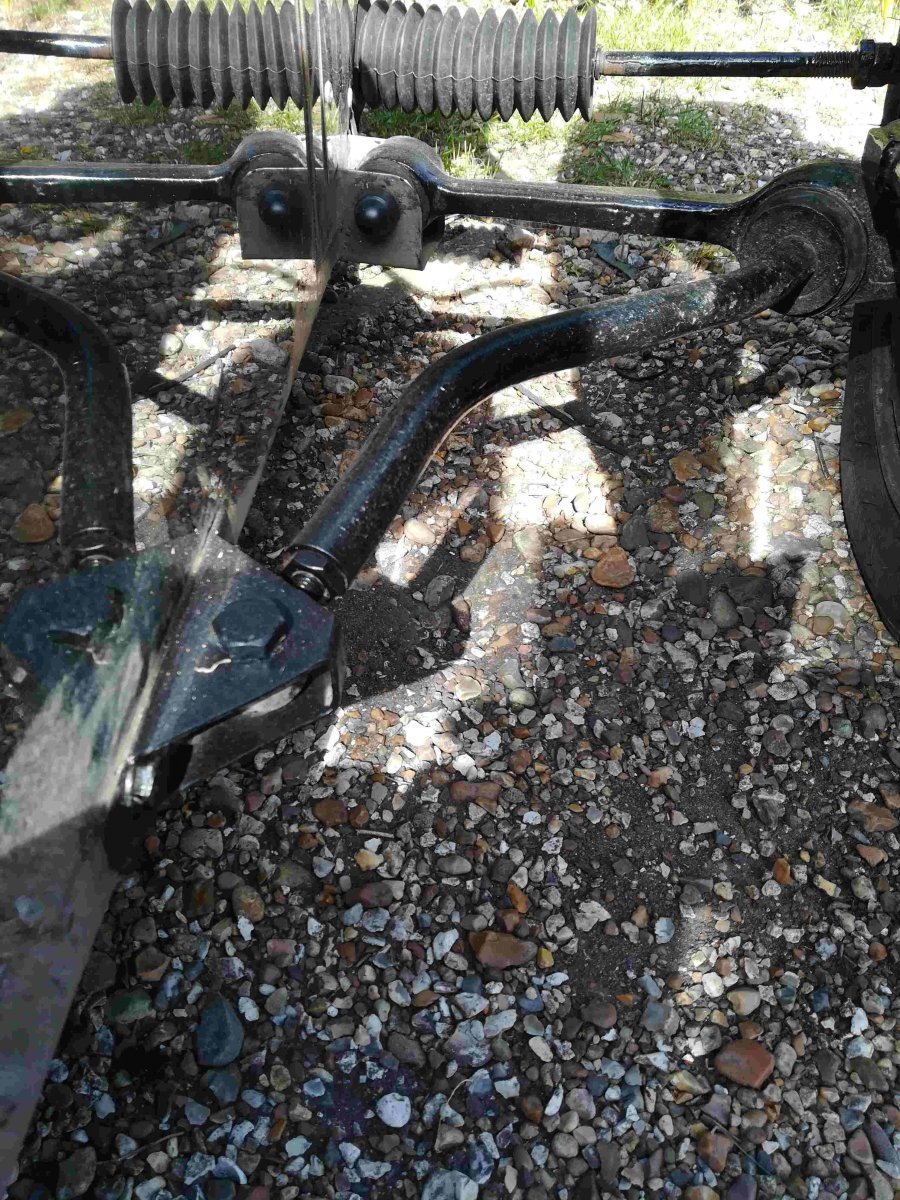

Hi. I had to pay a lical metal worshop to drill and thread the old antiroll bar. The brackets I fashioned from box section and used rose bearings to join. Make sure you use some angle iron inside the panel to strengthen where the brackets are attached. There are some drawings in the Dave Andrews link if you look for the link to front suspension info towards the bottom of the page. Here is a pic of what i ended up with. I'm no great mechanic. All done with an angle grinder!

Ah! Brilliant. This is what I need. Thanks! The current setup of the original anti roll bar is horrendous; this is bound to be an improvement! I like the fact that you were able to salvage the original bar for the tie bar conversion.
Much easier than starting from scratch. It seems to be quite a common method.
You may find depending on the position of your engine mounts that they are just where you need to drill through for the brackets. I just got away with mine and in fact used the mounts to sandwich the inner angle iron which gives further support. All depends where your mounts are. There will be a way round it.
All good to know! You don’t happen to remember what size of box section you used to fabricate that do you? Also, do you remember the bolt sizes for the rose joint eye? And what bolt sizes did you use to mount the box section to the chassis? Angle iron is easy enough size up as it presumably only needs to be big enough to receive the bolts and bolt down to whatever is on the other side (I need to have a look at what’s going on internally), and of course it needs to have enough depth to be of sufficient Reinforcement. I like this tie bar conversion as it effectively converts the track control arm into a lower wishbone.
I'm pretty sure the rose joint eye was m12. I used m8 to bolt the bracket. The box section was 2" x 1" . 2mm thick. I haven't done a huge mileage yet but it all seems solid without distorting.
