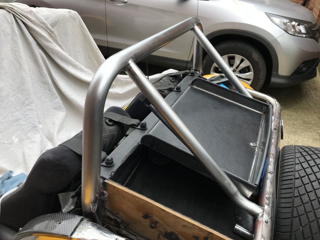

Ditto Richy. The paint on my roll bar was always chipping and flaking and looked a mess so I removed it all 2 years ago. Used a flapwheel in an angle grinder then finished off with satin wheels and scotchbrite pads to give a nice brushed finish. I've only had to go over it lightly once since to remove odd rust spots with a pad.
Hmm so painting not such a good idea, it  was already painted when I bought it so I've just been patching it up.
