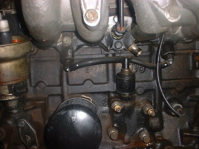

I can see in my 2 ltr pinto there is a sensor unconnected on the carb side toward the right (furthest from crank pulley). Is this an oil temperature or pressure sensor or something completely different? Couldn’t find it in the Haynes manual.
The one to the left with the treaded end is the oil pressure sensor and the bit that it looks like the finger is pointing at is the pcv valve I think from memory.

Here's a better picture the correct way round.
Too the right of the oil filter is the PCV Valve above that is the manifold water temp sensor.
Too the right of the engine mounting is the oil pressure switch.
Hope that helps you.
You will find the water temp gauge sensor above the distributor area in the picture.

Thank you. I’ve had my water temp connected up for some time, and like you say, on mine it’s above the dizzy.
So just to be sure, is it an oil pressure switch or gauge to the right? As in, should I wire a warning light or gauge to it?

Hi to answer your question the oil pressure switch is shown, and would be wired to the dash warning light marked oil. that lights when you have NO OIL Pressure, when you switch on the ignition and should go out when the engine is started.
If you want to fit an oil pressure gauge then you need a Tee piece for the pipe or sender unit to fit.
