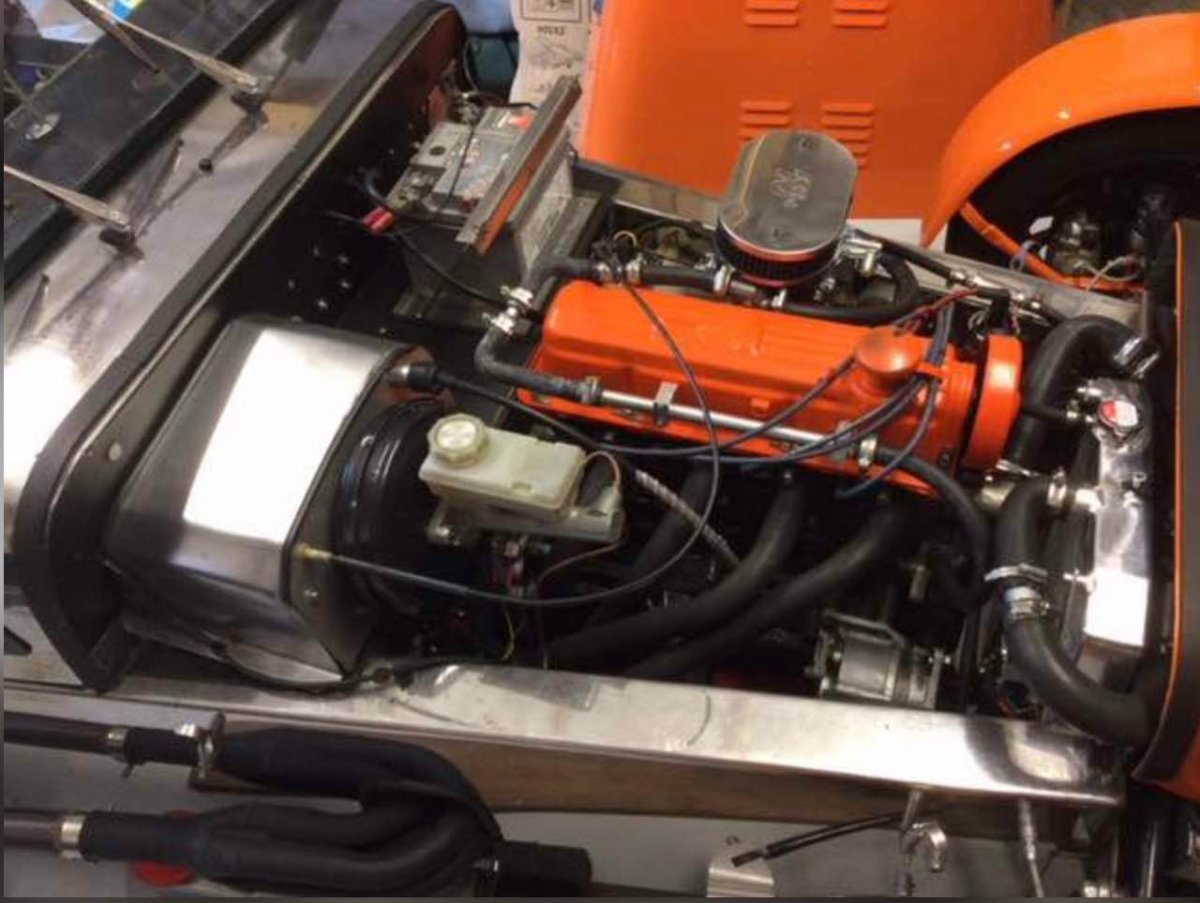

 - Looks like the electric fan (see photos ) is far too small.  It's only 6" diameter can't be much use.  How big should this be?
 - What happens if polarity is reversed and the fan isn't pulling air through (haven't checked this yet)
 - There is no expansion tank that I can find.  This surely must limit the thermal capacity of the coolant
Installing a larger fan seems problematic as there is 1.25" clearance to the front of the crank pulley.  Any advice on fault-finding on a workable solution would be very much appreciated

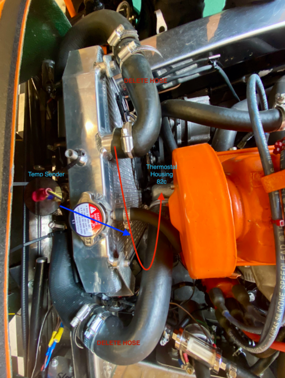

Looking at those pics the pipe run appears a bit convoluted.
Do I see right the hose from the thermostat housing is going to the bottom of the radiator and the hose from the top of the radiator going round the front of the rad and presumably to the engine bottom connection.
This would put the radiator into reverse flow with all the flow stagnation problems this gives in the radiator.
Normally you would run the thermostat outlet into the top of the radiator to work with thermocycle of the coolant rather than against it.
With this run i would expect it to be hard to bleed all the air from the system.
With the lack of room is it possible to mount a fan in front of tha radiator pushing air into the radiator?
Thanks Ian.  This makes a lot of sense - I'll post some more detailed photos later when I get a chance  - so if I am understanding you correctly - the optimal flow would be
engine-bottom_to_rad-bottom_to_thermostat housing(top of rad)_to_engine top connection
in other words the coolant is flowing up through the rad cores ensuring the air stays at the top of the rad and the coolant flow is sympathetic to the convection flow.
