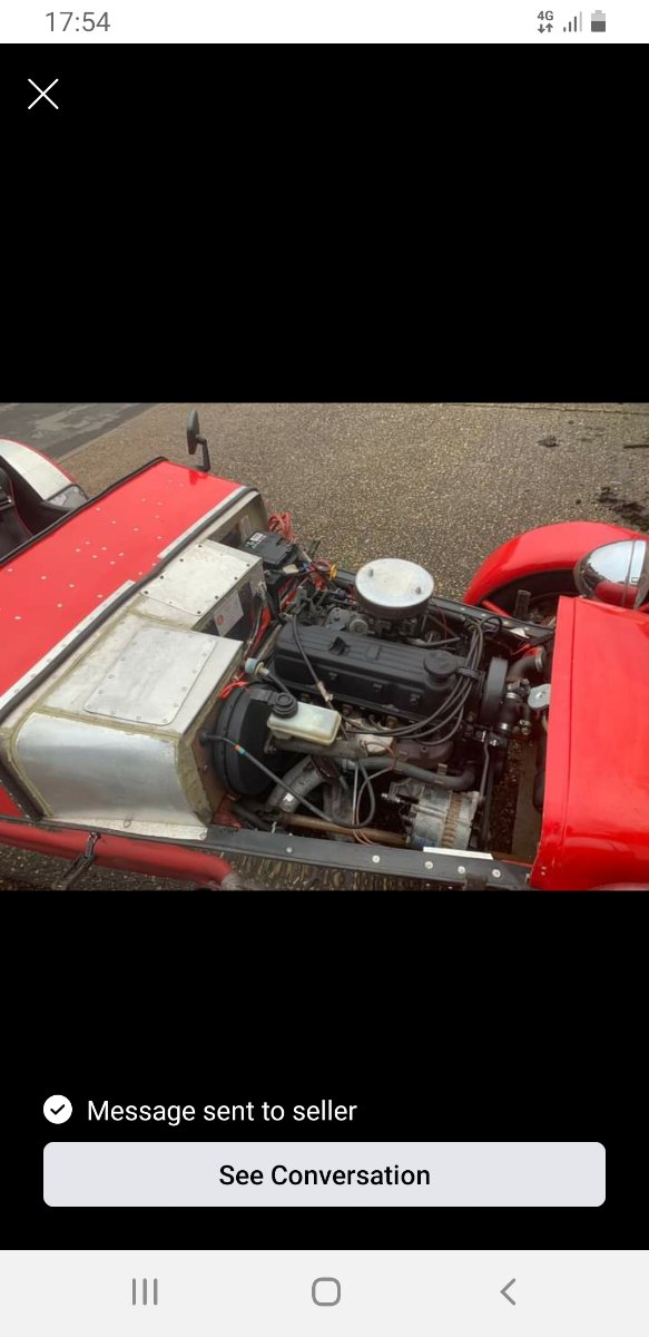

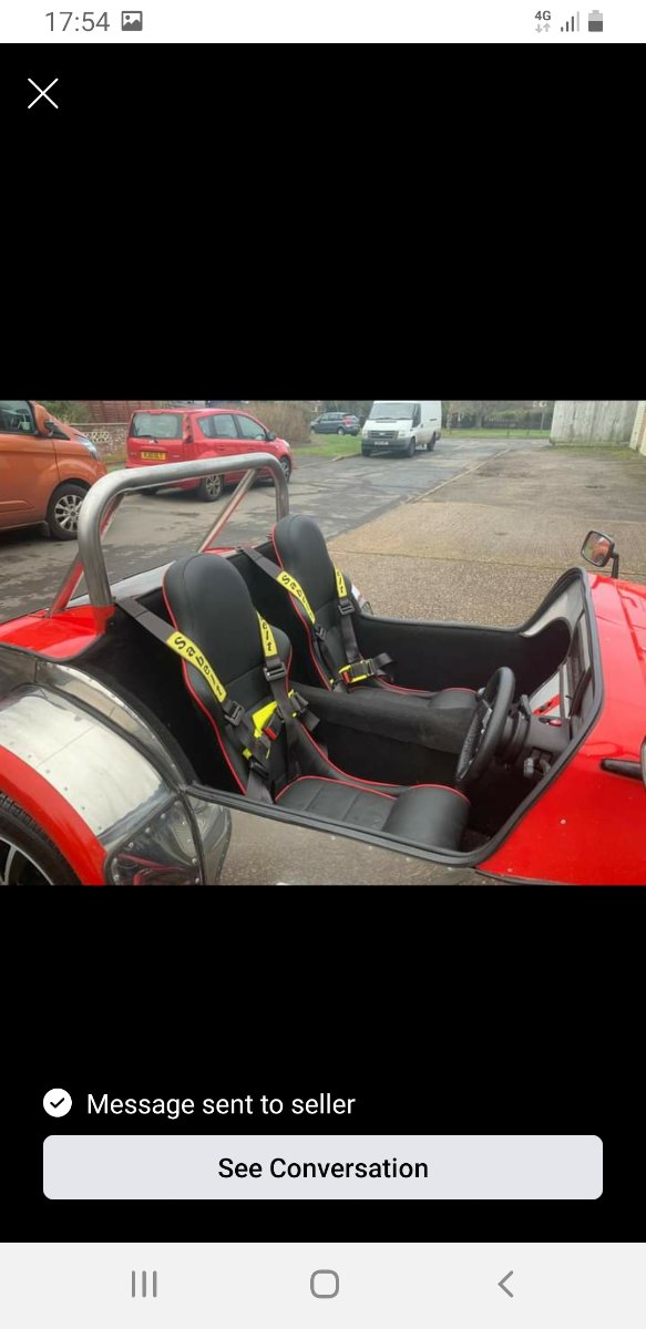

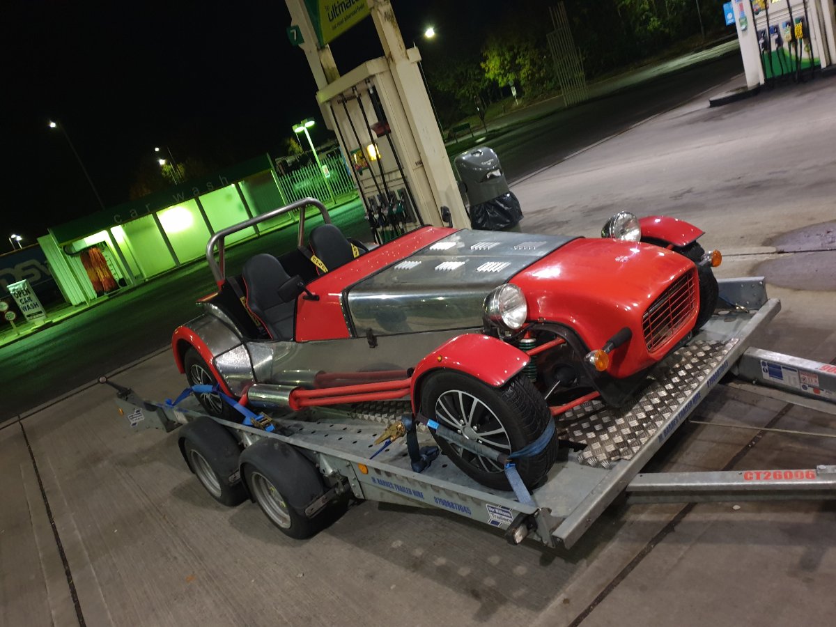

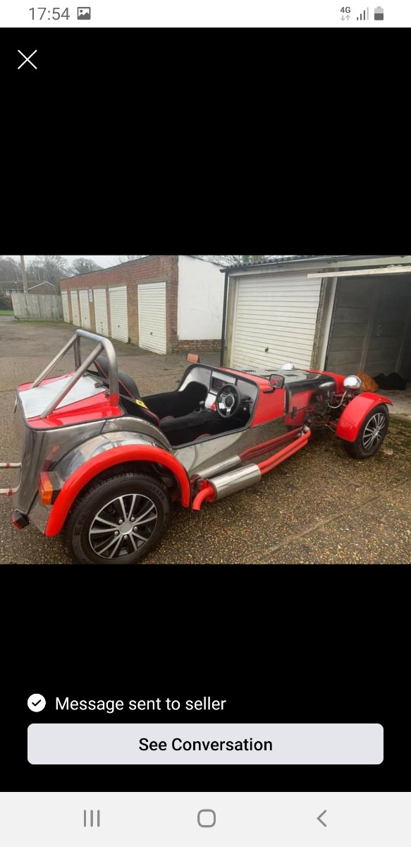

Well im getting close to the point of iva. Well the point were i dont know what else is to do unless i get my fail sheet.  Im stuck on the last couple of bits mainly seats i need to move the drivers back and do some more reinforceing. Also need to wire up the reverse light. Im wondering if there is anyone local to county durham who knows his stuff and beem through iva who could come and check over my build and help me with the seats. My mechanic skills and electical skills are limited i can follow a haynes manual thats about it 🤣 dont mind paying an expert to come help 20201013_034851.thumb.jpg.3754bcfe3fb58fe736357269be573fef.jpgScreenshot_20201011-175419_Facebook.thumb.jpg.3e7381e4d12e8e17b8d1206b3622e025.jpgScreenshot_20201011-175412_Facebook.thumb.jpg.dd4c5c2b634b270cdaa1d965216b78a3.jpgScreenshot_20201011-175406_Facebook.thumb.jpg.7fe3a25ce893b6684e5e0a18181f40b0.jpg

Just a few points, your fog light lens should be vertical (easy to do on the day), but it also looks quite low. The bottom of the lens should be at least 250mm above groundline.
I can't see the brake fluid sticker near the reservoir. Section 09D part 17
Steering wheel might need a padded centre, the Mountney wheels have failed some tests.
