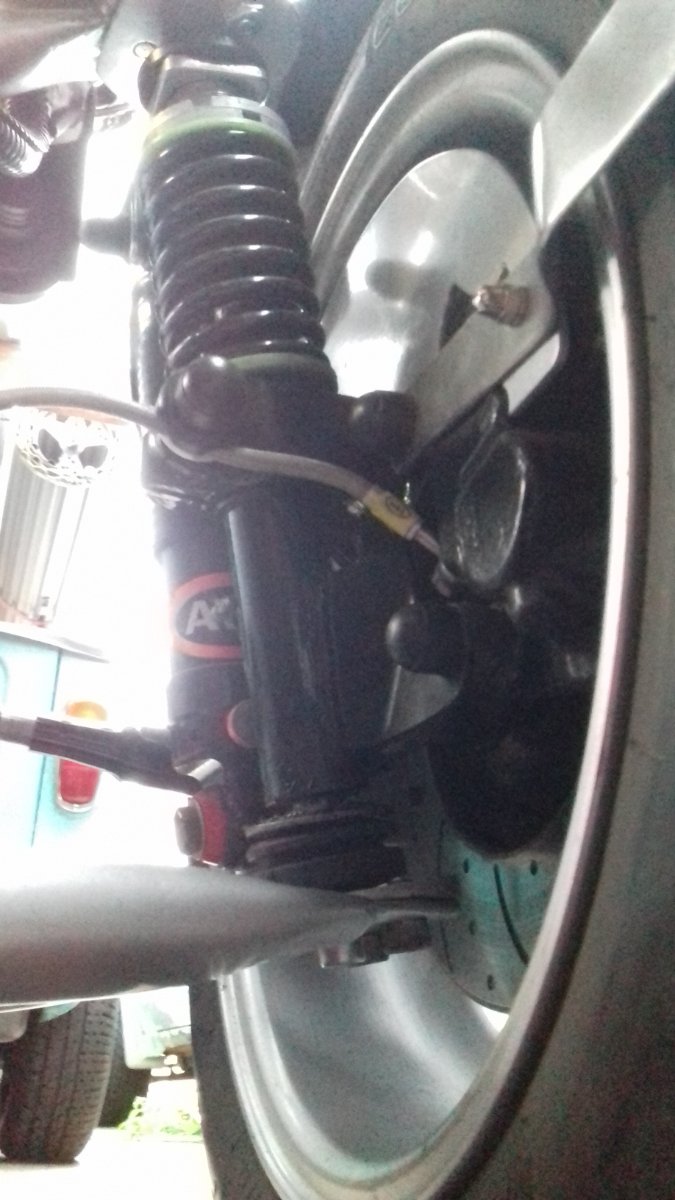

Hi all just bought a car and was looking at front suspension is there an upgrade to replace what I have in picture attached, what are my options.
Sorry to say but it looks like you have not got a 2B.
My car is a 2B with modified sliding pillar.

Cortina subframe S7
(Monocoque tub with ugly Cortina front suspension actually works quite well. The rear suspension can "knock" with the diff rotating slightly under load, and requires a  torsion bar fitting to stop this. Again the cockpit is narrow with the usual seat problems)

I’m picking car up on Saturday so will have more info, I know it was commissioned in 1999 can that front end be changed.

Changing suspension is up to you to design and build as I am not aware of any upgrade kits for this.

so I’m led to believe I have an S7 and if I want to upgrade it’s a case of welding on new suspension parts which I will probably go down that route.
just would be ideal to know what front end to use.
 Search on this site under "cortina" showed a few references to the same question about replacing the front suspension. It seems the Locust kit cars have a cortina setup which some people have replaced with tubular wishbones. Google "Locust wishbone suspension". First result gives details of the conversation. Hope that helps.
