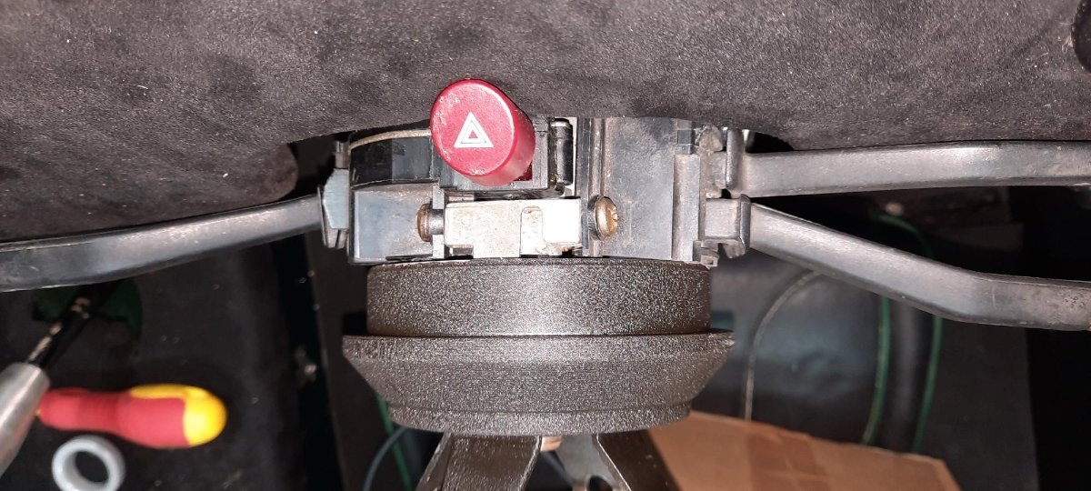

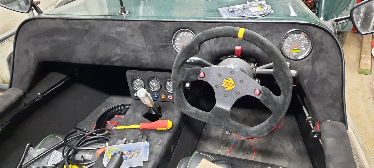

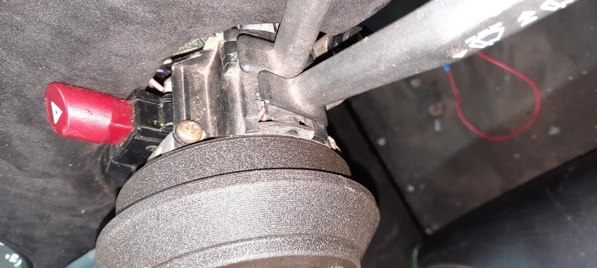

I've discovered the reason why my steering is stiff and hard work to turn the wheel (one of my recent fail items). The back of the steering wheel boss is fouling against the sierra indicator assembly, so much that it is gradually wearing down the indicator assembly plastic. Has anyone else encountered this?
Pic below is with Momo boss, but Mountney is the same, if not worse.

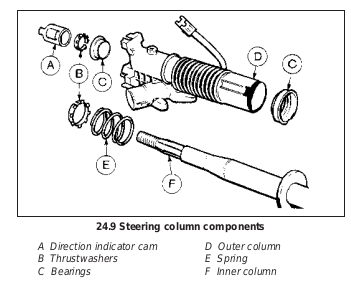

This is an odd co-incidence, I am just rebuilding the steering column assembly on my Exmo. When I took it all apart I noticed that the indicator cancellation cam is broken. On closer inspection it seems to me that this cam also acts as a spacer between the bottom of the boss and the top of the small ball race thats at the top of the sterring column tube. You could check the state of your cam ?

I've managed to sort it by using some old plastic lids to cut out disks with a hole in the middle to act as a spacer on the back of the boss. Only 3mm or so but just enough to move it away from the indicators. Problem solved and steering now SOOO much lighter. 🙂

Indicator cam is a spacer.
You have to look at the construction of the column, unfortunately I can not find a diagram at the moment.
When you tighten the steering wheel nut you are not tightening the wheel down onto the shaft, but pulling the shaft up to the wheel against a spring on the lower part of the shaft.
The indicator cam spaces the wheel from the top column bearing, there should also be a shaped bearing washer under the cam. the spring pulls the wheel and spacer down to the the top bearing.
Cam, or a spacer of some type, is needed.

I agree, I have just put mine back together on the bench, outside the car. As the boss is tightened down more thread appears at the nut (obviously), and the spring at the bottom gets compressed as more of the shaft is drwan into the tube. The two thrust washers slide on the shaft, the top one is pushed down by the cam and the bottom one pushed by the top of the spring. When the boss has reached it's final position, firmly pressed down on the taper there is still plenty of compression available at the spring. So the cam is not crushed it only has the spring tension pressing on it. I lifted up the assembled unit and put the bottom end of the shaft on the floor, grasping it by the outer tube (the part that is bolted to the cross member under the scuttle) I can push the outer tube down the shaft against the spring and then it moves back when I stop pushing. There must be a reason for it to be like this,  possibly to absorb small compressions that try to push the shaft towards the driver ? reducing/eliminating vibrations ?.
