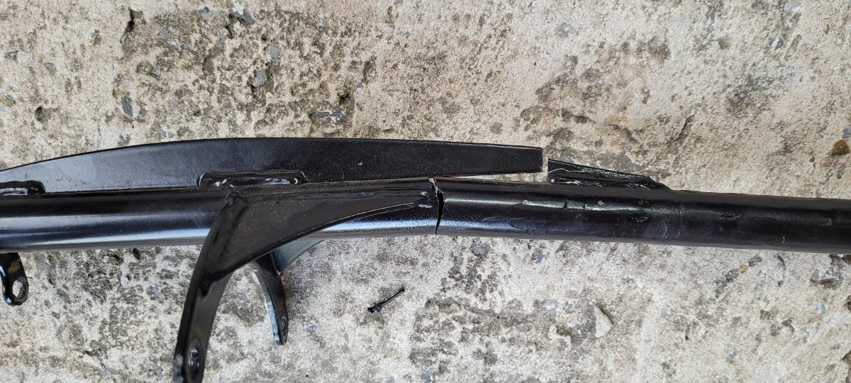

So my GBS quickshift has broken (AGAIN):
RichyB very kindly welded it up for me last time (you can maybe see the repair to the right-hand side?) so I was wondering if there is anyone down South (well, SE) who might be able to do a similar job for me?
There is a local guy who has done some work for me before but he charges a small fortune and I'm a tightwad - happy to pay parts plus a few beers, if anyone has the kit?
I've been advised to try fit a new tube inside the old one and then weld along the length of that top fin, not just in the spots GBS have done it - sound sensible?

I agree with Matt, I saw Rusty take his linkage off and the main problem was it had been cut and welded to the original anodised steel tubing and that causes a weak weld

Well, I've had mine welded up again so hopefully it will be better now with an internal tube and a longer weld down the main fin.
