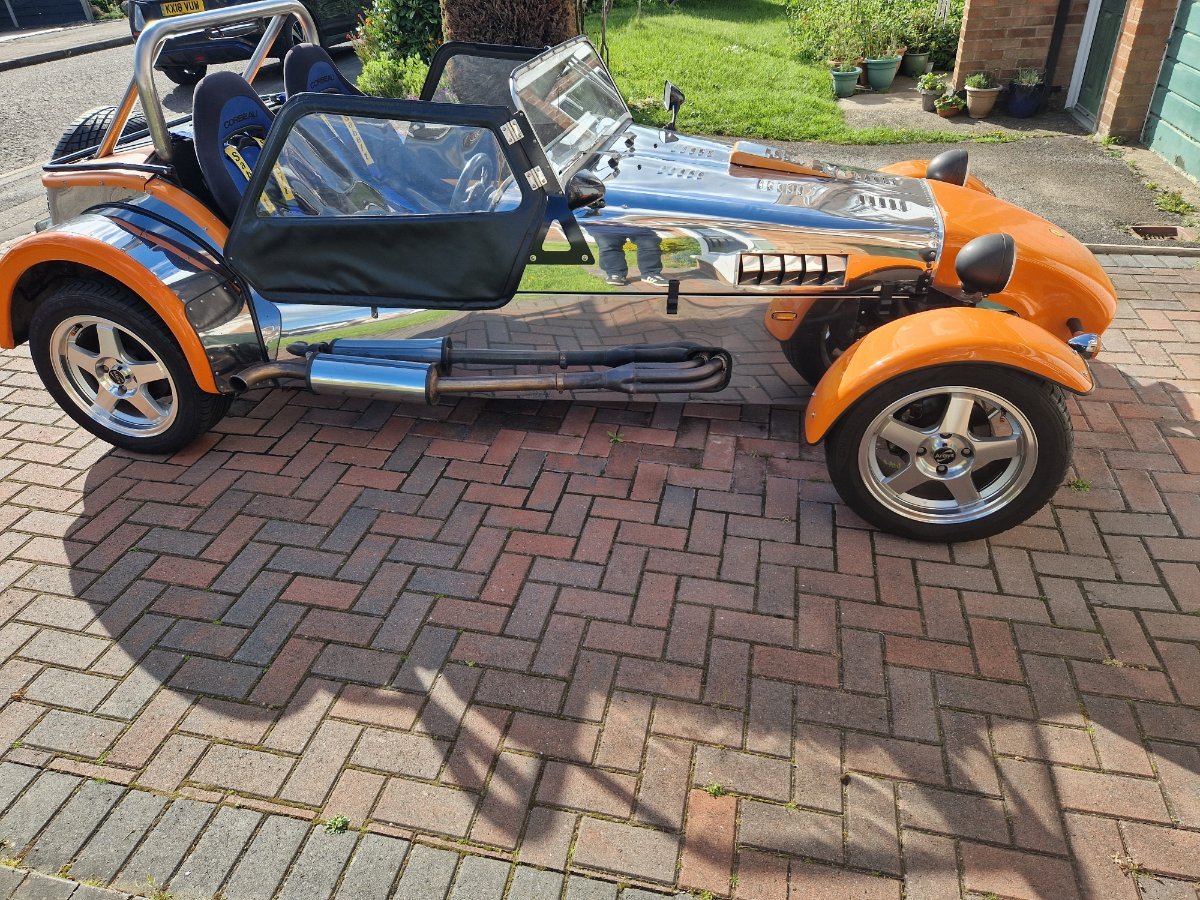

Hoping you can help. i have a 2B and dont like the high sitting rear arches. can anything be done to this? has anyone else got around this issue and if so how. i also have wide rear arches so a am looking for standard width ones ideally GRP ones and not stainless like the current ones if anyone has any that would fit. the car was built in 2001 with sliding pillar suspension if that makes a difference to fitment.

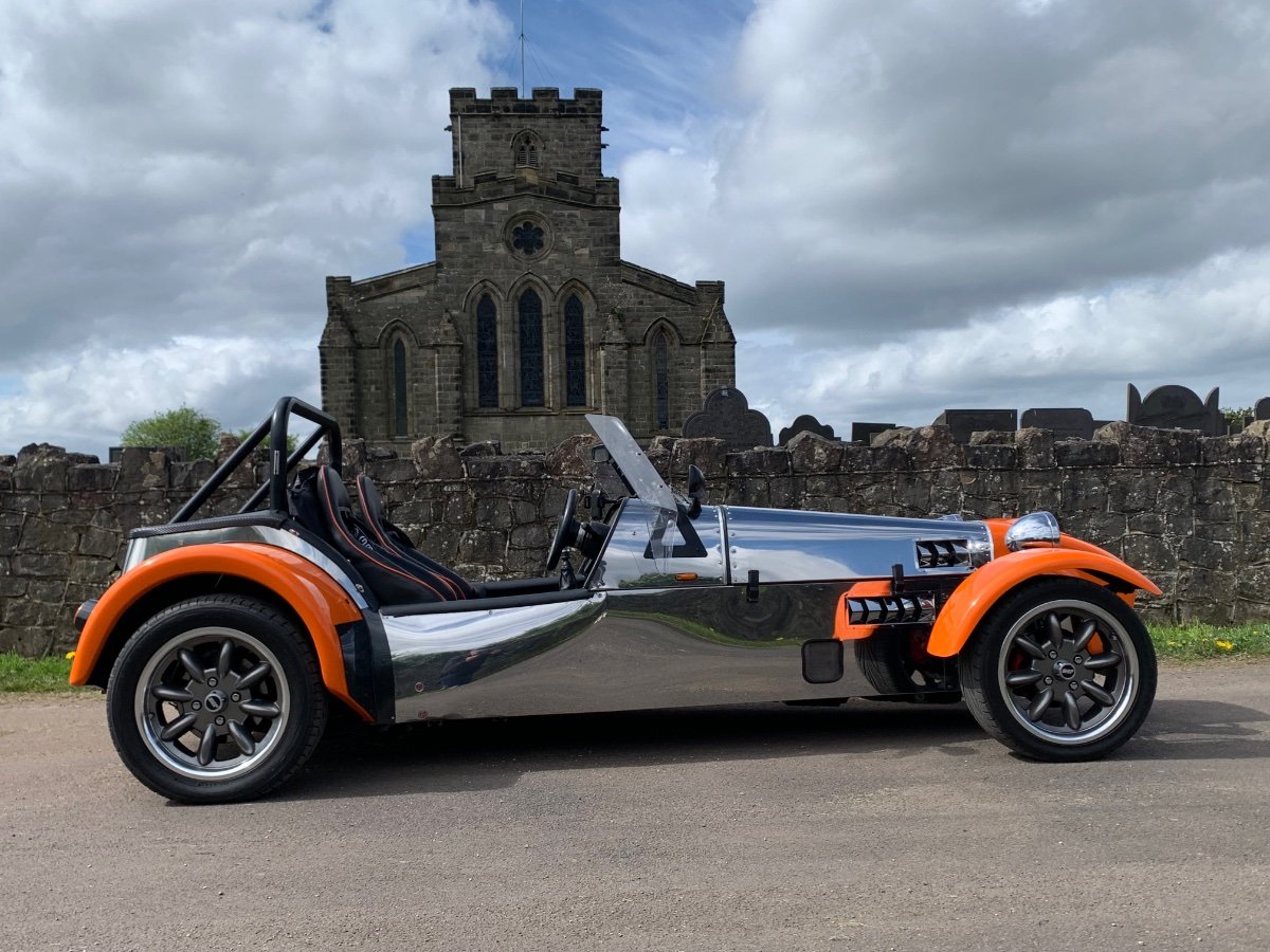

I replaced mine with new GBS grp arches and fitted them lower. The issue with doing this, the panel above the arch will have to be replaced, and possibly rear panel. It all depends on how it was built originally. Mine bolted on so easily removed
On mine I reprofiled the front and rear of the stainless to bring arches down and filled gap left at top with new stainless. I rebent the bottom returns one tab up at rear and two at front, this is the max you can go keeping some angle from body to outer wing.
