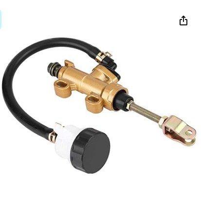

But this is the Amazon 1" one https://www.amazon.co.uk/DORMAN-PRODUCTS-ALLPARTS-M2796-MASTER/dp/B001PYRHP6/ref=nav_signin?tag=googshopuk-21&linkCode=df0&hvadid=606632412635&hvpos=&hvnetw=g&hvrand=7583416905106424428&hvpone=&hvptwo=&hvqmt=&hvdev=c&hvdvcmdl=&hvlocint=&hvlocphy=9046274&hvtargid=pla-572117965588&psc=1&mcid=1ef4eb4699a23abca3ee58059c0861b0&th=1&psc=1&returnFromLogin=1

Unless I've got the scale wrong, that is tiny - wouldn't stop a go-kart 🙂
Agreed but it was the style I'm looking for

Bore is not 100% I've gone for a dual outlet 3/4" one, need to make an adaptor plate & run new lines, we'll see how it goes.
