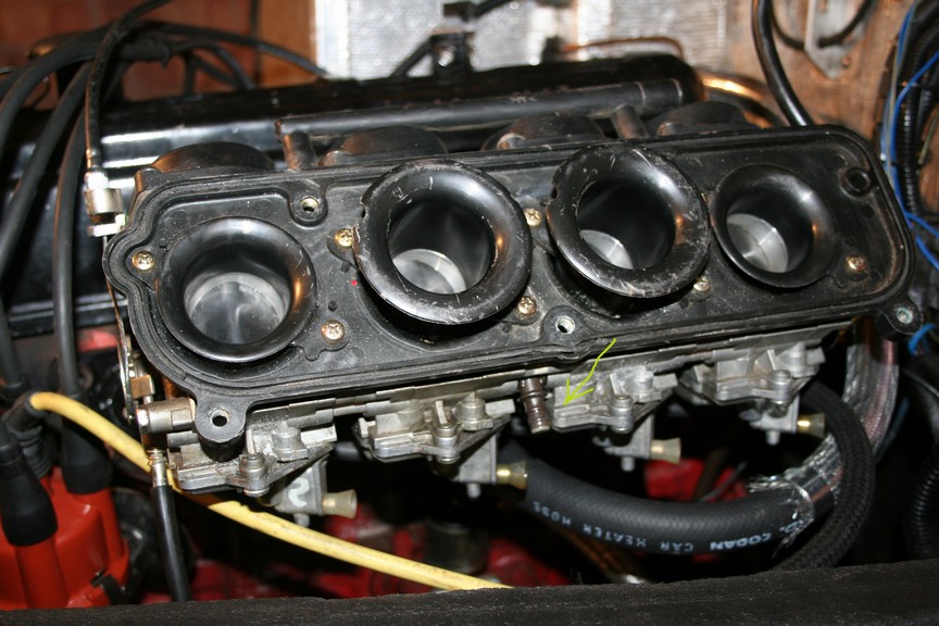

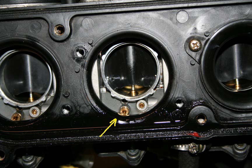

  10. Andi
    Zx6r Carbs
    Having got a set of a cheap carbs sold for spares due to the idle screw housing snapped off. (fixed a nut and bolt in place with jb weld) Ive stripped and cleaned them and drilled 1.65mm main jets. The car started up and ran ok but petrol was weeing out of this brass hole (see picture). Ive got duplicate carbs drilled to 1.8mm and dont have this problem. I have a R1 fuel pump. Anyone got any ideas before I redrill the jets? Thanks

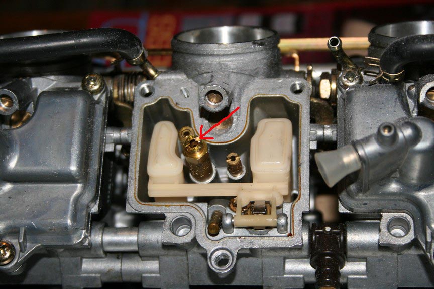

  13. Andi
    Drilling Jets
    I have got a cheap set of carbs for spares which I want to play around with. I take it the red arrow is the main jet that gets drilled out.? Im going to try 1.65mm to start with Andi

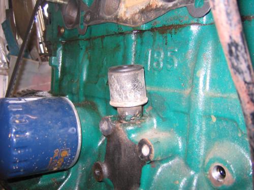

  18. Andi
    Crankcase Breather
    I have the breather pipe land on the door mat today, it does seem a serious bore and will probably just fit into the rubber on the oil seperator (see attched borrowed pic from an old rhocar post) Or does the whole of that cylinder/seperater have to come out? There doesnt seem to be anything in the hole but it it does seem to go right into the crankcase, just down maybe an inch. Thanks

  24. Andi
    Crankcase Breather
    Hi all, I used to have a heavy duty braided breather pipe hanging out of the engine which I was about to put a catch tank on for. It was there yesterday but after a blast in todays tempting weather, it appears to have dropped off. All that is left is a rubber bung and there is slight spray underneath the bike carbs. Where could I get one from and how is it fitted. All I can see is a hole in the rubber with no clear way of attaching anything. When I looked in the Haynes manual it seems that the pipe (albeit a different sort of pipe) is just pushed in. Regards Andi
