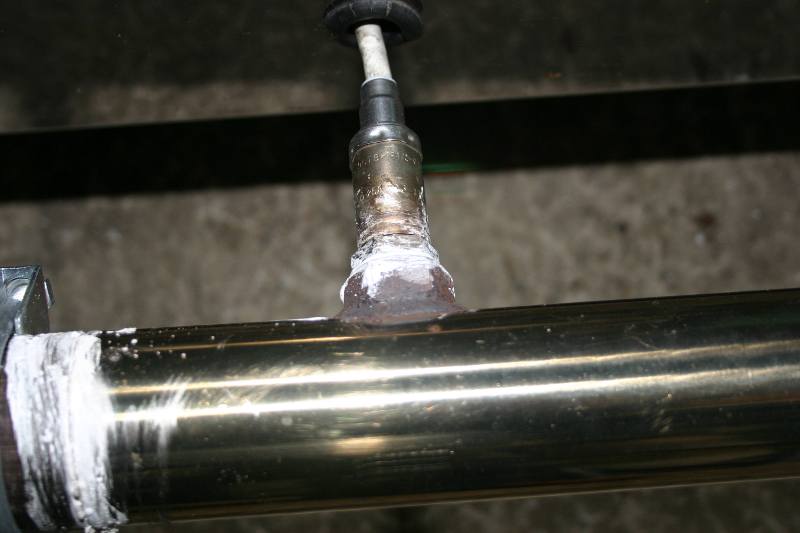

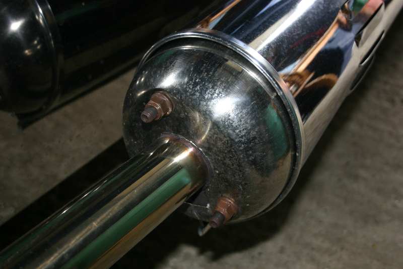

  1. Hi I need to cover the 3 bolts near the cat/silencer... and the nut for the lambda sensor which is welded to the exhaust tube... Obviously most rubber fittings would probably melt, so will likely need something made of metal. I guess I could use exhaust past to 'glue' something on etc. Just wondered what creative ideas others have come up with / suggestions etc?! Many thanks Harvs
