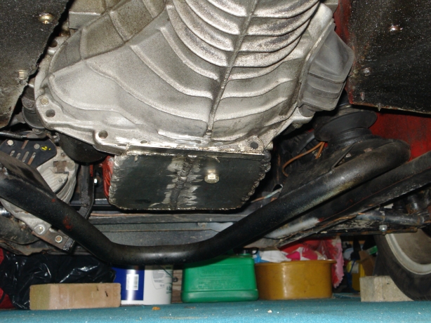

  10. Another big thank you to Bob, Sylvia and family ( and friends) for a fantastic day. Those that didn't get there don't know what they missed! Activities, food, company and evening entertainment. I am sorry the car was not there, still having tappet problems, not to mention a sump that needs shortening. I saw some spectacular lightning over Andover on the way home (23:15 ish) --I hope the rain it foretold missed those of you camping. Thanks to all. Graham B
