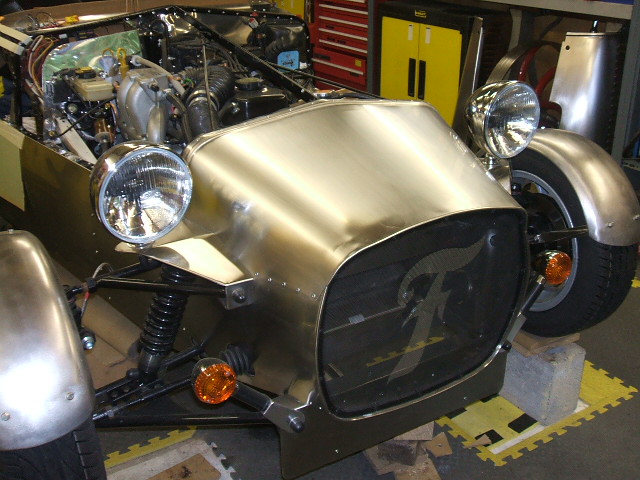

post-3135-0-53079000-1331510324_thumb.jpgHave you got enough "spare" material to form a right-angle return, that can then be bolted/riveted together to give a straight & strong shut-line. Have done lapped joints on our 2B with a stiffening plate behind which look O.K. The join is parallel with the headlamp mount plate,& these's another vertical join on side panel just behind headlamp pod.

Thanks Knights_Templar and florin metal works. Florin, the panels sit against the shroud for the rear shocks and mount for the roll bar - a riight angle return is not possible here. K_T, I take some comfort from your comments about it not being hugely noticeable. Still not as happy as I could be, but there you are...
