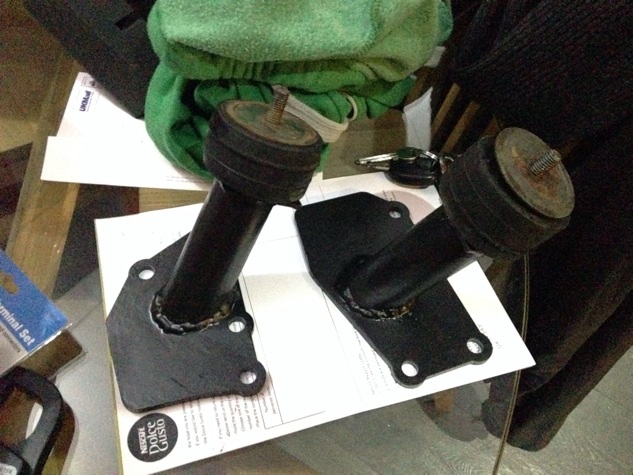

New heavy duty mounts to hopefully stop the engine sagging, propper rubber fuel pump mounts for the low pressure pump, serial cable and USB to serial cable and the water temp sensor kit. I'm edging ever closer! Wish me luck!
just looked at your pictures and you have retro ford aswell but different rubber mount position I see why its sagging
I reused the old mounts, guess they had had it.

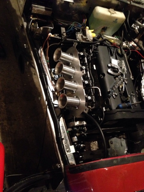

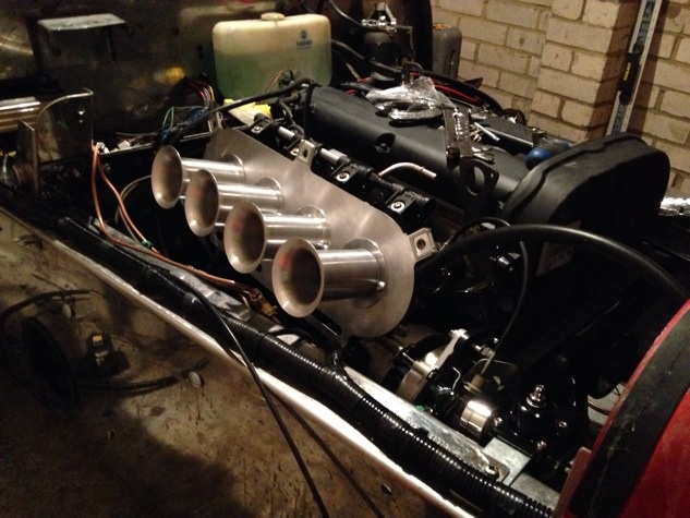

It's alive! Think I preferred it when it wasn't though, idle is like a sack of nails, really off putting infact, when you look down the trumpets you can see an orange spark/light. That's the point I killed it before any harm was done.
The throttle cable is a joke, located in a ridiculous position on the end of the itbs which leads to an all but impossible route down to the pedal.

It can only really be the ITB's that are causing the problems, it's defo a fuelling issue, I've got good and steady pressure, set slightly higher as per what Omex said when speaking to them today, that's the point that I got it to start and stay started but the idle is awful.
They could need balancing.
I wish I did have some omex experts close by, John has been an amazing help but he's an emerald guy!
Also... The ITB set up i have is held to the inlet manifold with silicone pipe. I've spaced the Throttle body's just away from the inlet to avoid heat transfer, any advice on if this is wise or if it should be pushed right up to the inlet manifold?
