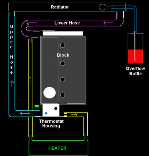

Principles. The stat needs to be in a flow of water to work. No flow/low flow = no/slow change in temperature of the stat and slow opening. So the thermostat housing has two other smaller outlets to ensure flow during warm-up. The one on the passenger side is the warm-up bypass and is Teed into the lower rad outlet hose and is closed by the stat when the engine is up to temperature. The one on the driverside of the stat housing is to the heater and then Teed into the lower rad outlet hose and is always open unless you fit some sort of valve in it.
On my car I have a heater, use the latter hose as heater feed and warm-up bypass and don't bother with the intended warm-up bypass. I don't bother with the little bleed hose either. It all works fine. Diagram below and it doesn't show the warm up bypass. Spit and suck off the rad top works fine and doesn't matter at what height it is fitted.
Nigel

Thanks for the schematic and the descriptor Nigel.Big help.
