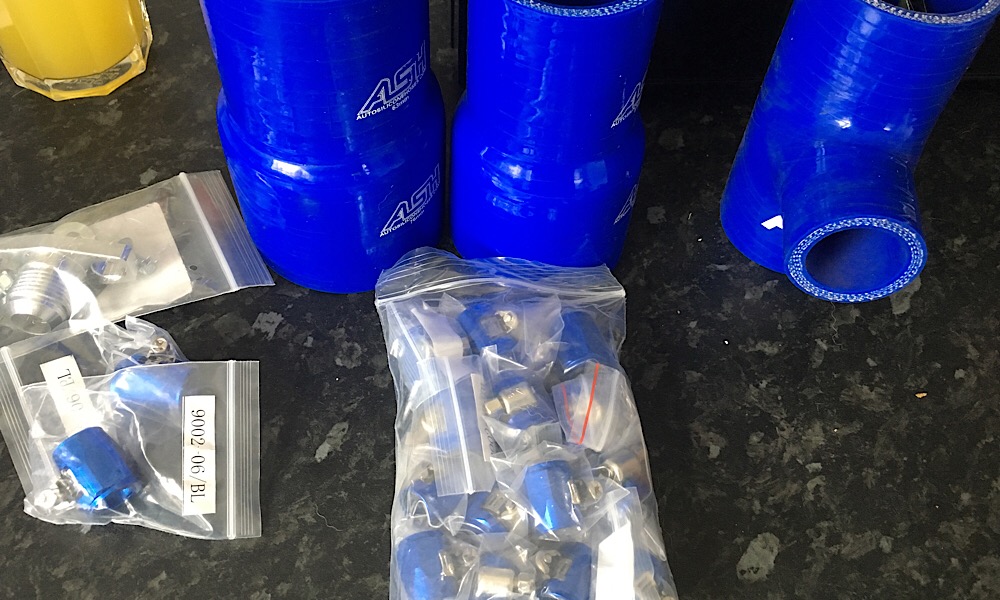

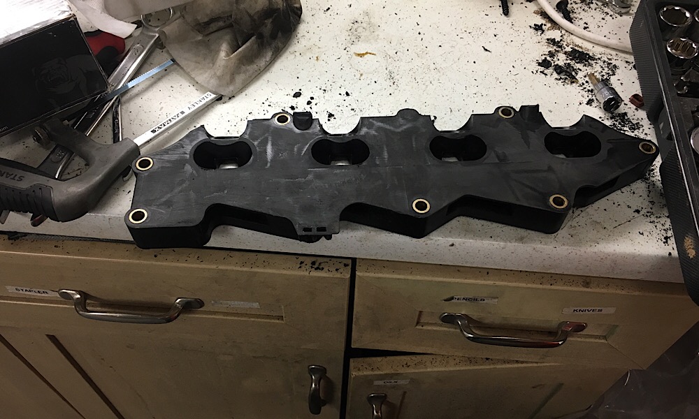

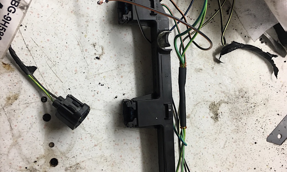

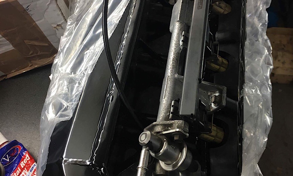

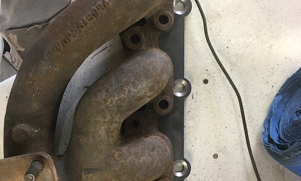

I cut the zetec original plenum to get take the injector bit stripped all the unnecessary wires out of the injector rail used some gasket sealer and bolted the two together ready for installation and purchased a few hoses and hose finisher clips got to keep it bling under there next step was to make the exhaust manifold adaptor plate so I could use the escort turbo which I picked up for 25 thankfully chris (tractor) had already got one so I took that and made myself one
