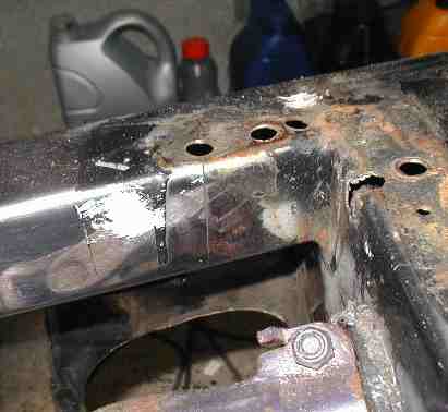

I plan to fix up my tub, it's not so bad yet, but, the cracks do need catching and bracing right now!

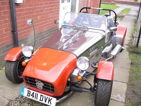

If you haven't read the whole post, mine we think is a mk3 or 3A stainless monocoque. Inboard coilovers of course (1997 probably).

If you search my posts you will find the reinforcements I did to the tub/chassis.
I have not suffered from tub cracks except for the underboot floor which again is well documented

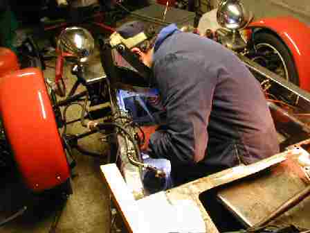

I've now had my stainless monocoque  tub welded and strengthened at work, now it's back at home for winter rebuild.

To be clear,  I'm after new front spring and shock coilovers to fit an inboard sprung stainless monocoque Robin Hood.
