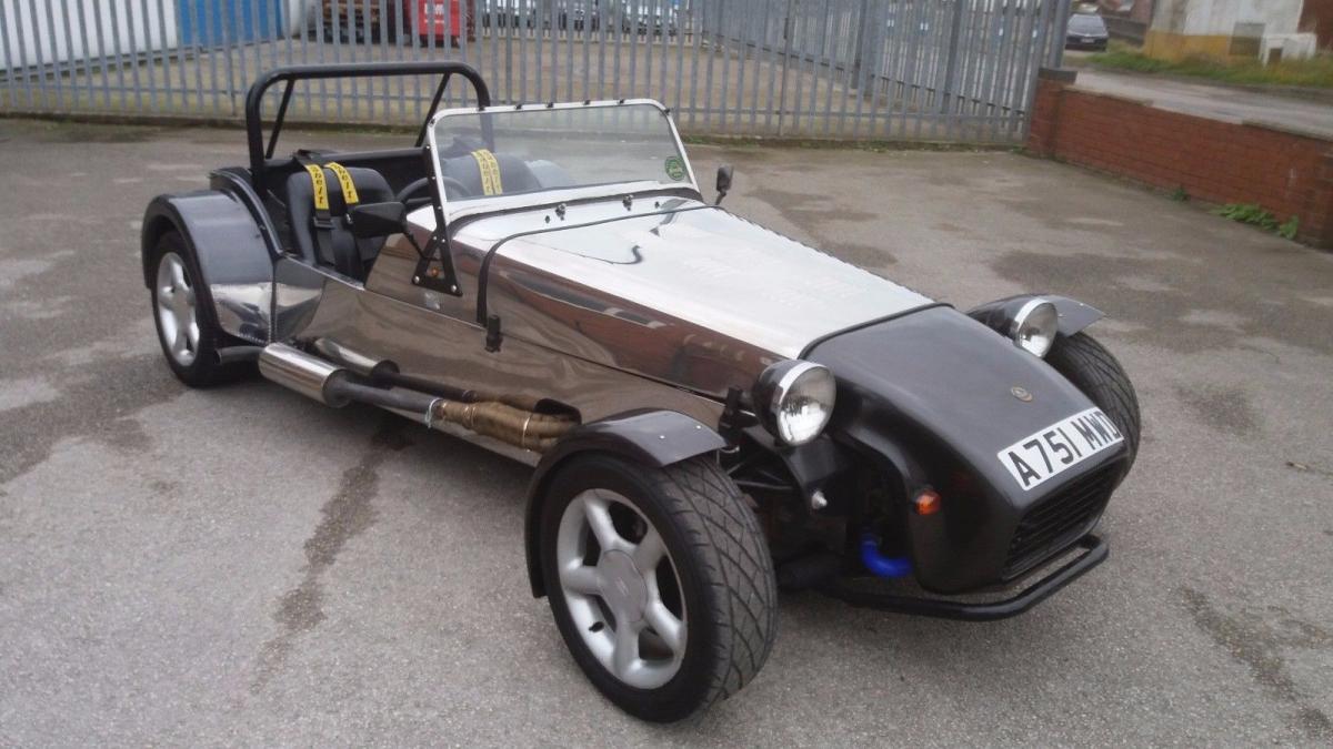

Just bought a stainless tub Robin from ebay land. Maybe somebody knows a bit about it. The one in Beverley, East Riding?
Being ebay I just rocked up chucked it on the trailer and drove home.
Closer inspection shows it to be a bit of a shed. Has MOT but really shouldn't have, many small faults but the cracks in the welds are not new and are spreading. Oh dear!
Just a help call to anyone (in the Midlands preferably).
Would like to talk to someone who has a similar car and hopefully meet so that I can put a tape measure over it to give me some dimensions to work to.
One more on the road!!

May have been built as a drift car? The diff feels welded (the seller assures me that it's a tight LSD). Rather than 3point turn it into my garage and put up with the rear wheel scrub and the front pushing on, I've taken to just flicking it round on the throttle. Much easier. Get my point?
Would like to have a car with which I can drive my girl to lunch in, plus trackdays (when I need to have a release from the modern can't pay attention to anyone else but themselves drivers out there! (Rant, Sorry!!)).
OK, you still with me?
The car:
SVA 2004, pre 1998 tub I guess (because it's a stainless non tubey)
2.1 race tune Pinto, type 9 box, LSD(to be confirmed). Inboard coilovers on the front, coilovers rear from the sierra damper mounts.

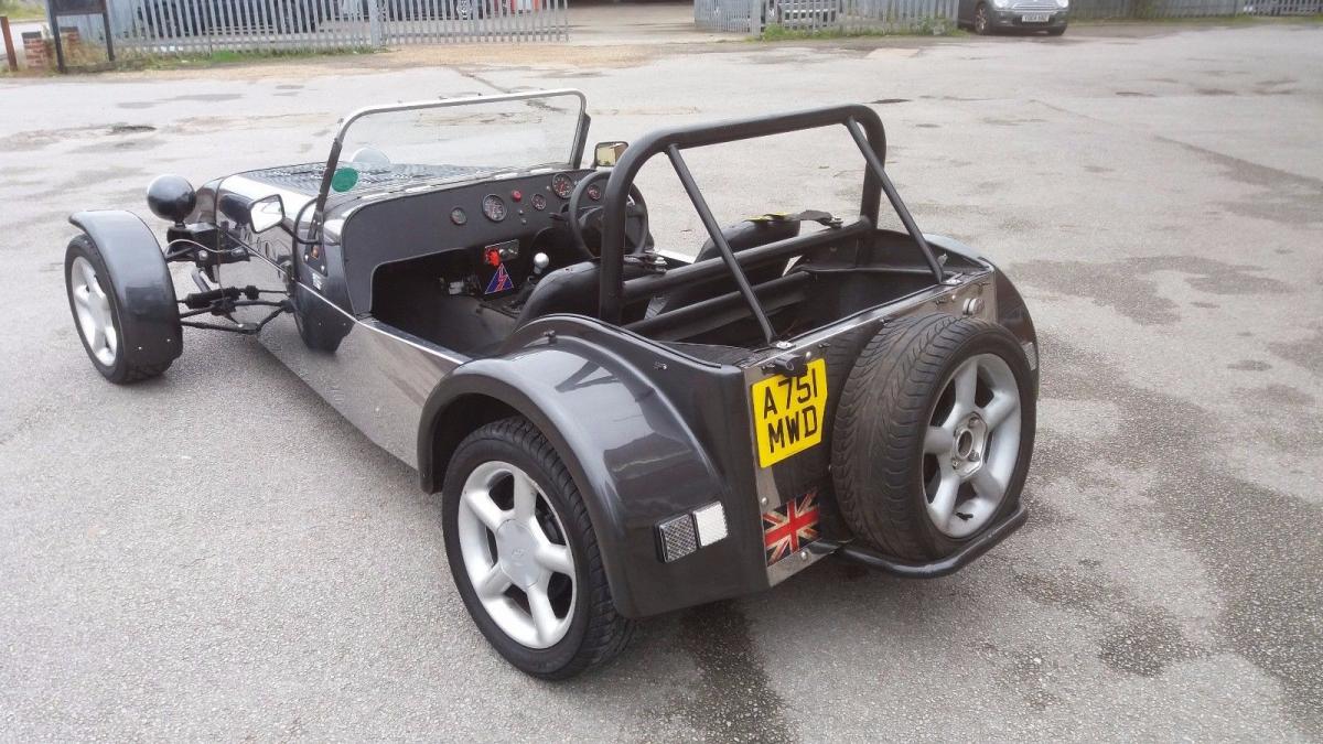

Issues - many:
No wipers, no wash, no horn, etc. These easy, I can sort.
Things that I need help with are:
Nearside rear wheel rubbing on inner arch (rear suspension geometry check)

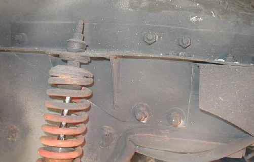

Rear coilover angle mounts bent (rear suspension geometry check)
Steering rack arms wrong angle?
Rollcage mount really s**t (is this normal?)
Cracks to front frame welds and joint below battery tray (sound familiar?)

No wipers, no wash, no horn, etc. These easy, I can sort. Horn & wipers are as you say easy to sort, Wipers, go for an early mini system (need to slightly modify)
Nearside rear wheel rubbing on inner arch (rear suspension geometry check) Some did depending on offset of wheels, fit a spacer. (the rear sierra subframe is slightly off centre)
Rear coilover angle mounts bent (rear suspension geometry check) The "turn over" of the chassis isn't strong enough here, design something to strengthen it up, (see photo)
Steering rack arms wrong angle? Again, fairly common, if it's too low you could put packing pieces in. (Note; quick rack internals from Rally Design (If they still have them) are brilliant providing it's the sierra rack.
Rollcage mount really s**t (is this normal?) Along with strengthening for the coil overs, build in plating the outer side of the boot where the U bolts come through, (see photo) also I welded"bungs" into the open ends of the roll bar, these bungs had a 12mm threaded hole in the centre of them, then I drilled through the boot floor and finished off with large metal plates bolted up underneath the boot into them. I've also braced up the back mountings with a length of angle underneath the top lip of the boot.
Cracks to front frame welds and joint below battery tray (sound familiar?) This is common on the monocoque cars, all 4 vertical corners inside the engine bay, and where the front chassis member joins to the sides.

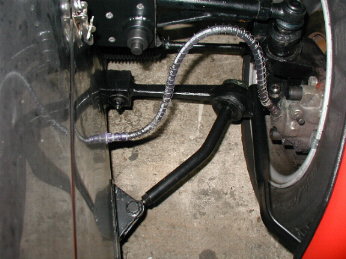

I strengthened underneath the front of the chassis (the cross member that front shockers bolt to) also strengthen up each side where the front shocks bolt to at the bottom.
See if there is a grease nipple in the top wishbones.
You need to somehow FIX the pivot bolt / stud so that it doesn't turn in the chassis, but the wishbone turns on that as it should. If it turns in the chassis, it will wear the chassis holes oval and big, cracks can sometimes be found around here as well,

Greg, my car suffered with the same list of faults yours has including the rubbishy bit of bent angle to support the rear coilovers and the rollcage mount. It's probably better for you to come over and see what's been done and you can take photos if you want. I've pm'd you a phone number

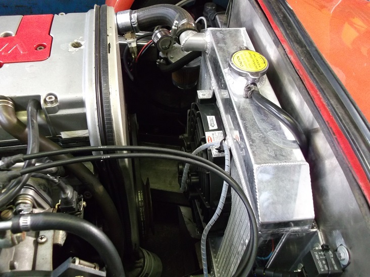

Whilst I'n on, be aware that these cars are prone to overheating unless the radiator / fan / switch system is sorted out. I have a 3 core ally rad fully cowled in, with a Kenlowe fan on an electrical temp sensor in the top hose, with a stat that opens at 82ºC, in normal driving the providing speed over 30mph, the air passing through the rad keeps it cool enough not to require the fan to come on. It also needs a header tank system that works.
If yours has the rad supplied with the kit, it will be the Ford single cored Cortina one, which is barely adequate even if the rad is cowled, and you're driving like miss Daisy.

As for cooling, it does have a pretty old fashion rad on it (assumed cortina). Built in at a steep angle within the nose. One has to remove nose (4x zues fasteners) to remove rad cap?
It has a decently positioned expansion tank (sierra I guess) tho, and yes, kenlowe fan with adjustable kenlowe thermostat with capillary fitted in top hose.
I've never driven it anger of course but, it runs up to temp in the garage ok and the fan cuts in and out quite happily with no histrionics. Fingers crossed eh?
