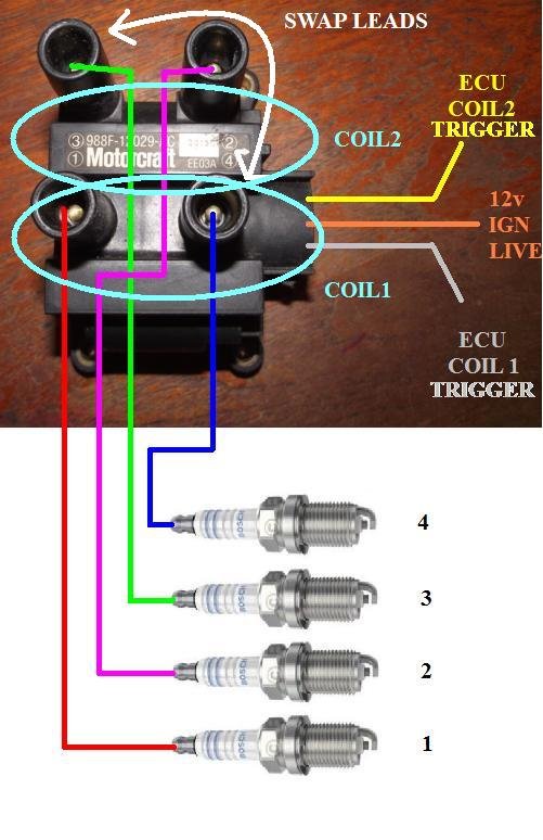

So Ophdir check you have the spark plug leads correctly positioned in the coils. The zetec coil is actually two coils. If you look carefully at its upper surface you will see numbers for the leads, 1,2,3,4. You will note 1 & 4 are together to one side of the electrical plug/socket on the coil, and 2 & 3 are together on the opposite side. The fact that you noted exhausts 1 & 2 were warm suggests that these two cylinders were firing some but as they are not on the same coil it proves both coils were firing some but 3 & 4 exhausts didn't get hot so cylinders 3 & 4 were not fired.This led me to suggest that although you appear to have plug leads 1 & 2 correct you might have plug leads 3 & 4 on the wrong posts on the coils which would mean the fire at the wrong timing to make a bang.

Can't do a pic. Mines ST170, omex and my own loom so nothing would match.
However pic below is zetecish coil, and how it connects. Normal is three pin plug with an ignition live supply to the centre pin (2) direct from a nice clean stable ignition live supply from the loom, not taken from the ECU. Then the ECU supplies two coil trigger wires to pins 1 and 3 on the coils which fire each of the two coils alternately.
Coil one sparks plugs 1&4 together each time it is triggered as pistons 1&4 approach TDC together. Now only one of those cylinders is going to be ready to fire. Say cylinder1 with a load of air and fuel and all compressed so that one goes bang and the spark from plug 4 is wasted as cylinder 4 is just finishing its exhaust stroke. However as the engine continues to turn a further 180 degrees piston 3 will be completing its compression stroke full of air and fuel and the ecu will trigger coil two which will spark plugs 2&3. 3 will go bang but spark 2 will be wasted on a cylinder just finishing its exhaust stroke. Another 180 degrees and the ECU triggers coil one which fires plugs 1&4 again. This time its bang for cylinder 4 and the spark in 1 is wasted. Another 180 degrees and its 2 that goes bang and 3 is wasted, everyone's had a go and we are back to the beginning.
I doubt you have a wiring error. Quick check is swap the coil to plug leads for plugs 3 & 4 at the coil end as per the arrows on my pic. Yours may not be quite the same parts but the jobs just that swap and then try to run the engine.

When i switch leads 3 and 4 around it try to fire a lot more i think but still no start
