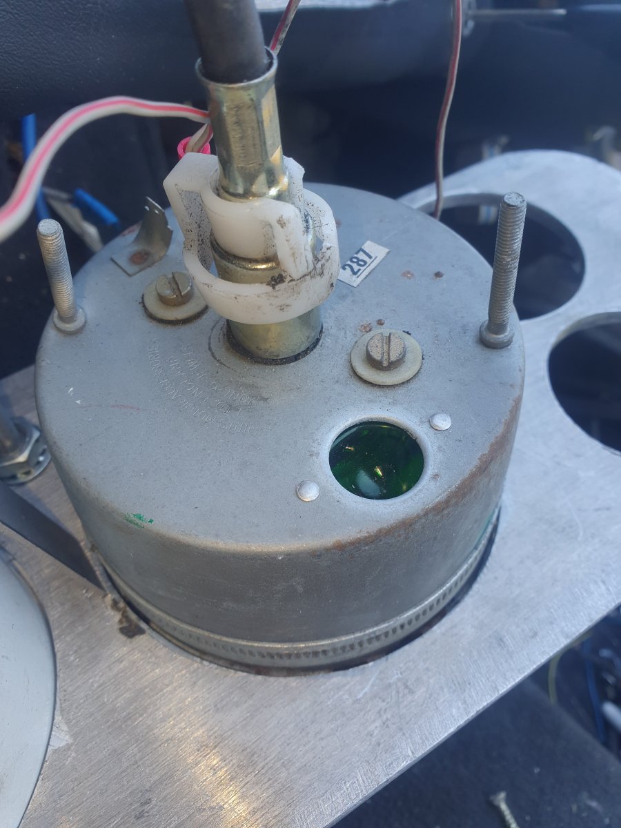

I have a smiths speedo is it just the one big cable goes to the back of it or is the spade on the back needed to ground?
I'd agree, it just looks like an earth tab for if you're using a backlight and the clock isn't mounted into something conductive (say a plastic/grp dashboard). Not essential for it functioning as a speedo.
