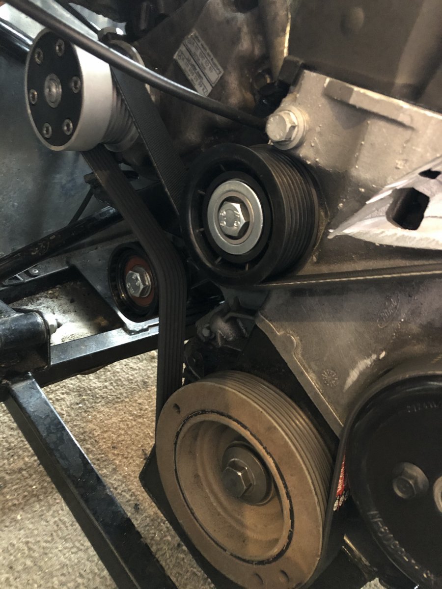

Strange. Liberally squirting the groove side of pulley whilst outlet is disconnected from plenum makes no difference, no slip at all. It behaves itself when disconnected with and without water spray.
I’ll crack on with the tensioner anyway as it sounds like that’s a requirement regardless.

    Auto tensioner is a must. You'll struggle to get the belt tight enough without one and even if you did, if there's run out on any of the pulleys, the belt will squeal. In addition, a tensioner adds so

    It's due to the inertia of the charger. Even disconnected there's a rotating mass that needs to be sped up and slowed down according to the engine speed. The drive between the two is just friction and

Tried using an additional idler and getting the belt as tight as possible no joy.  I’ve admitted defeat and bought a proper tensioner, the same one linked actually.
Ive noticed that the supercharger pulley gets very hot quickly even after 30 seconds or running.  I guess that adds to the belt slipping conclusion, makes sense it gets hot.
Really hope the tensioner sorts it as I’ve spent months getting to this stage and it feels like I’m so close.

Well a day in the garage and no further forward. Tensioner fitted (belt is now really, really tight).
Should the supercharger pulley get too hot to touch within literally 10 seconds of running?
All the pulleys seem to be aligned and I don’t see how I can get the belt any tighter.
If I spin the supercharger pulley by hand it seems OK but clearly that’s not very fast - is there a way of testing the charger?
