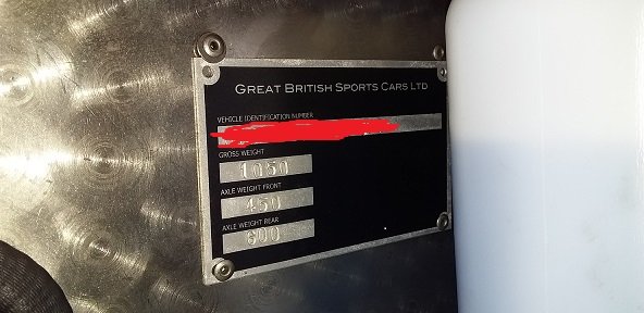

I stamped my own number on the chassis.
You are not being told the correct information,
On your application form IVA 1C it ask's for the VIN number at question 3a (ii)
At question 3b Position of stamped VIN on vehicle.
Your date of manufacture question 4b Is the date you submit you application form.
Do you have a manufacturers plate fitted as sample below:-

This is from a DVLA letter, in which I received the new VIN number for the chassis.   It says very clearly that, before IVA, I need the VIN seen by a garage and signed off.  Other people have said to me that it might not be necessary, but I'd rather not turn up for the IVA and be turned away for this!
Pete
Sorry Peter I asked last night & he doesn't think he can help, but as others have said I would be checking with DVLA as this is the first time I have ever heard of it. Maybe also ask on the locostbuilders, but several members here have gone through fairly recent IVA's but I understand your concern. Alan..
Never did anything like that on my build so I wouldn't worry - no garage inspection necessary. That's what the IVA is for! Maybe the letter is thinking it's for people who are re-stamping a car that has had a replacement chassis installed? I would say just stamp the plate, affix yourself as above, and at the IVA the inspector will check the VIN and details/etc and job is a good'un.
I have to agree with everyone else that it is not required.
MR IVA TESTER will check that the chassis is stamped.
And that you have a manufactures plate fitted showing the correct details.
As IVA Manual Statutory Plates 18
In my case I made up my own VIN number and submitted it on my application Form IVA 1C
NO further action required by you to have it checked.
Hi all, thanks for your replies.  I'm starting to be swayed by the number of people (on this forum and elsewhere) saying it's not necessary.  I must admit, my initial reaction to the letter was to think "Can't the IVA examiner just check it during the test?" - That would make more sense...   The statutory plate and stamp are complete, so I think I'll take the small risk that they say something about the confirmation signature at IVA!
