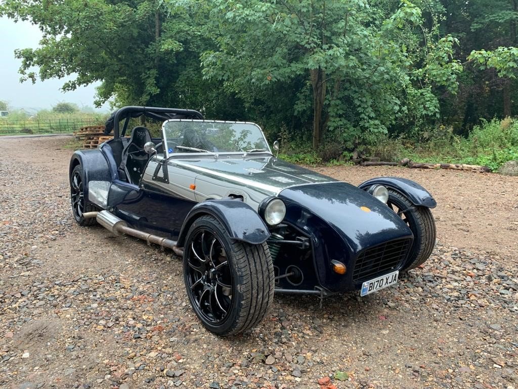

Are your rear arches a fibreglass edge around the wheel attached to a wide strip of metal that joins it to the body? If so, these are the normal 2 piece 2B arches which are normally seen with the metal in a natural stainless steel finish.

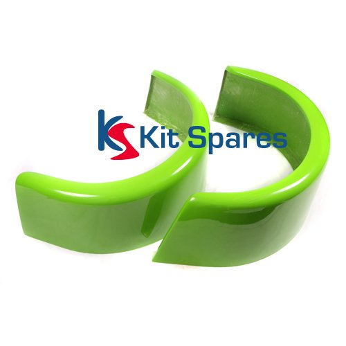

Superspec arches are one piece fibreglass like in the link.

With my arches being bonded on and filled where the arch meets the body I presume that I will have to grind them off and repaint the body?

just to clarify the link I put on is the Superspec arches that you recommended.
Hopefully you realised before order but the link is for ONE off side arch, not a pair of arches.
