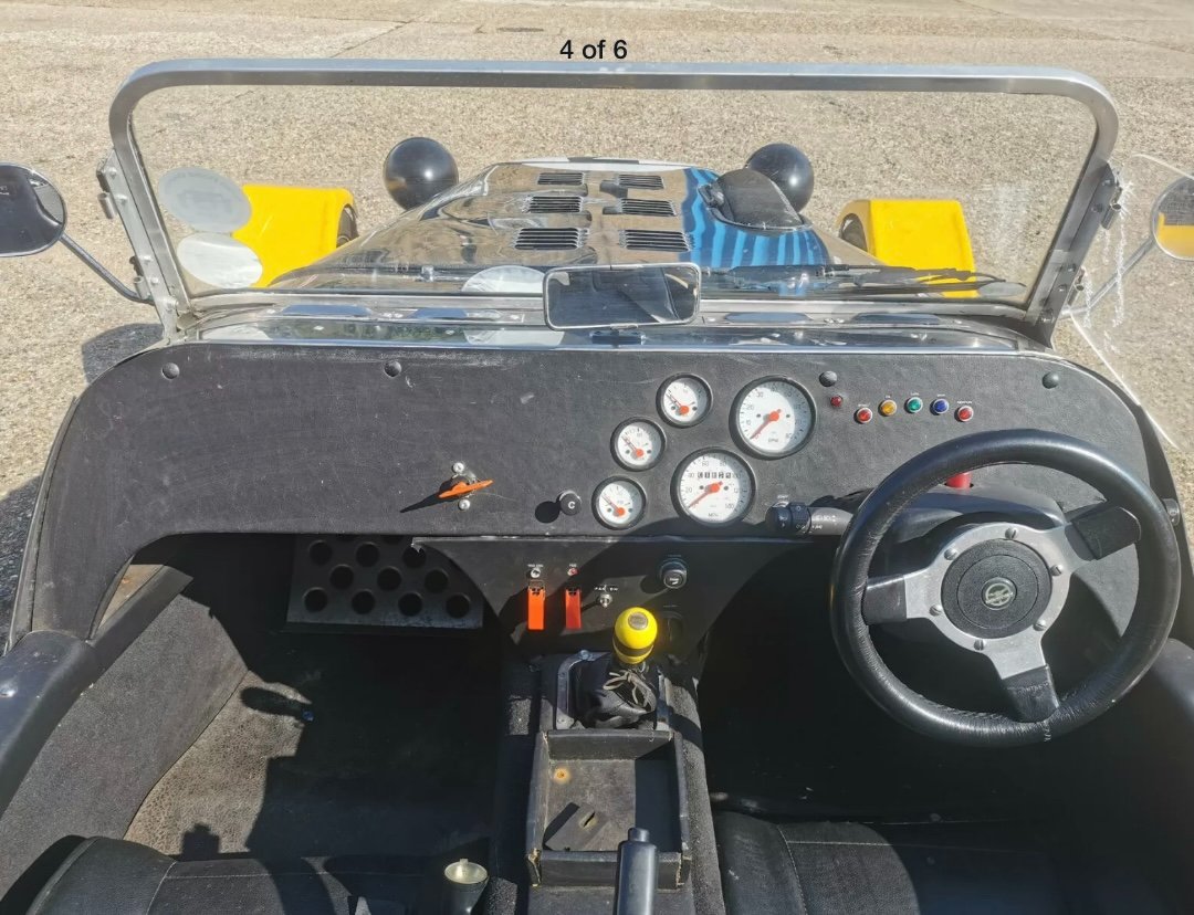

The fun starts here - anyone know this car?

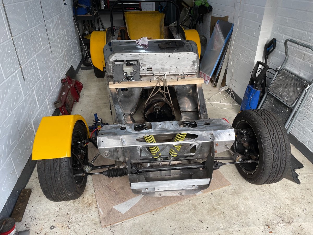

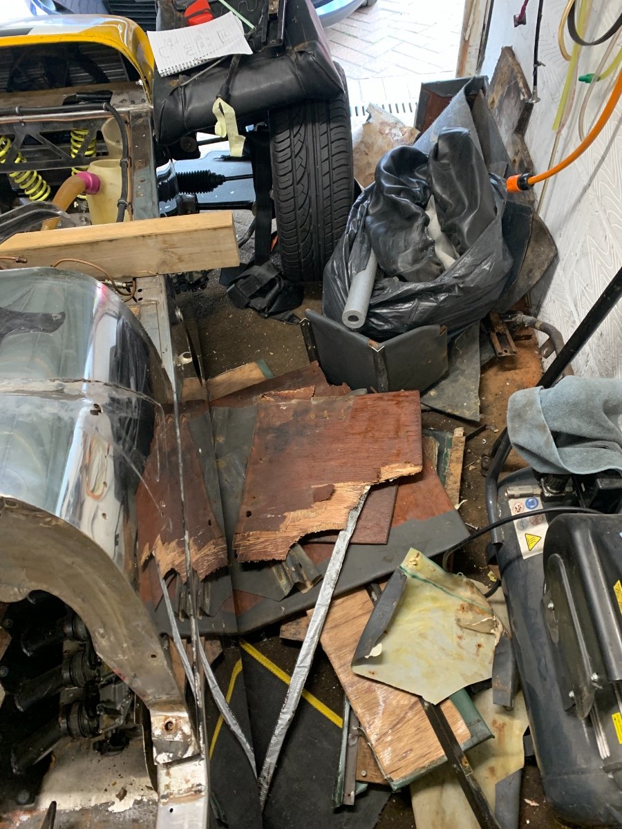

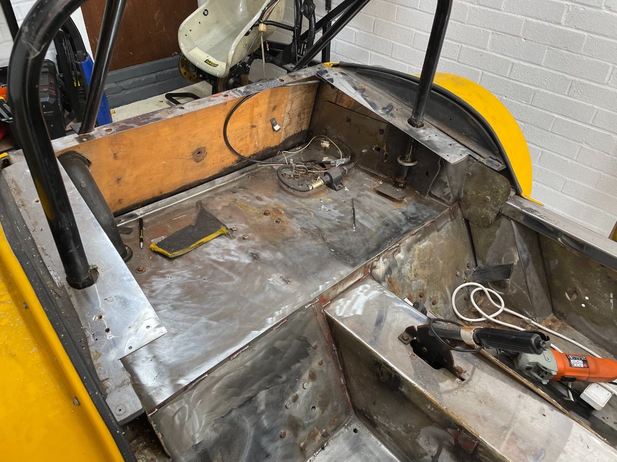

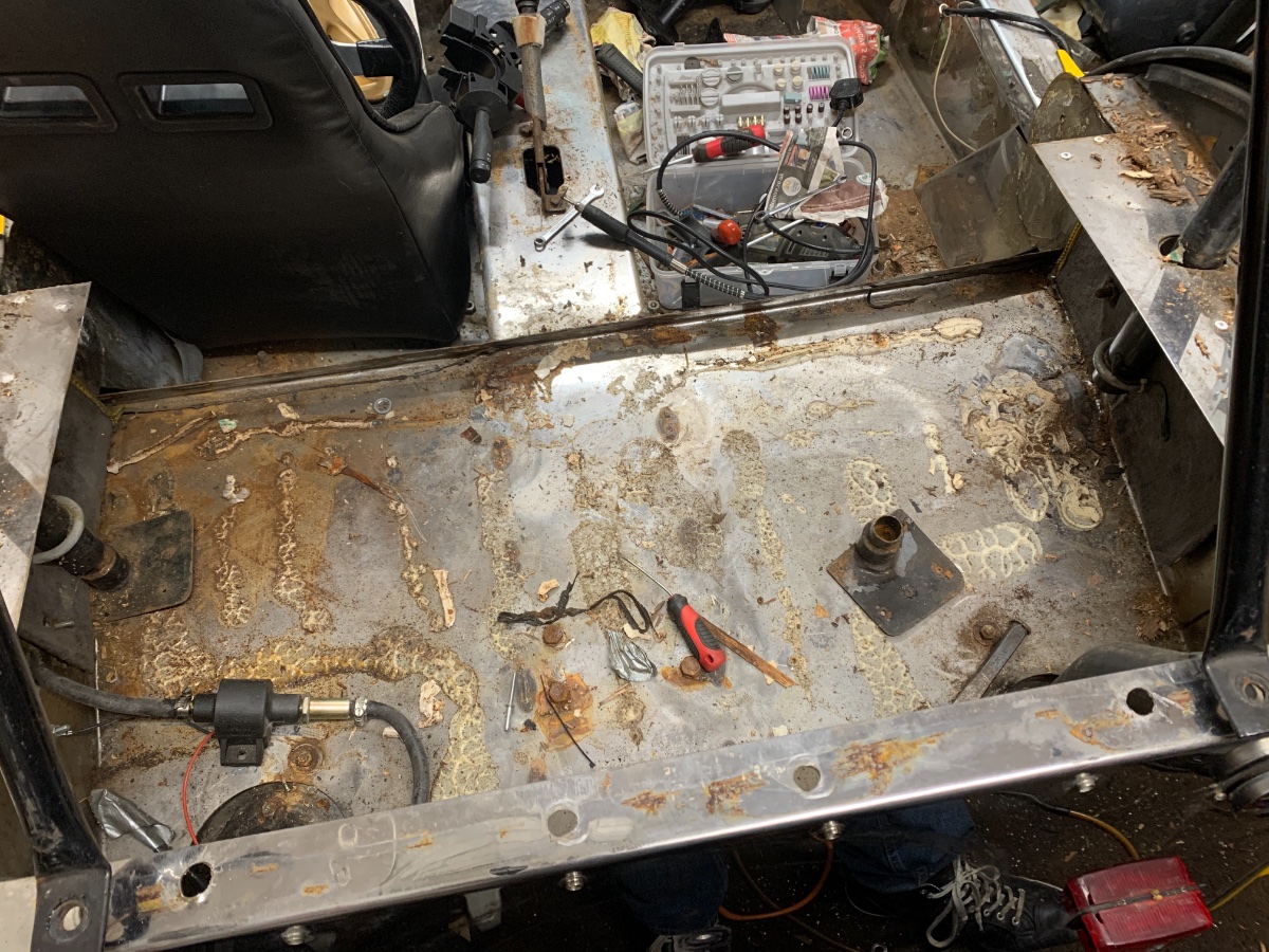

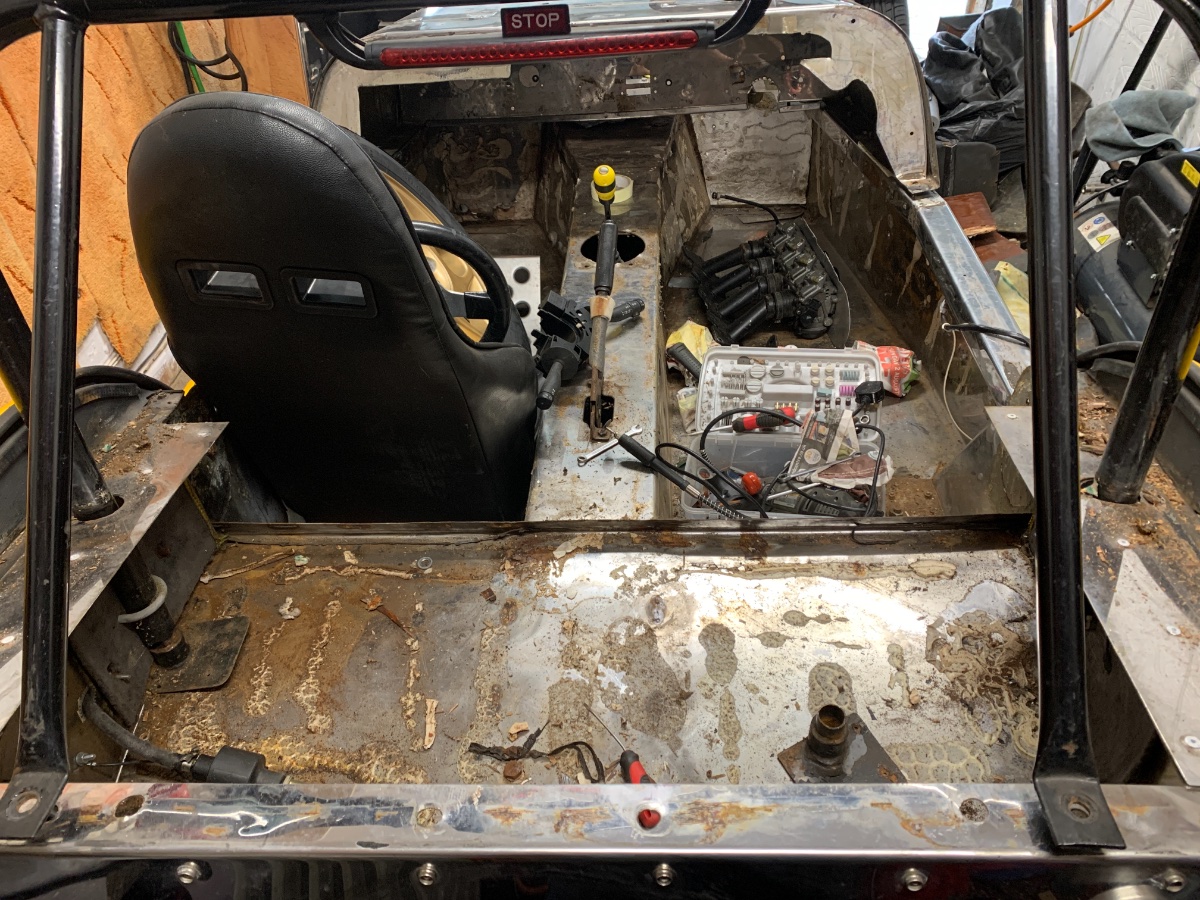

The next step was the removal of the passenger seat - which was surprisingly easy compared to drivers - probably because everything holding it has corroded away!
All the rear boot trim and plywood is now gone - I was especially shocked to find the rollbar essentially only held in with 6 self tapping screws!
Next job will be removing the copious amounts of dried paste/glue that has been applied to every panel!

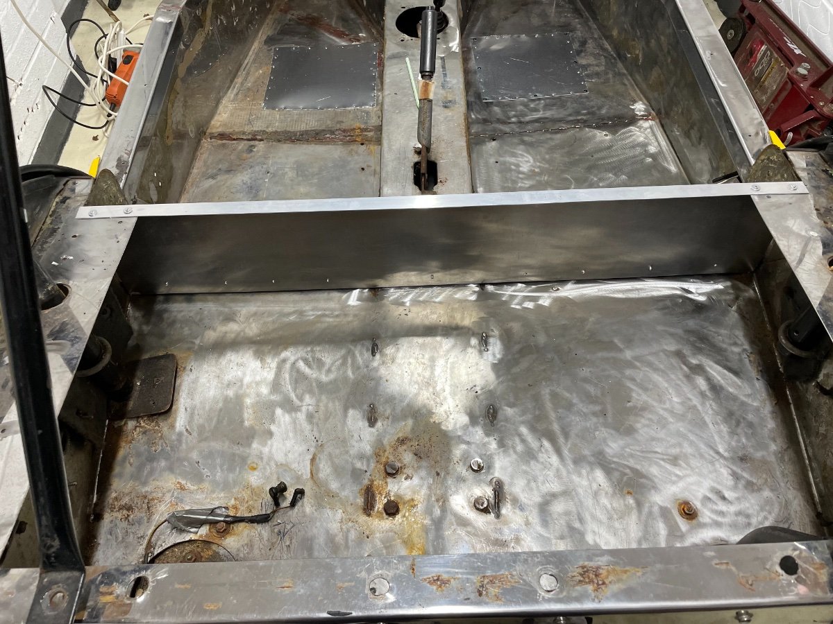

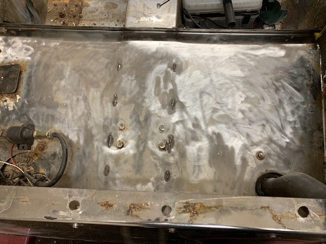

Over the last week I have managed a few more jobs.

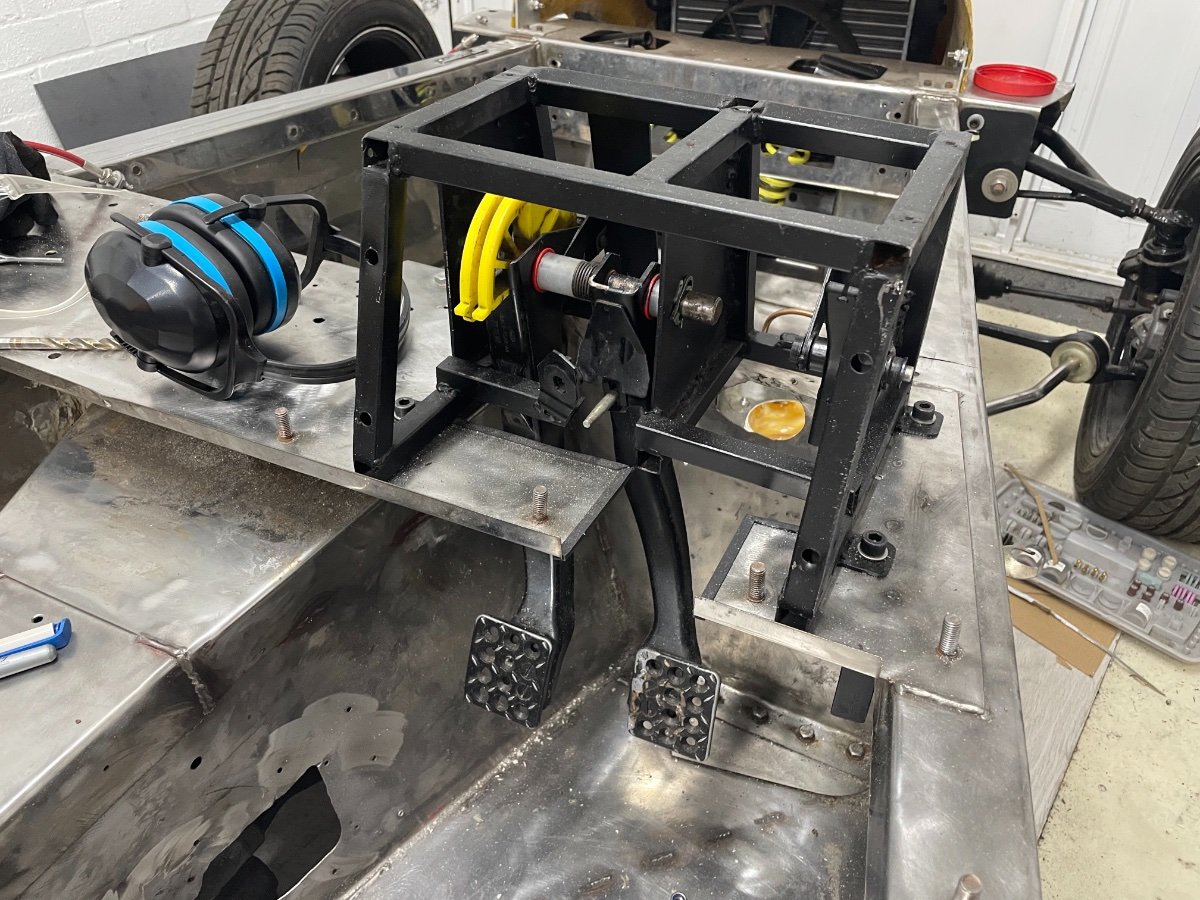

The over-knee bar (that the steering column mounts to) has been removed - getting a full width one fabricated to give a bit more protection/strength - will also give a better structure to mount dash/switches to.
I have also invested in a set of rotary wire brushes which have made mincemeat of the old glue on the internal surfaces...few more hours and it should be free of the old adhesive.

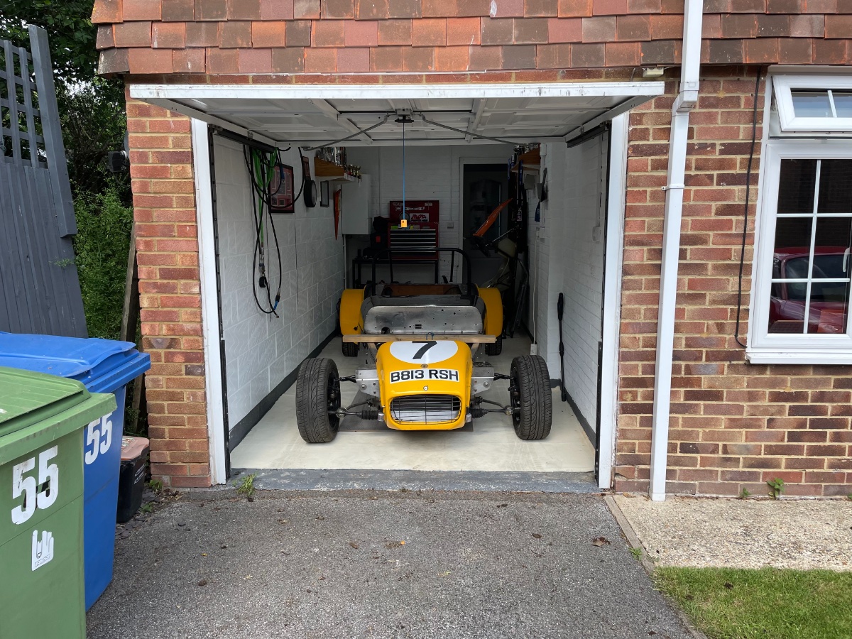

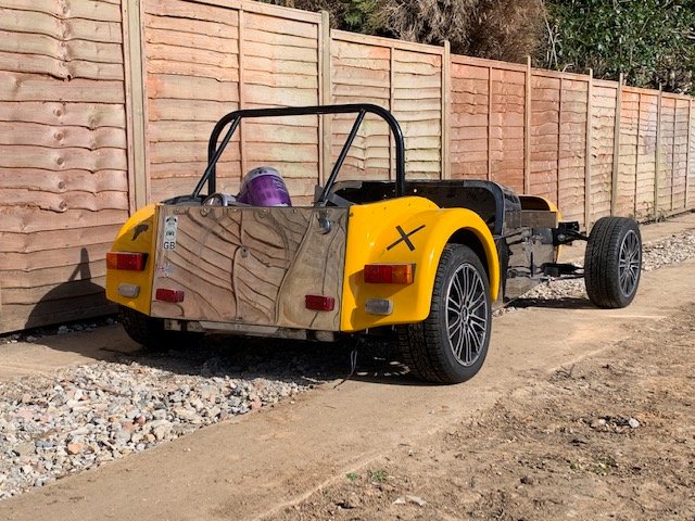

Finally, the car managed to see its first sunshine of my ownership as I had to move it to my parents for storage as I am moving next week!
  • 1 month later...
After 2 months in storage it’s back home - now to push on and make some progress!

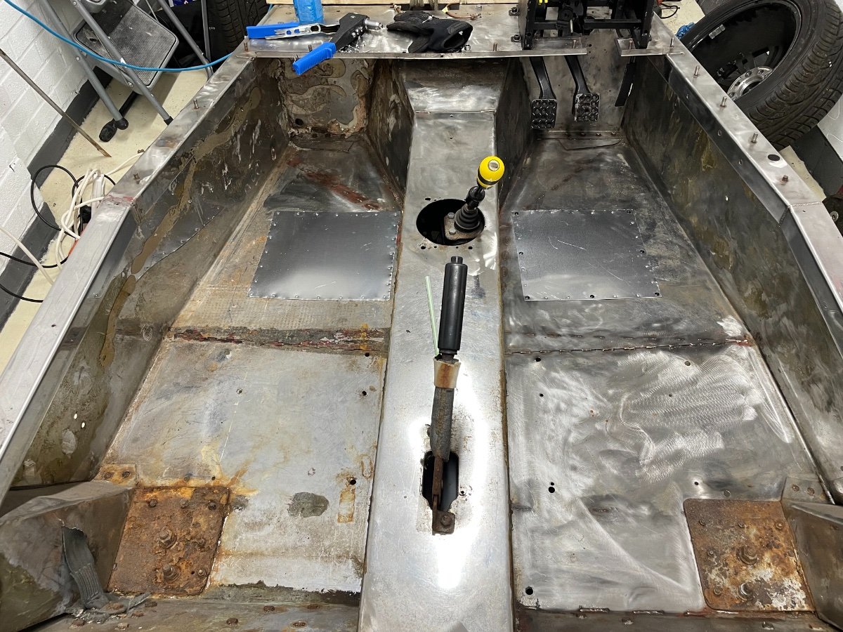

New aluminium rear cockpit panel made, floor patched, pedal box refurbed and engine hopefully a couple of weeks away.

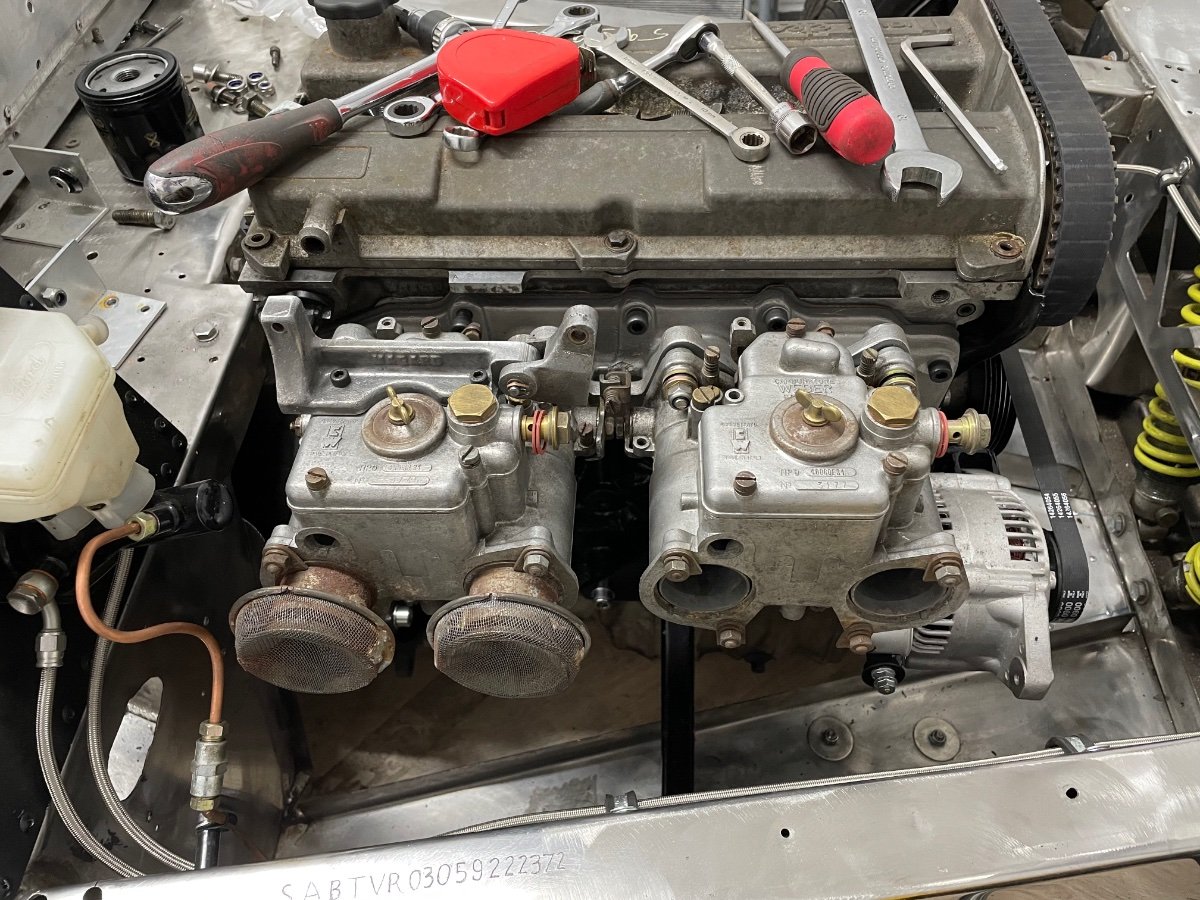

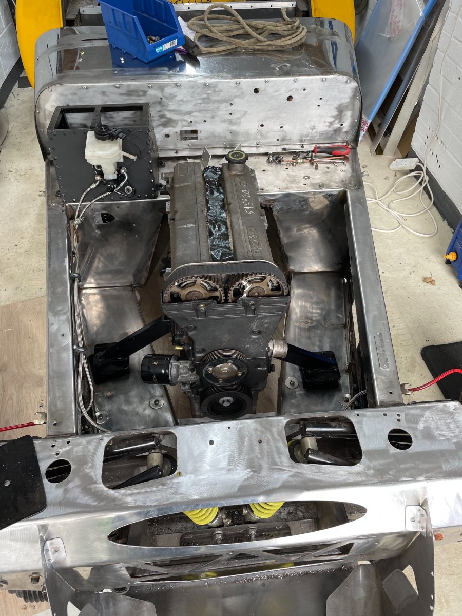

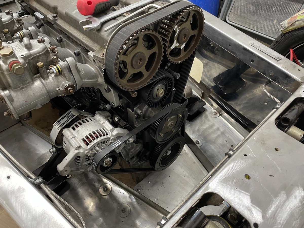

Finally a major breakthrough, before winter sets in I’ve received the engine back (a quick refresh 10 months ago has turned into a project that lurched from drama to drama - we’ve finally now made a good 1800 Zetec out of 3 donor engines!)
With a load of nuts and bolts on order the big rebuild can commence!
On 10/4/2020 at 7:12 PM, Chris Scott said:

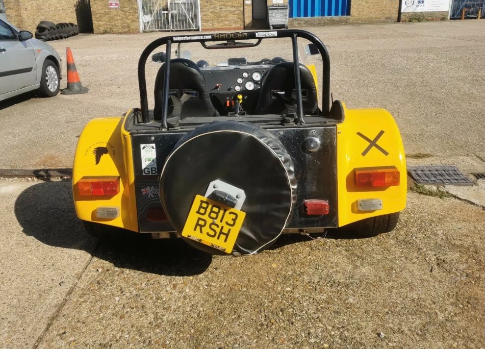

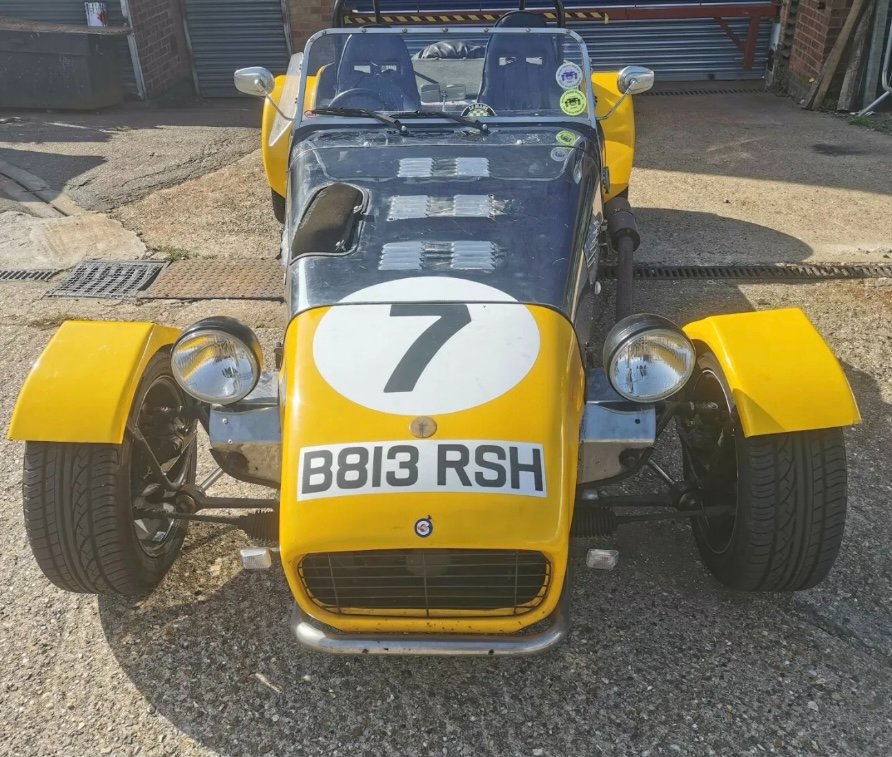

So after a hiatus of 18 years I've returned to kit car ownership, I had a GTM Rossa as my first ever car - but not knowing one end of a spanner from another it didn't end well.
I purchased this 3a off of ebay on Saturday. It looks good but in reality the MOT isn't worth the paper it's printed on! I wanted a project and have definitely got one.
I wondered if anyone on here knows/knew this car...I have a copy of an ebay sale from 2012 when it was immaculate. It is also covered in RHOC stickers from 2010 (it even went to Le Mans) - one of the previous owners was clearly an avid owners club owner.
Sadly the last 8 years haven't been kind...the car has been used, abused and somewhat neglected. I'm looking forward to getting her back to former glories.

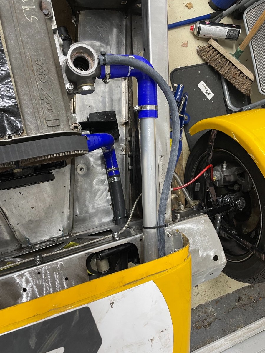

Bolting bits on feels so good!
A lot of the work I done wasn’t expensive really, just very time consuming to check and then double check everything again, the few bits I did need I managed to get cheap enough from eBay
Cooling system now plummed in
