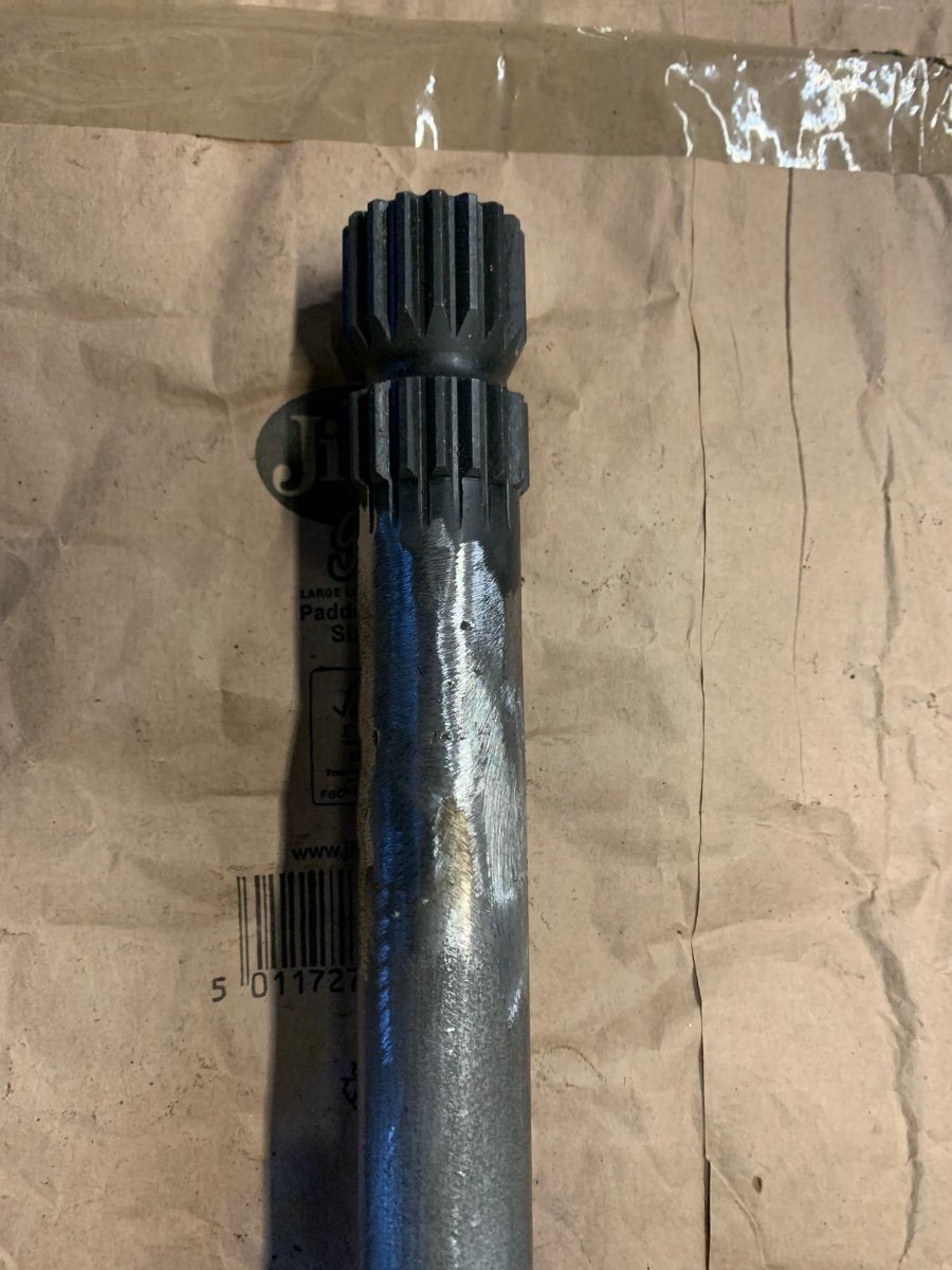

Column and mounting plate refurbished, new quick release wheel attached - a few more small
jobs and then it’s time to tackle electrics 😳

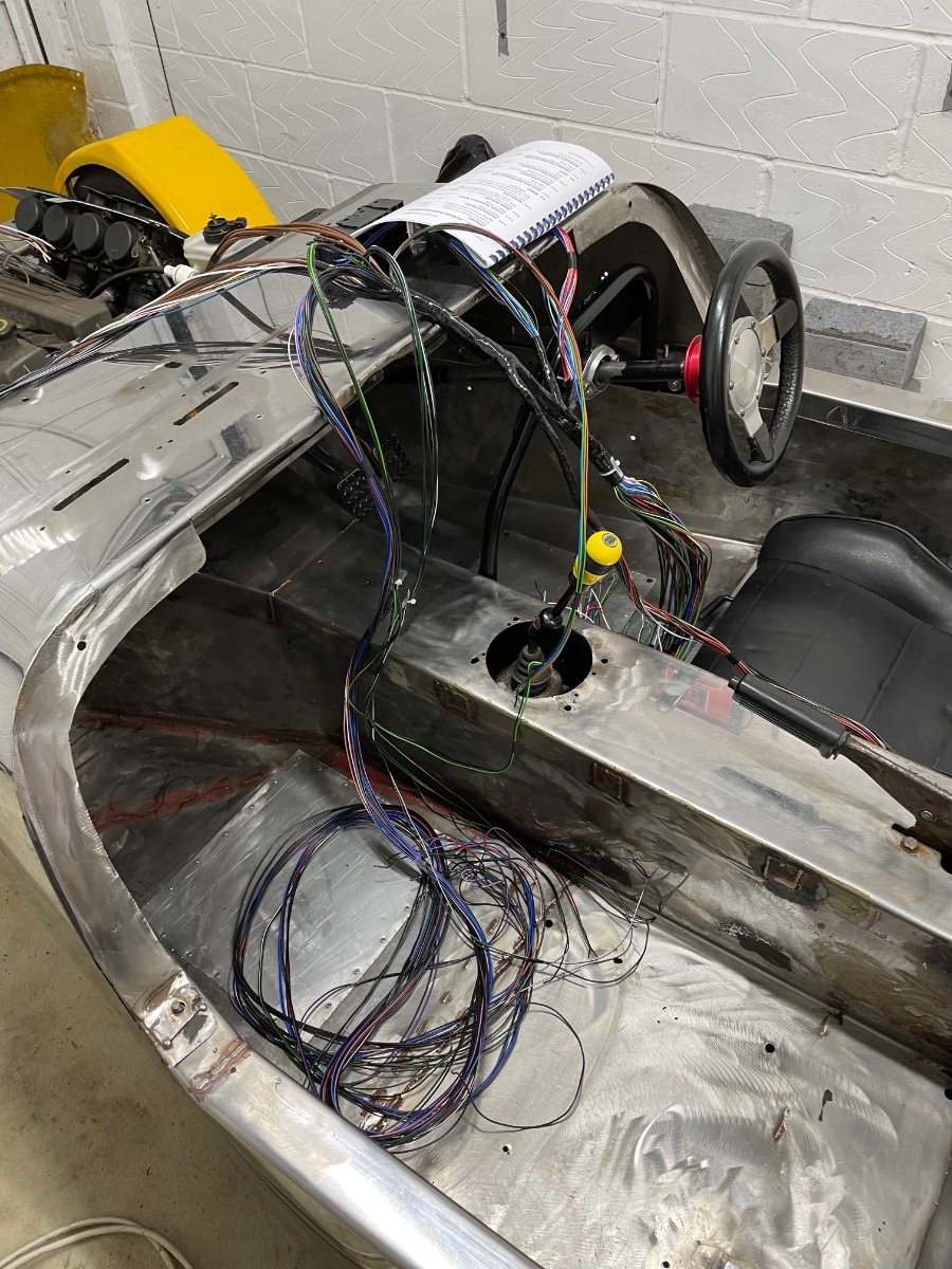

Another milestone reached - now time to start installing the loom….terrifying but a big step towards getting it running!
You’ve done well…. I’ve been following your rebuild for ages, wiring oh no I can’t get my head around it 😂👍
Thanks, yeah I’m worried!!! The look looks easy enough to install and connect - but I’ll have to make some kind of custom but for ecu etc and I’m just terrified 😂

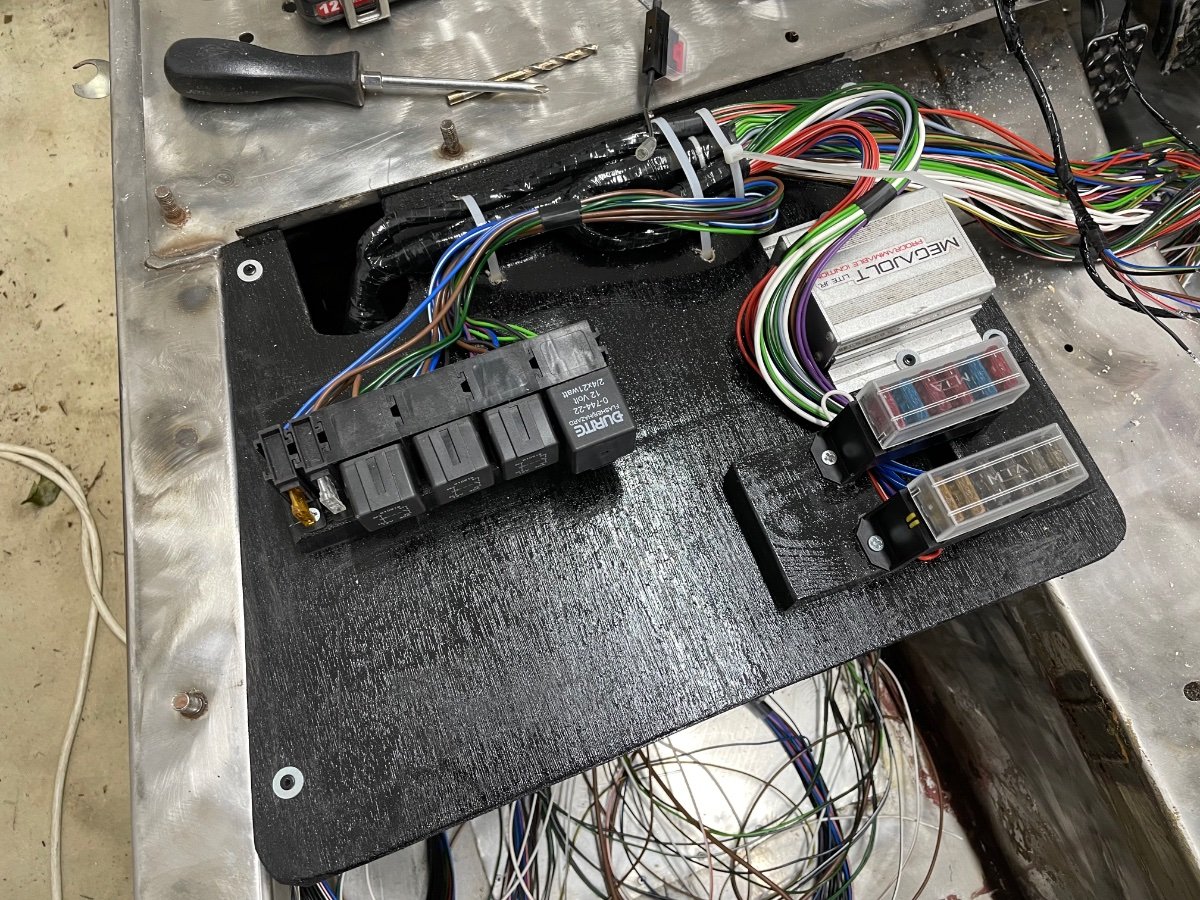

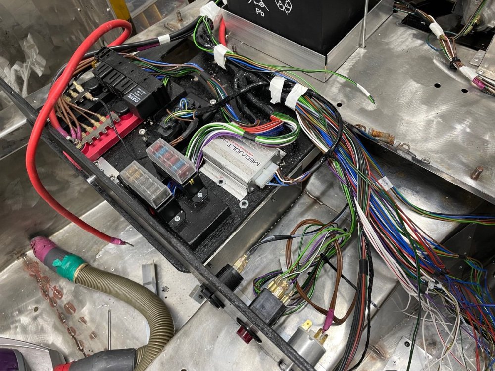

So after weeks of procrastinating (through fear of the task) I finally started on the electrics today.

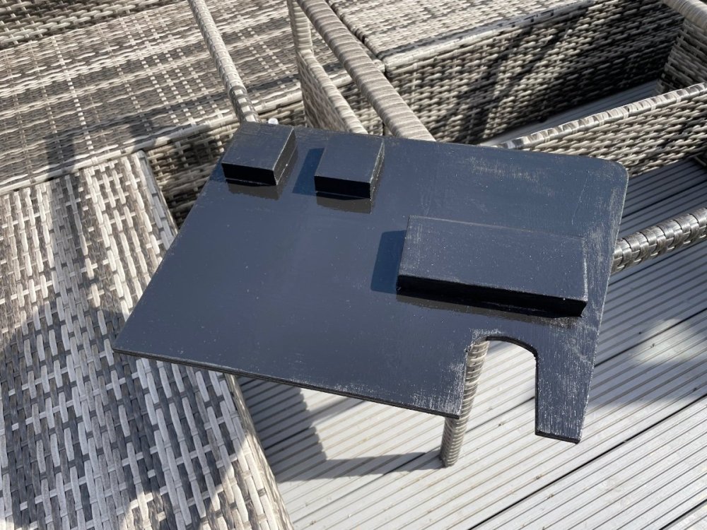

Having had several aborted attempts, I finally decided that the sensible path was to install the fuses and ecu first. I have built a small shelf to house the units (which sits above the passengers feet.
I would love to have made it from metal but don’t have the tools or materials - but painted plywood looks good and should do the job.
Looks nice and neat - personally, I would put some loose rubber tubing over those bare wires, as close as you can to the relays and fuse boards, just for some extra heat and vibration protection.
  • Thanks 1
Thanks both, I’ve got some proper fabric loom tape coming to neaten up and protect further - will look into some tubing as well.
It’s a brand new Autosparks loom, I’m no electrician so needed something that was plug and play(ish) - now I have a starting point I’m hoping it won’t be too bad to wire up!
A slight warning with that fabric loom tape - I used it and it is very good BUT almost too good. It's incredibly difficult to take off once on. If you use it, try not to put it near the wire ends where you might want to strip it back one day.

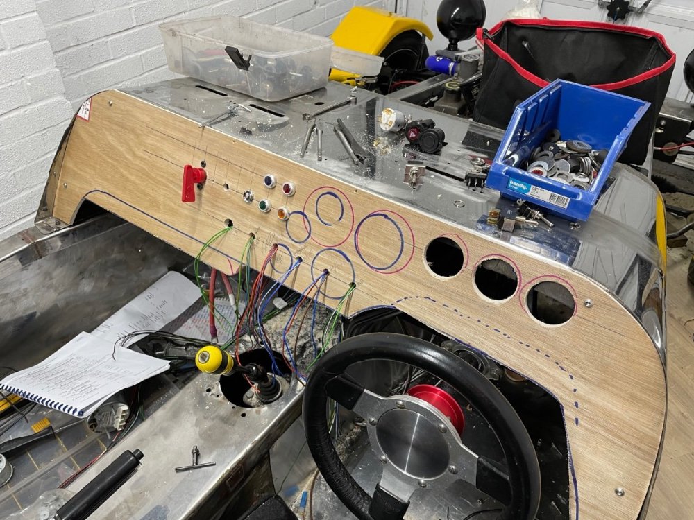

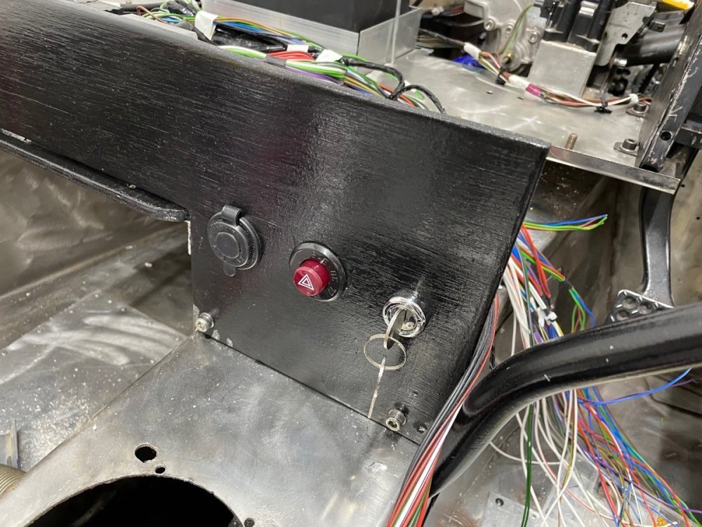

Progress on the loom is excellent, I’ve built a lower dash for the hazard switch, ignition barrel and 12v socket. I’ve also built a new main dash which is on its way to being wired in.
Initially I will paint the plywood black - then once the car proves it’s a runner I’ll cover in faux suede.
