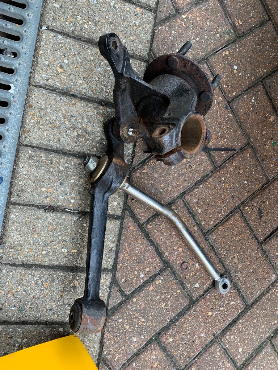

So...on closer inspection the ball joints in the track control arms are worn out...I have a few questions.
1) I assume these can’t be replaced and that it has to be a whole arm?
2) On Burtons the pattern arms say “not suitable for poly bushes” and idea why as I have some poly bushes coming.
Thanks in advance, Chris
I’ve solved the mystery - the pattern ones have the big bush moulded in rather than pressed in. They also seem to have been machined and then sleeved to a different size so the poly ones don’t fit even if you remove the moulded bush (don’t ask me how I’ve found this out...but hasten to say I have a knackered brand new arm 🙄😢😂)
