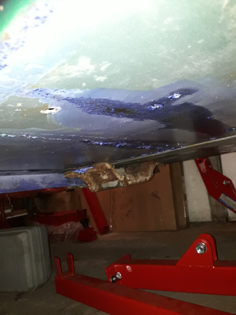

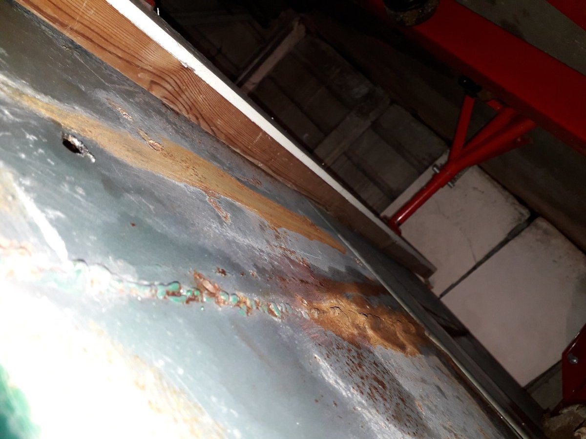

Just been trying to treat the rust. Using a product called Corroseal that also acts as a primer. Might need a few coats though.

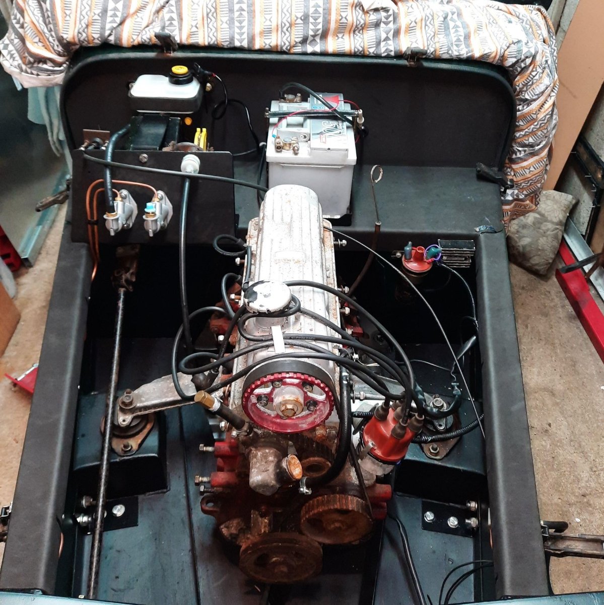

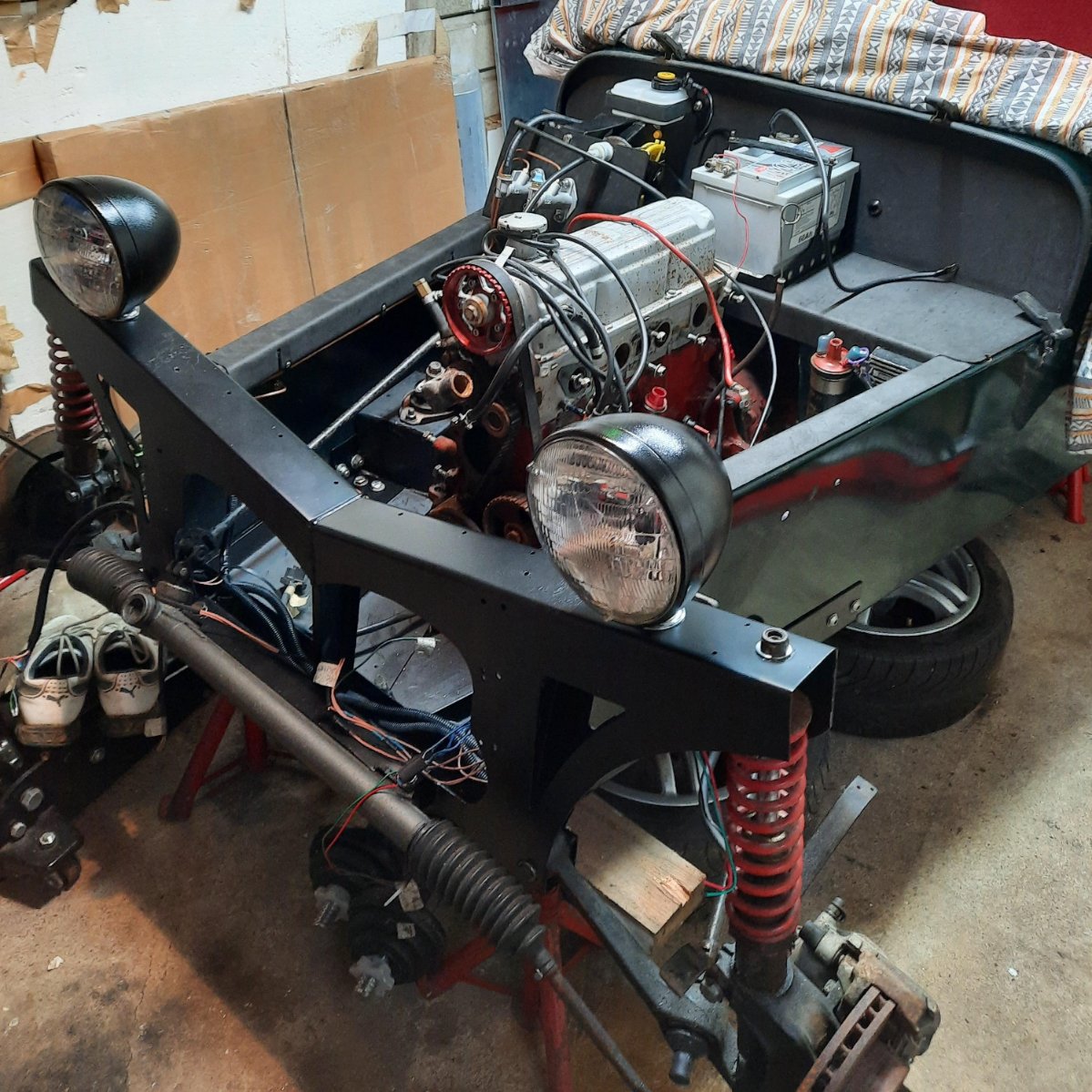

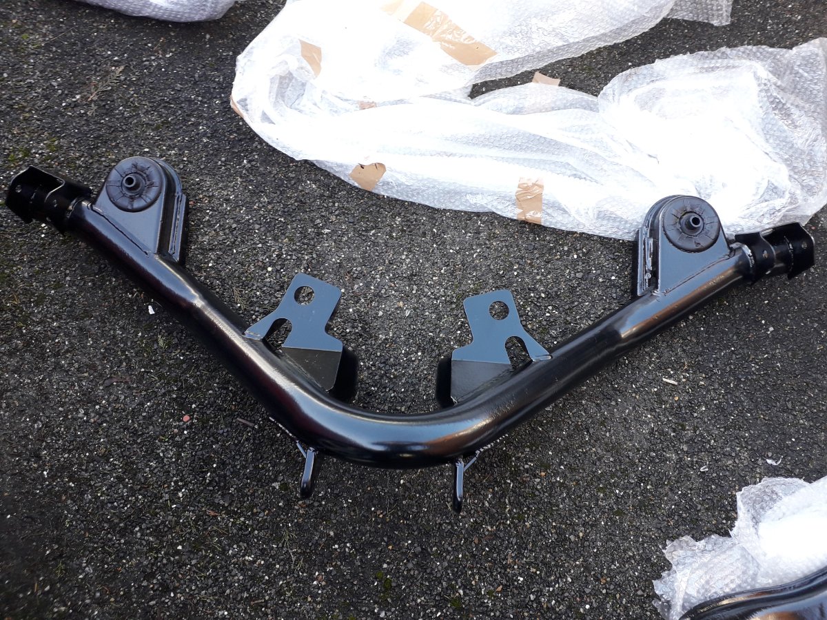

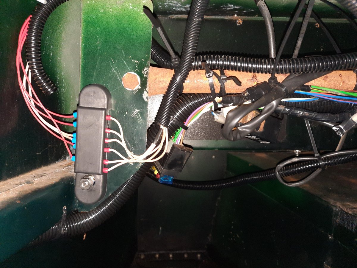

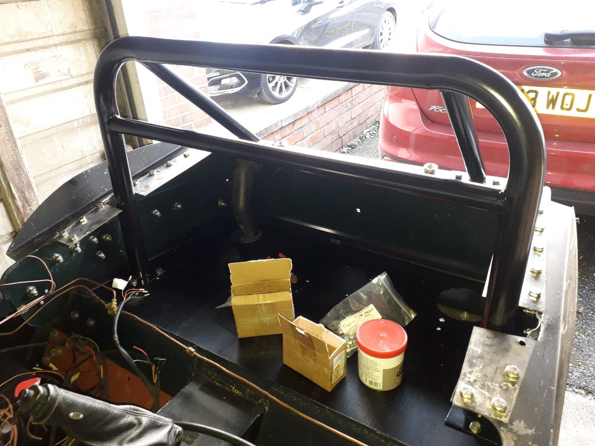

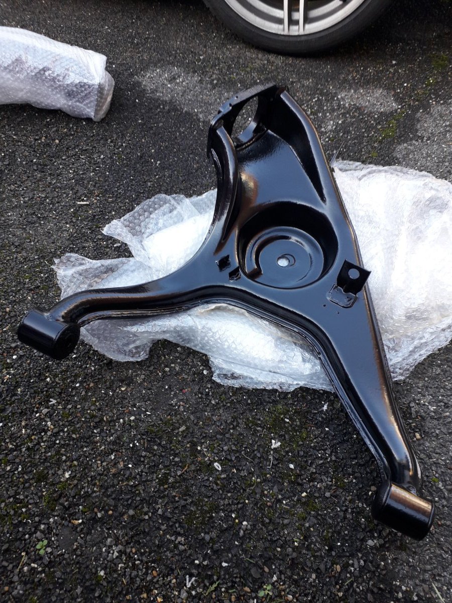

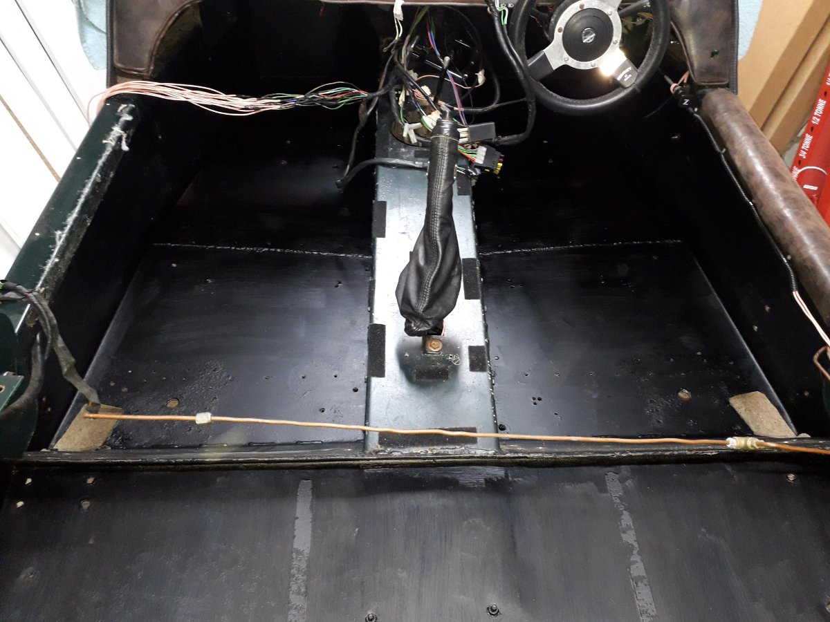

Bit of an update and list of jobs completed over the last month or so...
 - Treated all rust spots and coated with underseal.
 - Replaced every nut and bolt with stainless and nylocks.
 - Re-routed all wiring using correct trunking & moved all earth points to central earth bar connection.

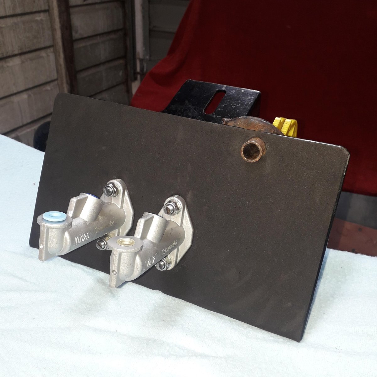

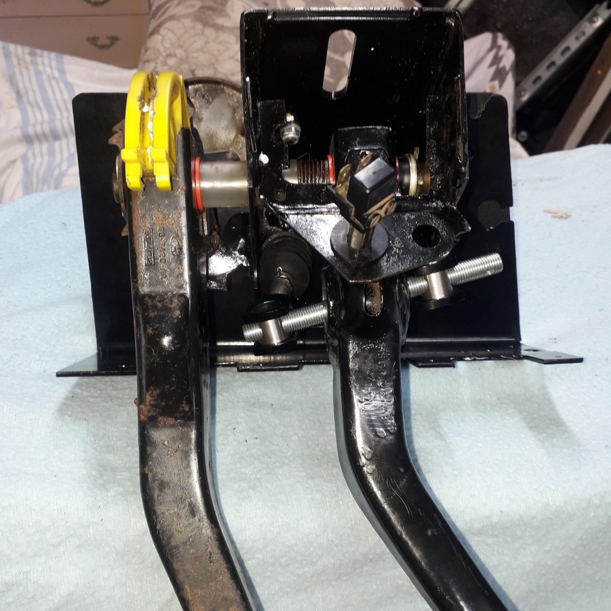

 - Removed pedal box assy and changed servo & master cylinder to dual system with balance bar and no diaphragm. Made new brake pipes for front end          including new T-piece to split the sides.
 - Painted front end suspension arms and installed new lights.

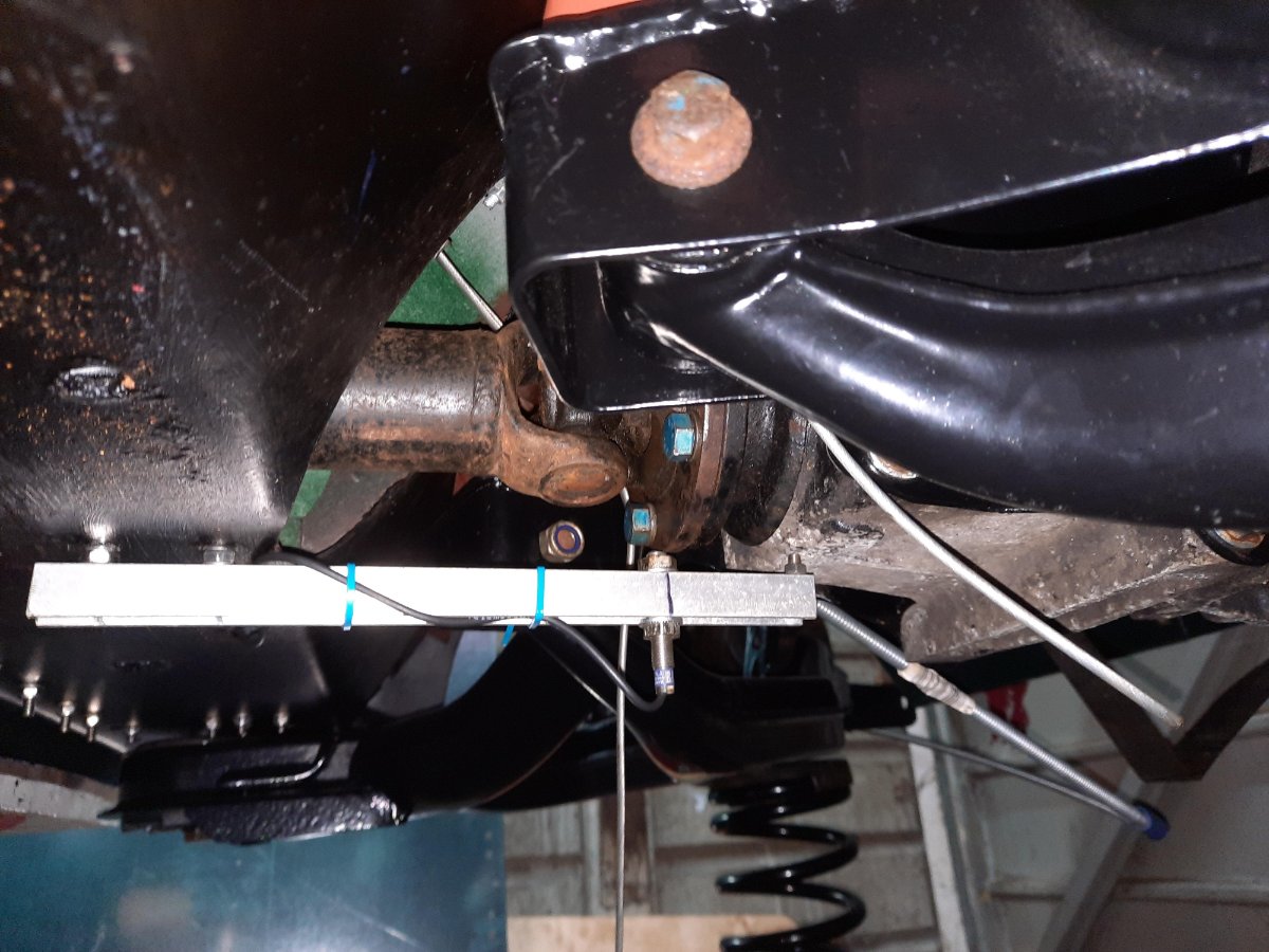

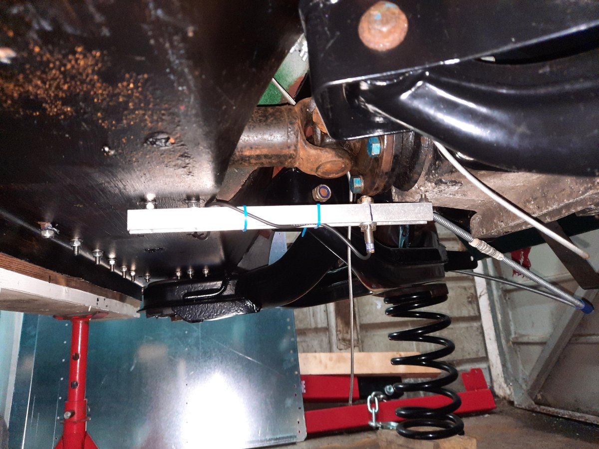

 - Made new speedo sensor bracket as old one was inadequate.
Please let me know if you can spot any potential compliance issues or advice on how to do things differently.
Next jobs are to bleed the brakes and start thinking about the new dash and re-installing seats.

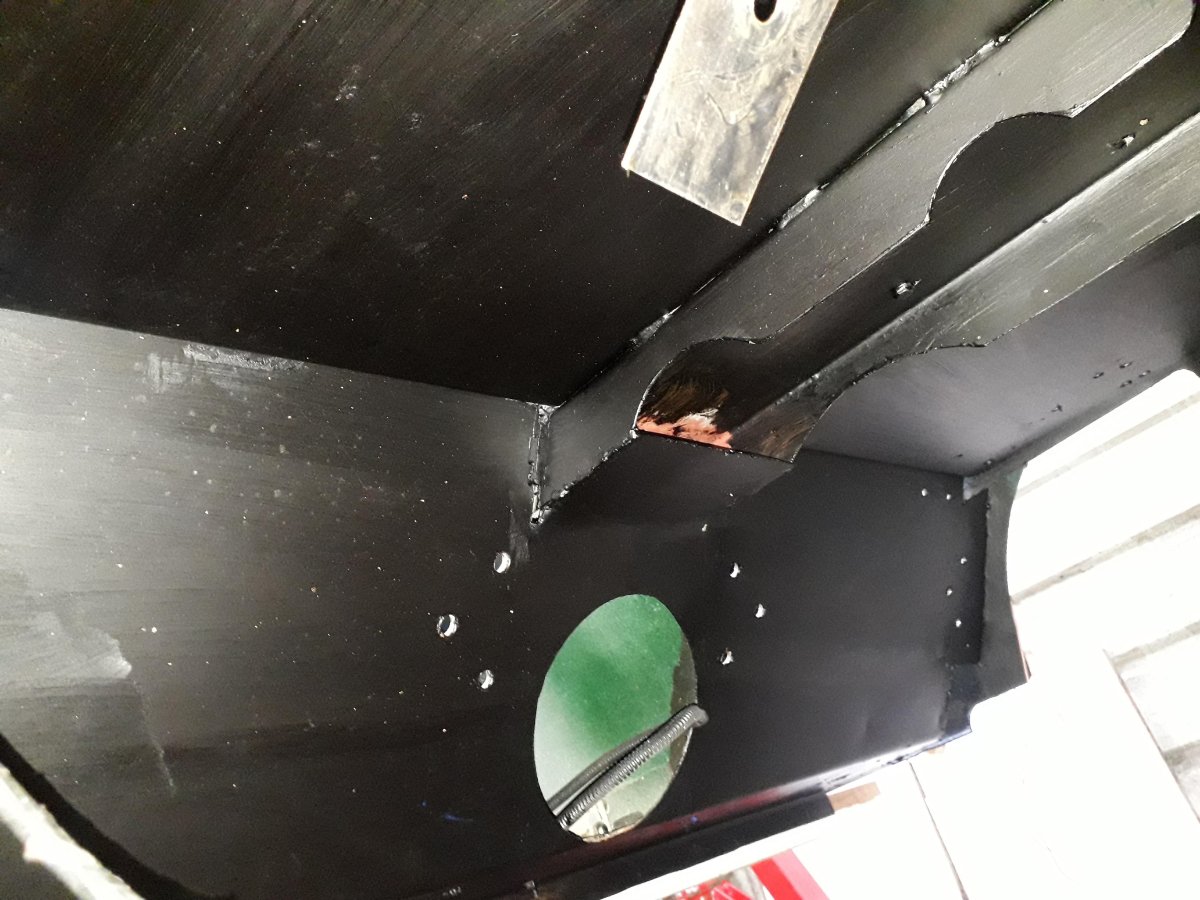

Good point, hadn't really considered that. 🤦‍♂️
There's a fold in the monocoque just in front of this section, picture below shows it a bit better. Also the engine sump sits quite a bit lower than this so if anything is going to take a thump it's most likely going to be that.
I'll have another look at this once I've dropped the rear back onto the wheels just to make sure though, thanks.
