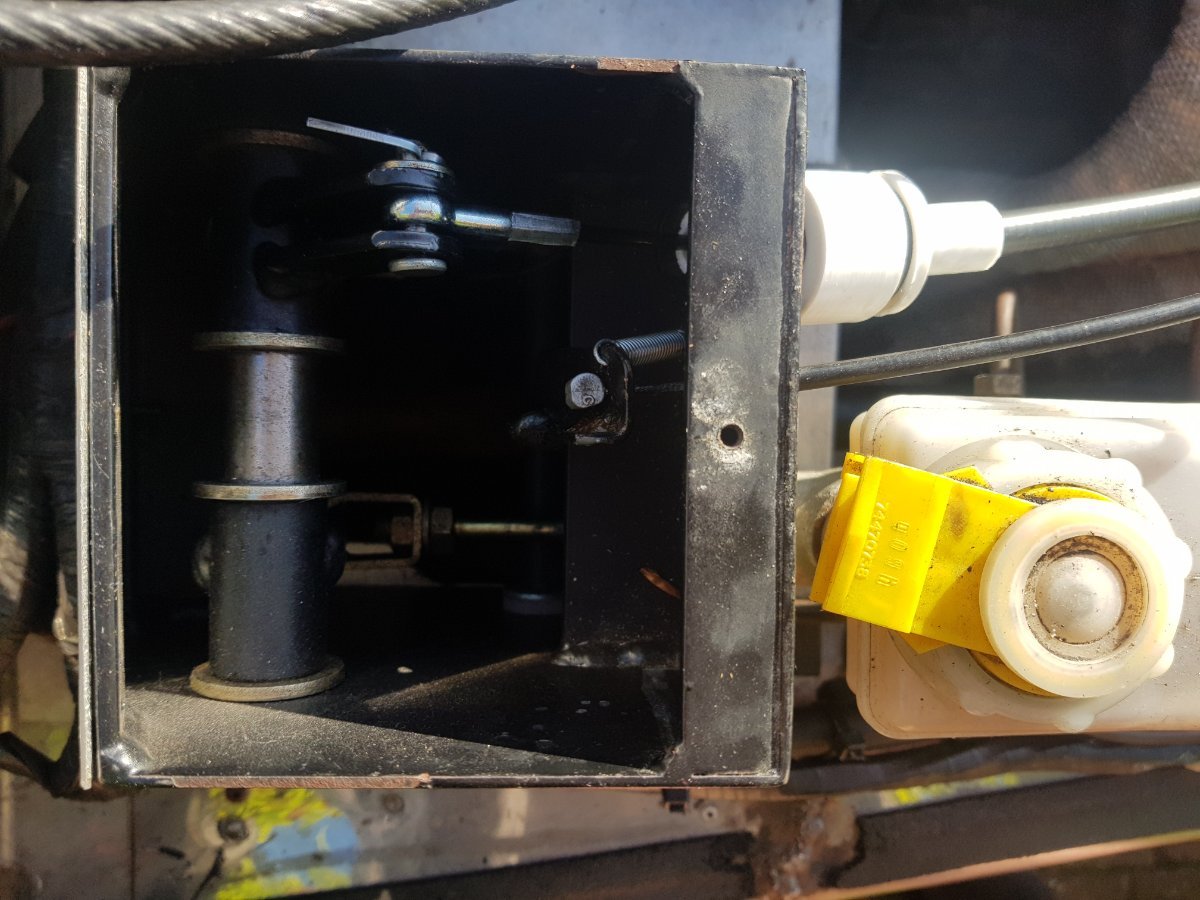

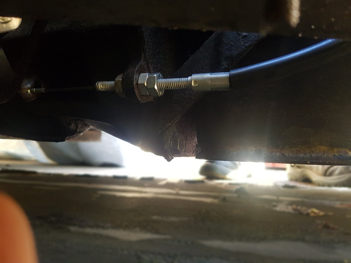

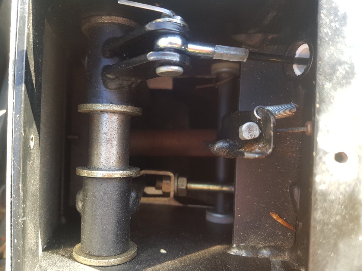

Ive attched some photos of the top of the pedal bos and the connection to clutch plate if these are anyhelp.

Definitely not a Superspec.  The Superspec has a tubed stainless steel chassis like all the 2B models.   Yours sounds like it has a monocoque chassis which was used in earlier models like the S3A, S7, Exmo…
and I agree you probably need to adjust the cable to bring the bite point up.  I assume at the moment the bite point is right at the bottom of the clutch pedal travel so that when you push the pedal to the floor it isn’t fully releasing the clutch.  Use the 2 nuts shown in your picture to tighten the cable a bit and reduce the slack in the cable.
As Alan says ...........
It looks like you've got a pinto engine and type9 gearbox, but not the sierra pedalbox.  Tighten the outer of the cable up a bit until there is just a tiny bit of slack on the inner and you should be back in business.
