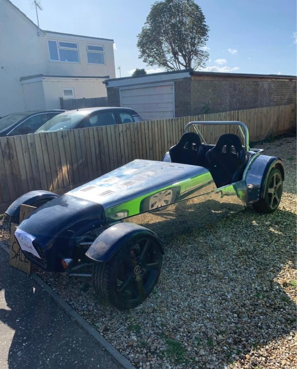

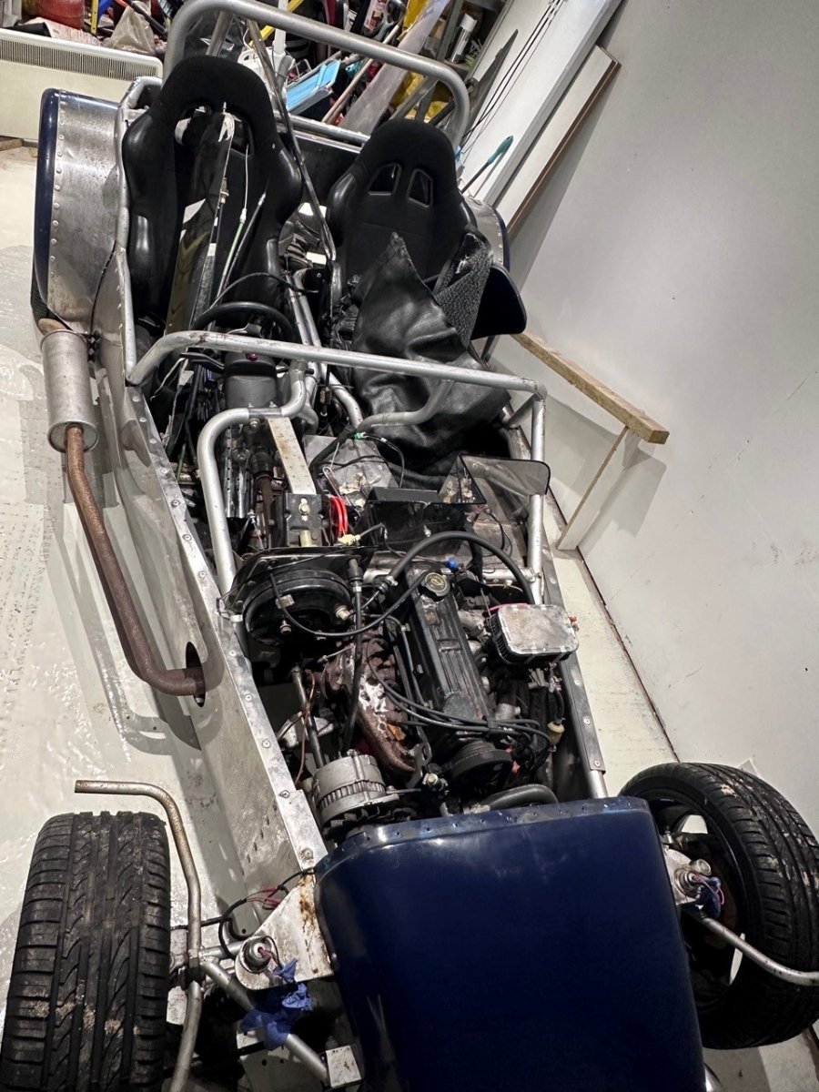

So Its finally here! I have attached some pictures, if anyone recognises it, id be most intrigued about its past!

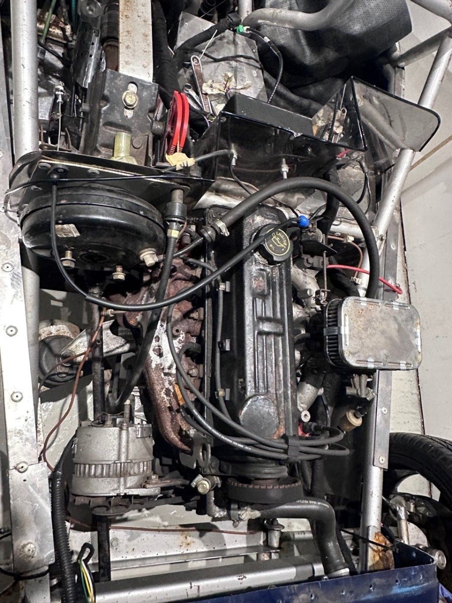

1) it doesn't start. admittedly I haven't tried, it does turn quite freely, I have no idea how long since its run, and the electrics aren't really an art form, so if there's any advice on how to go about this for the first time I would appreciate it :)
2) its missing a master cylinder, does anyone know the best source for one including the reservoir, all the ones I see seem to not have them

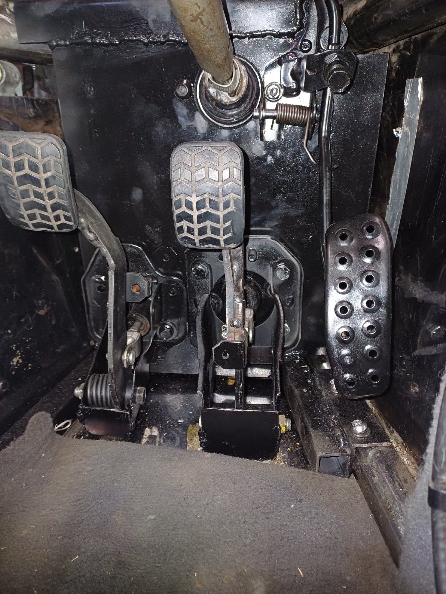

3) pedal box/steering column. the pedal box would make the car undrivable, can it be moved further in the footwell it seems is what's needed? also the brake pedal hits the steering column which wobbles about and I'm guessing it shouldn't do that!
4) the bonnet seems a lot longer than others I have seen in pictures, as they have a fixed scuttle that a screen is fixed to, not sure how I would go about this?
5) finally can anyone identify the types of 2B it is and what grainy set of videos I should be watching if anybody has those?

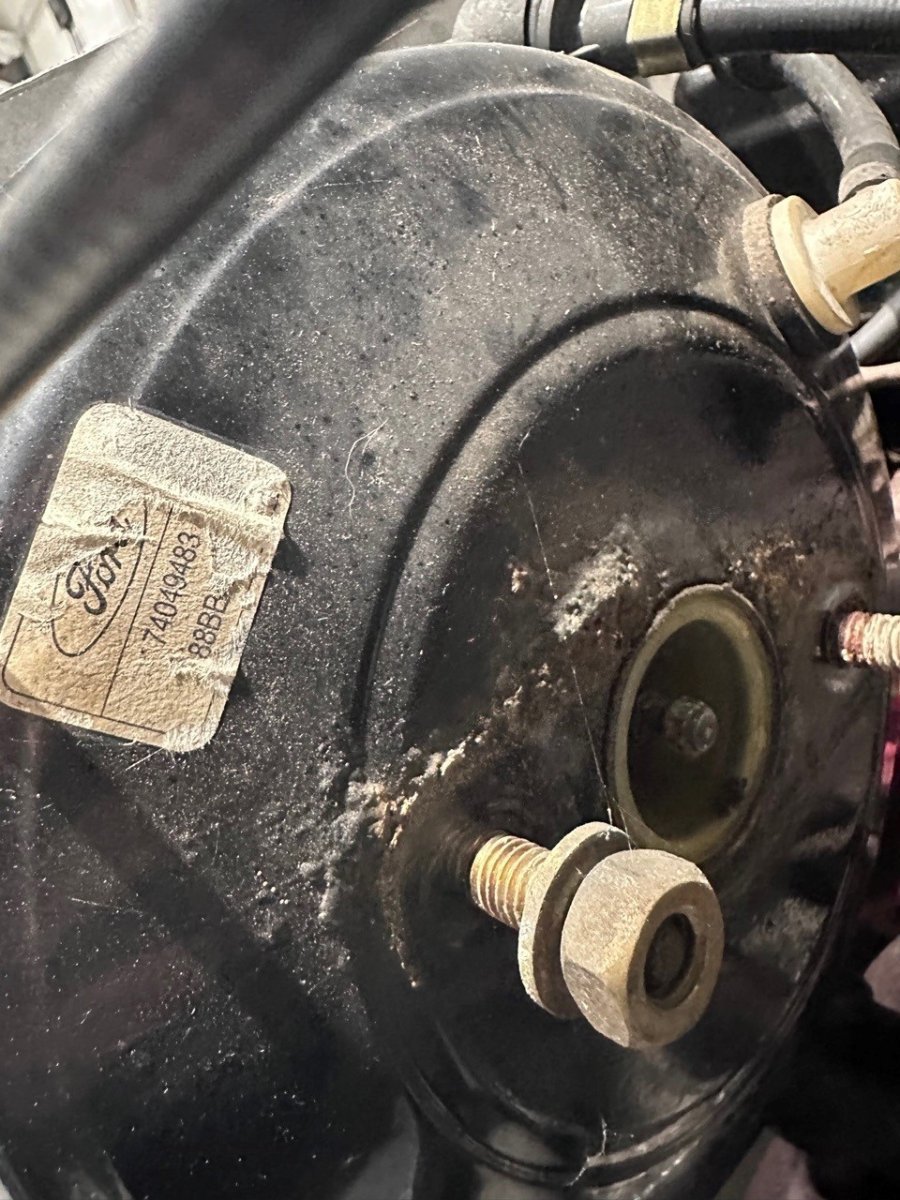

There is nothing special about your Ford Pinto engine, so just Google for advice on starting an engine for the first time after having been silent for a while, it's simple stuff like making sure the oil is clean and up to level, water in the cooling system, clean fuel in the tank and pipework to the carb etc..... take the plugs out and turn it over on the starter first see if oil pressure is enough to turn off the warning light.. check you even see a spark at the plugs, check that the timing belt is okay. As for the missing master cylinder, your Sierra servo doesn't look too good, rather than trying to get a Sierra master cylinder, you might consider ditching the servo and fitting a Ford KA master cylinder. Members have done this. Just use this sites search facility and search for "ford KA" (in quotes) and you will see the posts relating to this. As for identifying which 2B you have check out the page we have on identification at https://nw.rhocar.org/htm/identification.htm . The 2B build video is on Youtube at https://www.youtube.com/watch?v=DNA1Zs8jY_I

Have gone floor mounted clutch and brake with the upgrade to mx5 engine and box.
